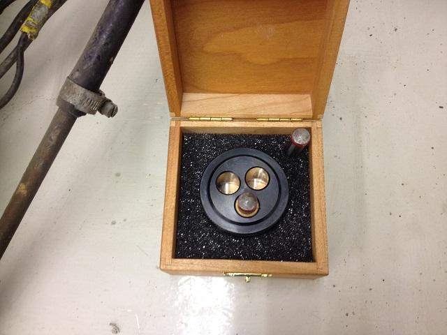

I bought this rather nicely boxed set at a Model Engineering exhibition years ago and it has served me well over the years. You centre it optically, then holding the base still rotate the upper bit to one of the other detentes holding the punch.
