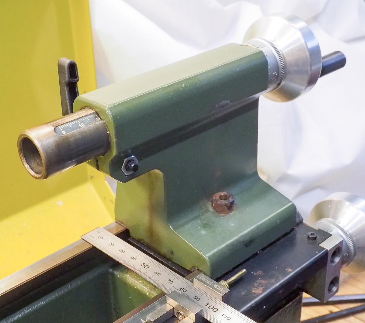

I've been running my PD 400 for several years now, generally very happy with it.  The only ointment on the fly for me is the tailstock.  I mainly turn aluminium, brass, and acetal for toy boats, and sometimes small stainless.  The tailstock simply won't carry a 10 mm drill bit into aluminium without wobble.  I think the rest of the lathe is up for this, so am looking to source a better tailstock.  Does anyone know where I might look, please?  Many thanks!

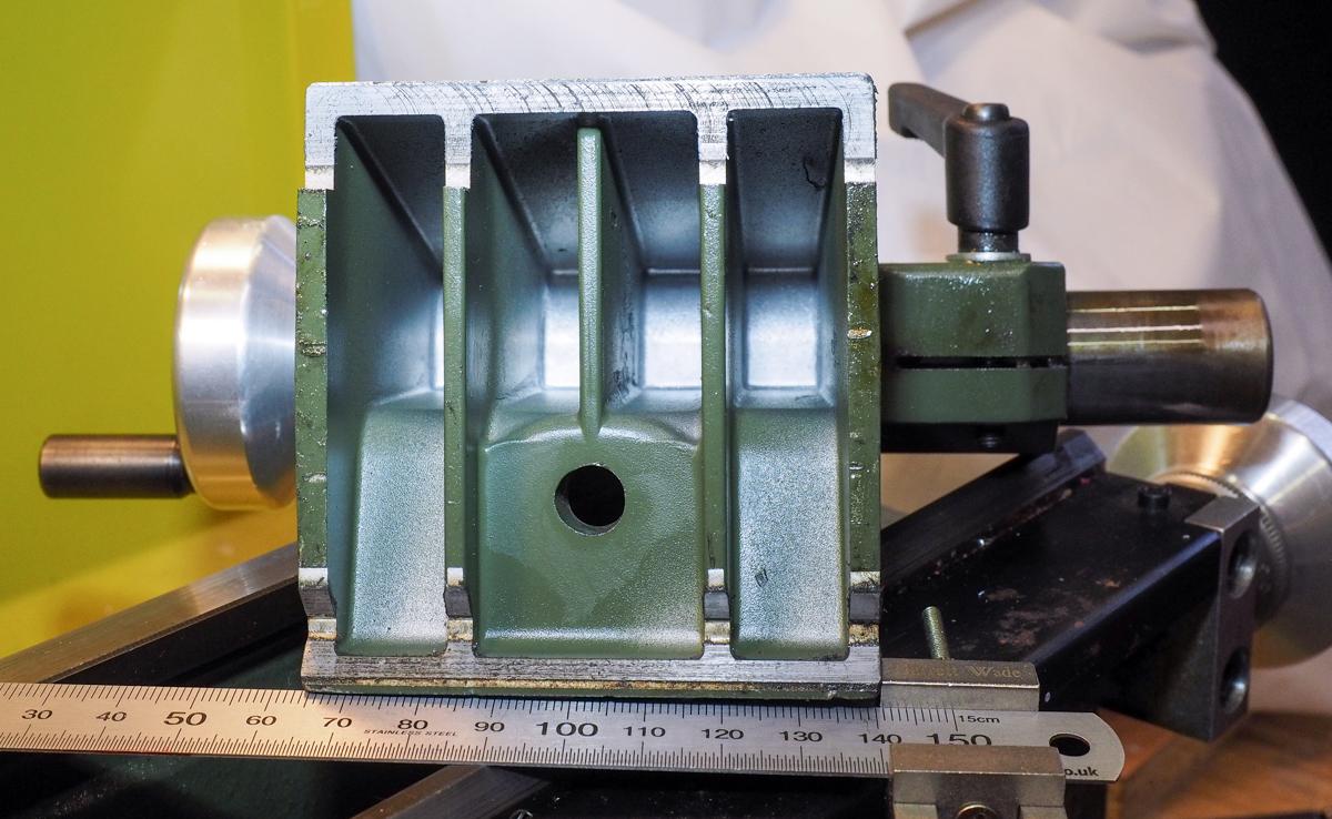

Could you bore and sleeve the tailstock in an attempt to get it true to the lathe bore.   Otherwise you are probably looking at fabricating something.   Again not the end of the world as your head will be doing the boring so it should all be inline, at least to the error in the headstock   :lol:

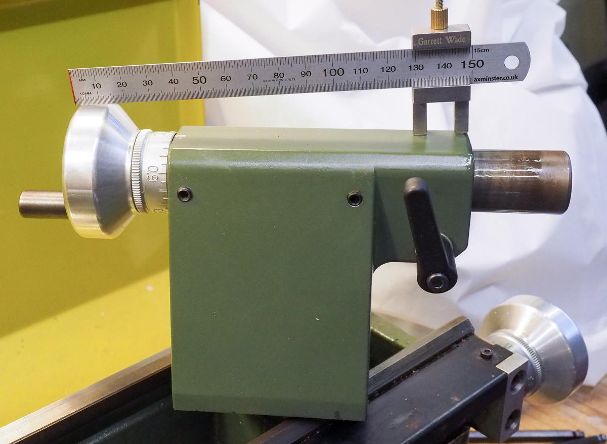

Your friends might have been thinking more of the Proxxon PD 230/240, which has similarities to the Toyo.  The PD400 is something of a different animal, with a headstock, gearing, and cross slide that is competitive with, say, the Myford ML7 which my friend has.  But the tailstock of the PD400 is where Proxxon cut their costs...  Photos attached, showing that it is a simple casting.  It clamps to the bed well enough, but has no other adjustments to align with the headstock...  I would like to hear if anyone knows of an after-market replacement!  I understand that I can ream it, sleeve it, or make my own (!), but I really just want to hear about the possibilities of replacing it.  Thanks!

Lester, you just aren't going to find a drop in replacement.   The odds are these things are machined with the headstock on the same setting.   A replacement from Proxxon won't be inline if they supplied them, and that probably accounts for them not being a replacement item.  The centre height of your machine is going to be unique.  Fabricating your own tailstock and machining it using your headstock is the only way to guarantee it will line up correctly.  You do have some adjustment screws on the side, however you really need a between centres bar (accurately machined) that you can put between centres on your machine and clock it at each end and along its length.

That tailstock looks identical to the Toyo tailstock. Except toyo/manix use plastic handles which are not nice. I bet the toyo tailstock will fit your lathe.  The toyo is now made by manix in Korea but it doesn't help you as spares are almost impossible to source. I just bought a boxford lathe because my Toyo  small lathe  struggles too much with bigger drilling, larger diameter turning.
