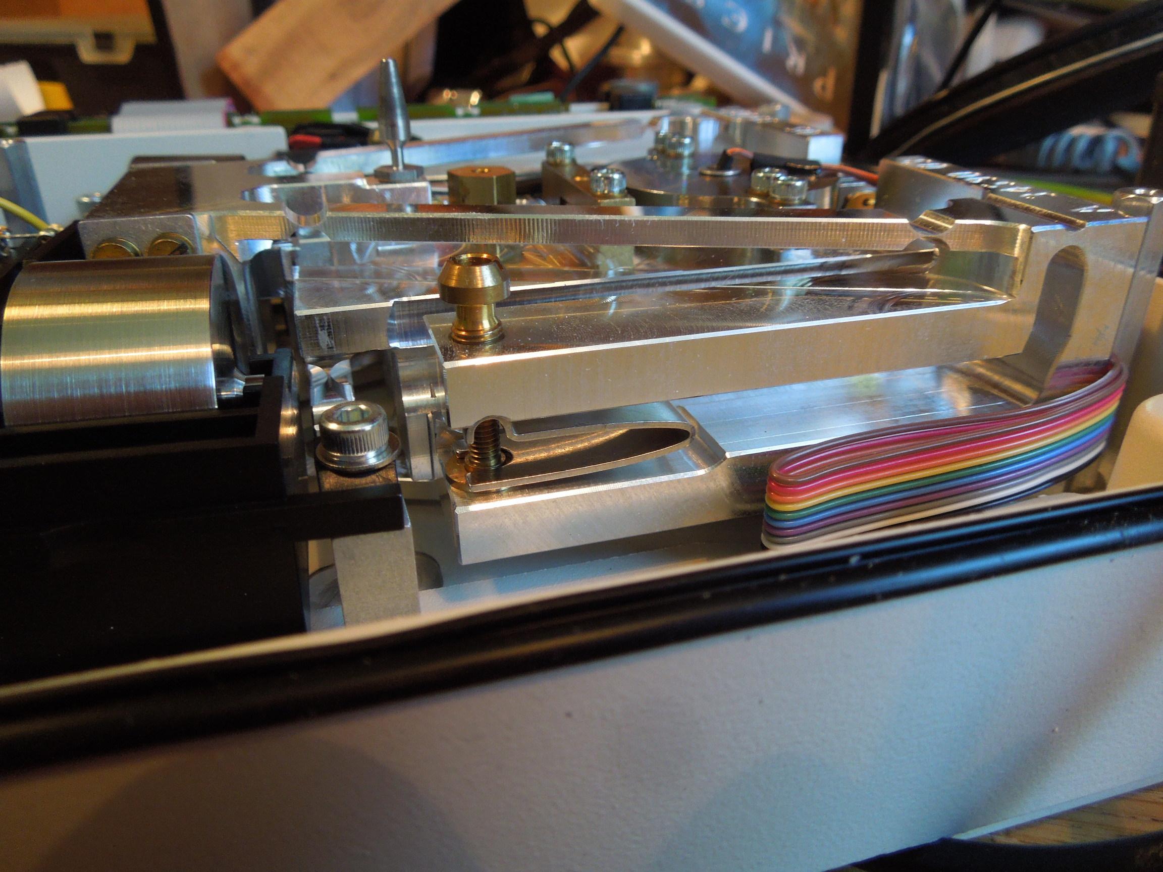

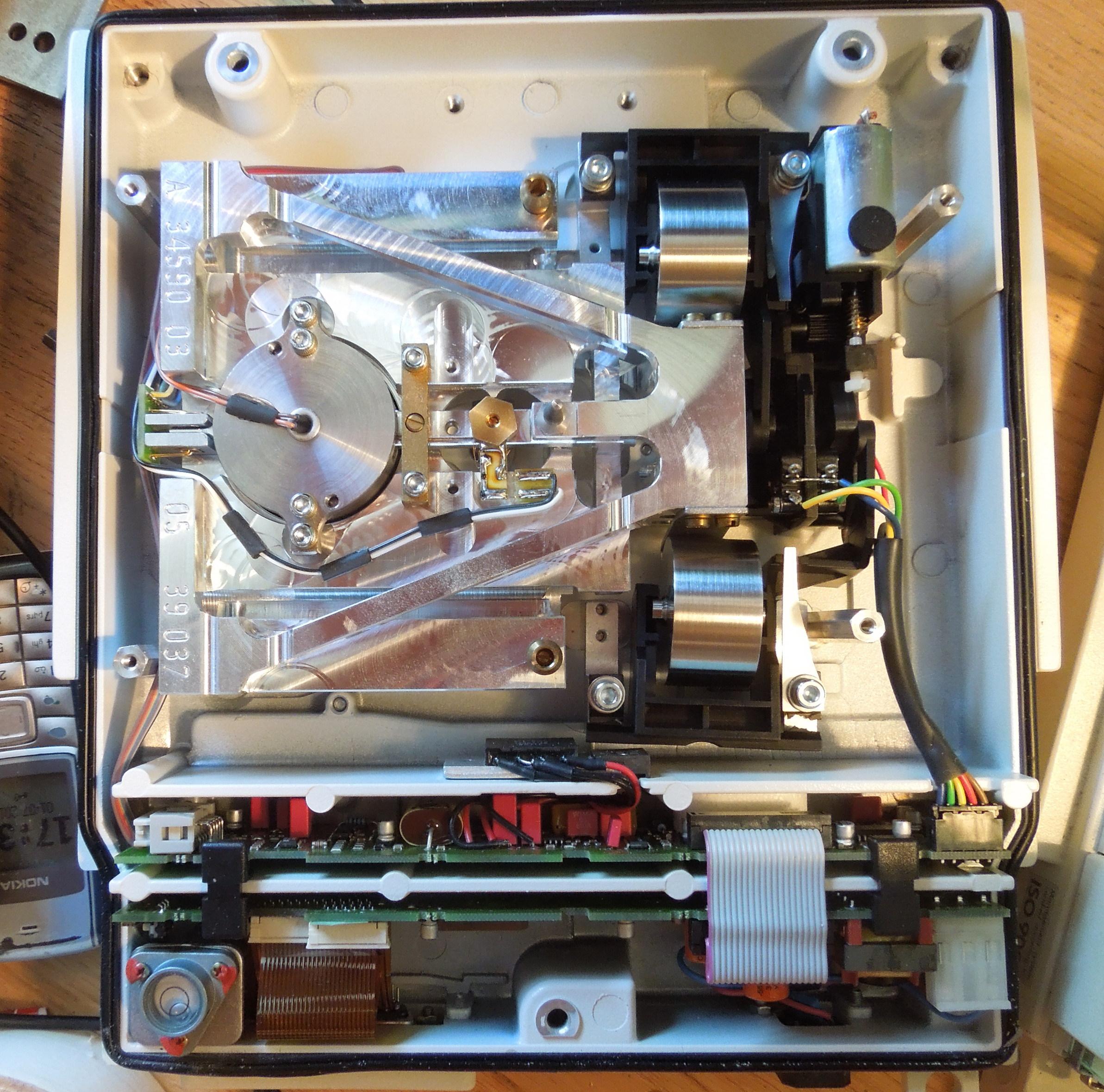

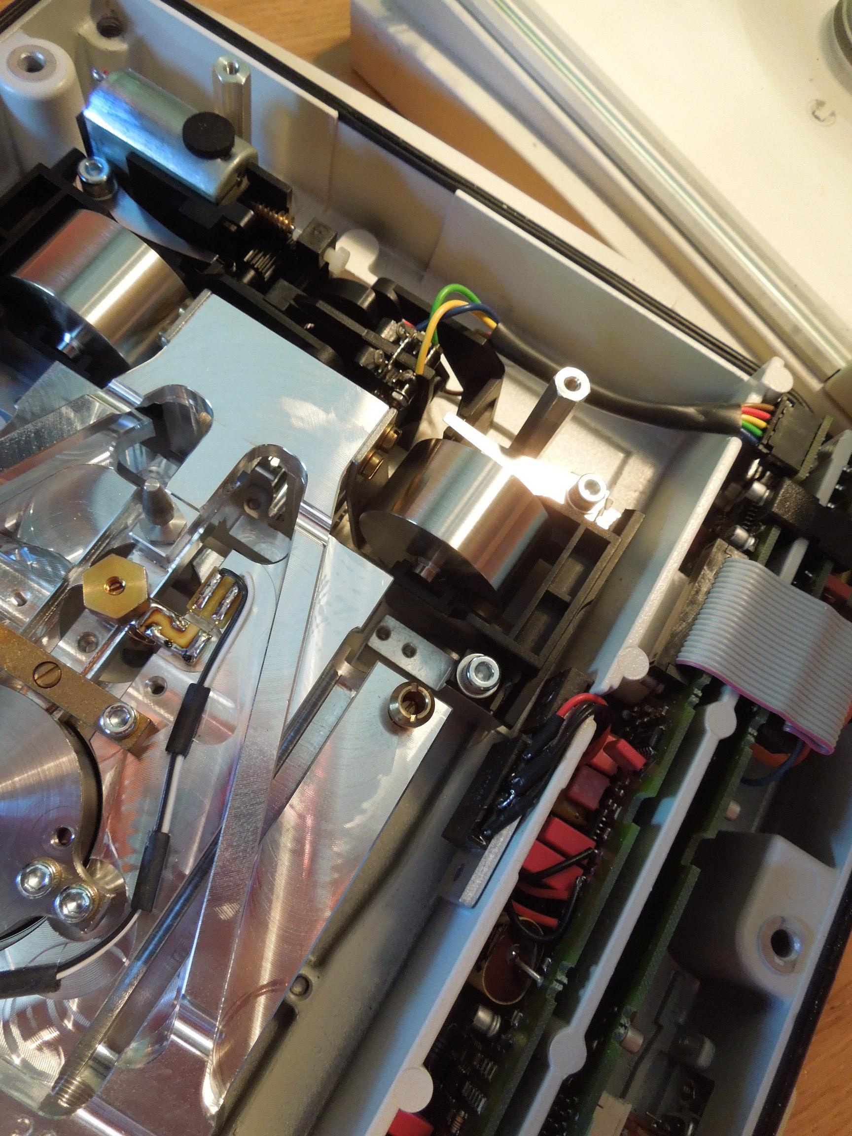

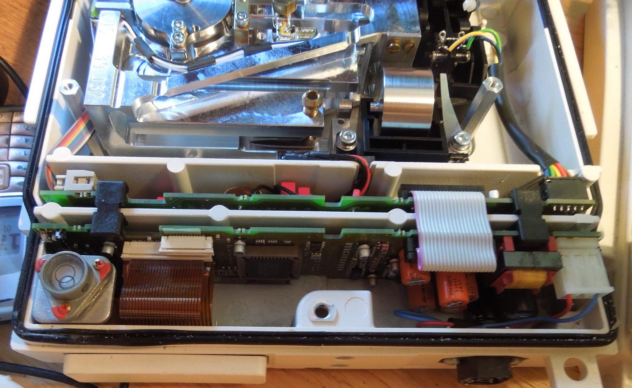

Also got a balance, a Sartorius LA230S. It didn't have a power supply with it and i'm not sure exactly what it requires. The back says 12 and 30 volts DC but its some weird custom 4 pin connector. I might be able to figure it out from the circuit board but I'll try emailing the company that makes it first.
There's not alot of information on these things online, and photos of their innner workings are as rare and low resolution as photos of bigfoot. I've attached a bunch of higher resolution photos just in case anyone interested finds this via google.
I'm probably mucking up the calibration by taking this cover off.
From what little i've been able to find online, they work on balancing the weight in the pan against an electromagnetic coil (the big round bit in the middle-right), sensing it's position via an optical position sensor (I assume to be that gold package on the far right) and adjusting the current to get it balanced. Then measuring the current to deduce the weight. The lever itself is a parallelogram flexure so the weight's position on the pan doesnt affect the reading. There might be some extra lever to amplify the travel of the coil too, but i'm going cross-eyed looking at this thing to make anything out.
There's one other electronic device on the flexure too that i'm not so sure about. It might be a temperature sensor to correct for things expanding.
I think this has something to do with automatically calibrating itself. My best guess is that it lowers those weights onto those brackets screwed onto the pan to use as a reference.
While I had the cover off I took Andrew's advise and made sure to sneeze on it to boost it's performance. I also made sure to touch all the chips without grounding myself and poked everything possible with a sharp screwdriver.

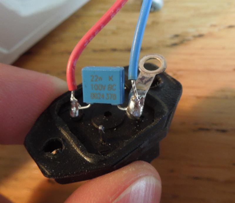

Had a closer look at the curcuits and connector and it only seems 2 of the pins are connected. Kinda weird they used such a connector but maybe it's not as custom as I though. The boards are a multi-layer affair and I couldn't trace the traces to figure out where they went.
The back specifically says "Input voltage 12V-30V = (DC)". I wonder if that means it'll accept anything between 12 and 30 volts. That seems like a wide range. If I work the courage up I could shove in 12 volts and see what happens. I at least know which pin is ground and positive now.

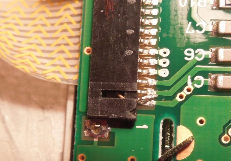

Always another problem... Could just be a loose cable somewhere. But at least it seems to just be the display at fault. I tried to tare it but my desk is so wobbly it couldn't get a stable reading.
Offline S. Heslop
  • Posts: 1154
Re: Making IR optics.
« Reply #12 on: July 02, 2016, 02:38:28 PM »
The problem was easy to find. Looks like this pin has bent and also torn it off the PCB. I'd solder in a bodge wire, but continuing the theme my soldering iron doesn't work any more. I guess I might go buy a new one tomorrow.
Offline S. Heslop
  • Posts: 1154
« Reply #13 on: July 02, 2016, 06:16:30 PM »

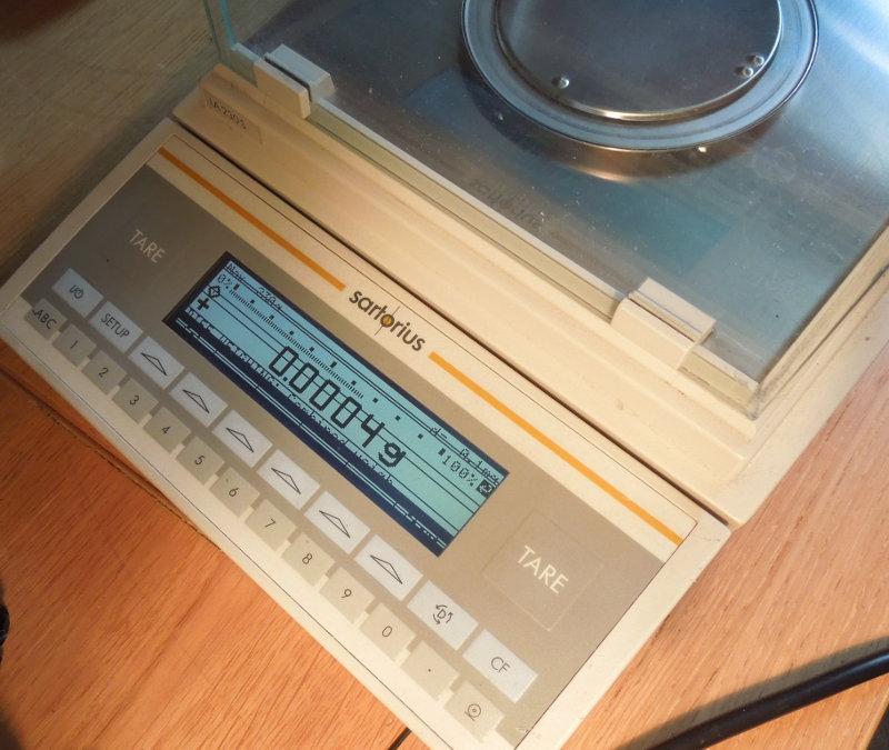

It didn't work. I spent a while making sure I hadn't shorted anything. I guess the problem must be in the LCD itself. The whole modules (LMG7380QHFC) are quite expensive at around £120. Looking at the data sheet it seems theres a LC7942N OFU2 responsible for the horizontal pixels. My best guess, as an idiot with no clue, is that replacing that could solve the problem. Or it could be something inside the module like a ribbon cable coming loose.
The weight is still perfectly readable with the screen in this condition but i'm keen to try fix it for its own sake, even if i'm risking making it worse. But at least the screens are available if I really muck it up.
Offline S. Heslop
  • Posts: 1154
« Reply #14 on: July 04, 2016, 11:39:34 AM »
I decided it was probably unlikely the chip had gone and the most likely cause is the ribbon cable between that circuit and the LCD itself.
So I carefully removed it and... ay caramba.
Seems like alot of the conductive scub from the ribbon cable has come off and there's not alot of cable left to work with.
This stupid module is built like calculators I remember pulling apart as a kid, with that big conductive rubber lump that's difficult to re-align. I don't know enough about these things to really pass judgement, but i'm not convinced this is worth £120 or being called 'industrial'.
Thing's are looking up. I think i've at least found the real source of the problem! I just need to read up how to work with these sorts of ribbon cables. I might be able to extend the existing one a bit with some more cable, or there could possibly be just enough material left to try re-attach it.

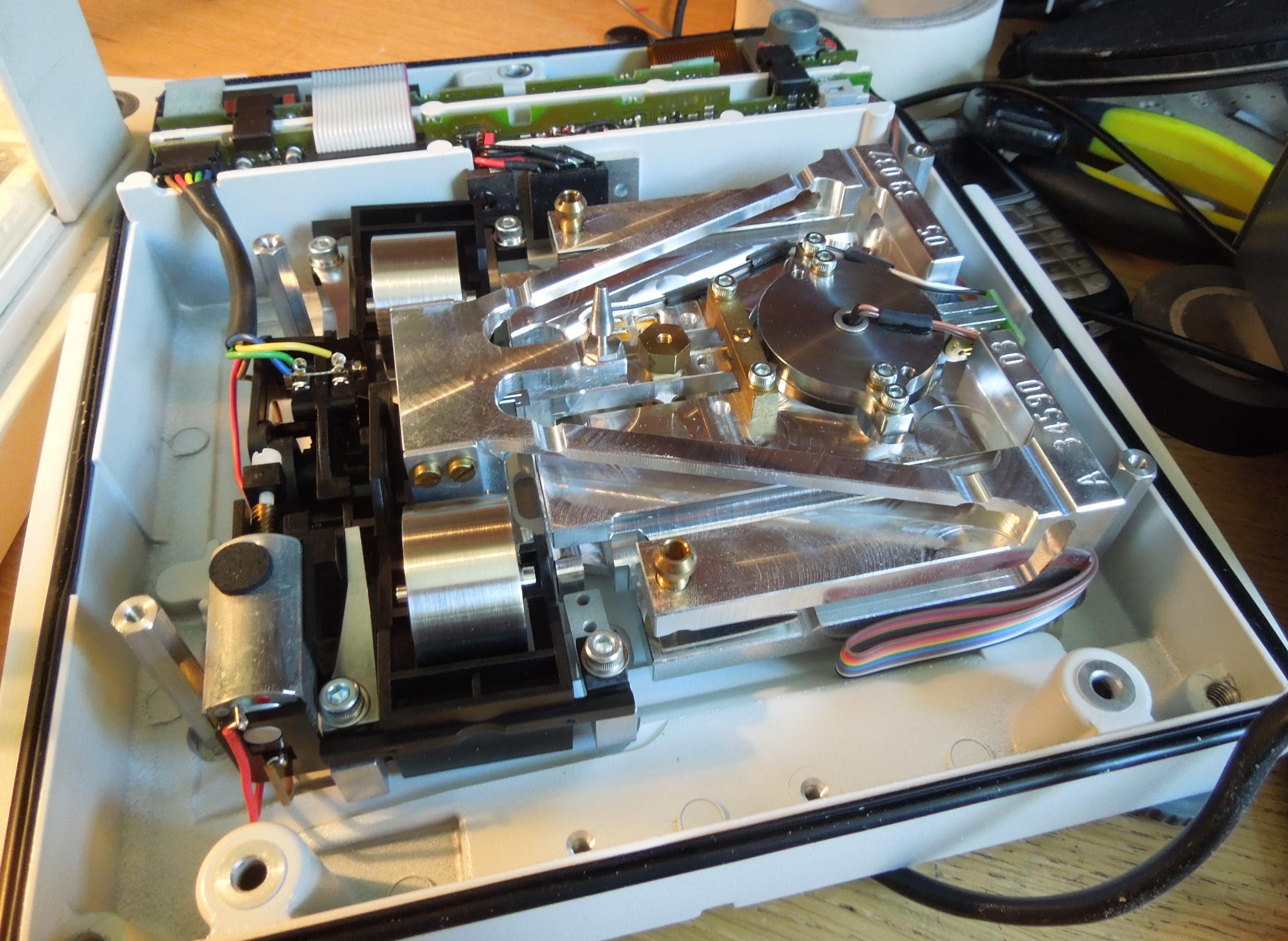

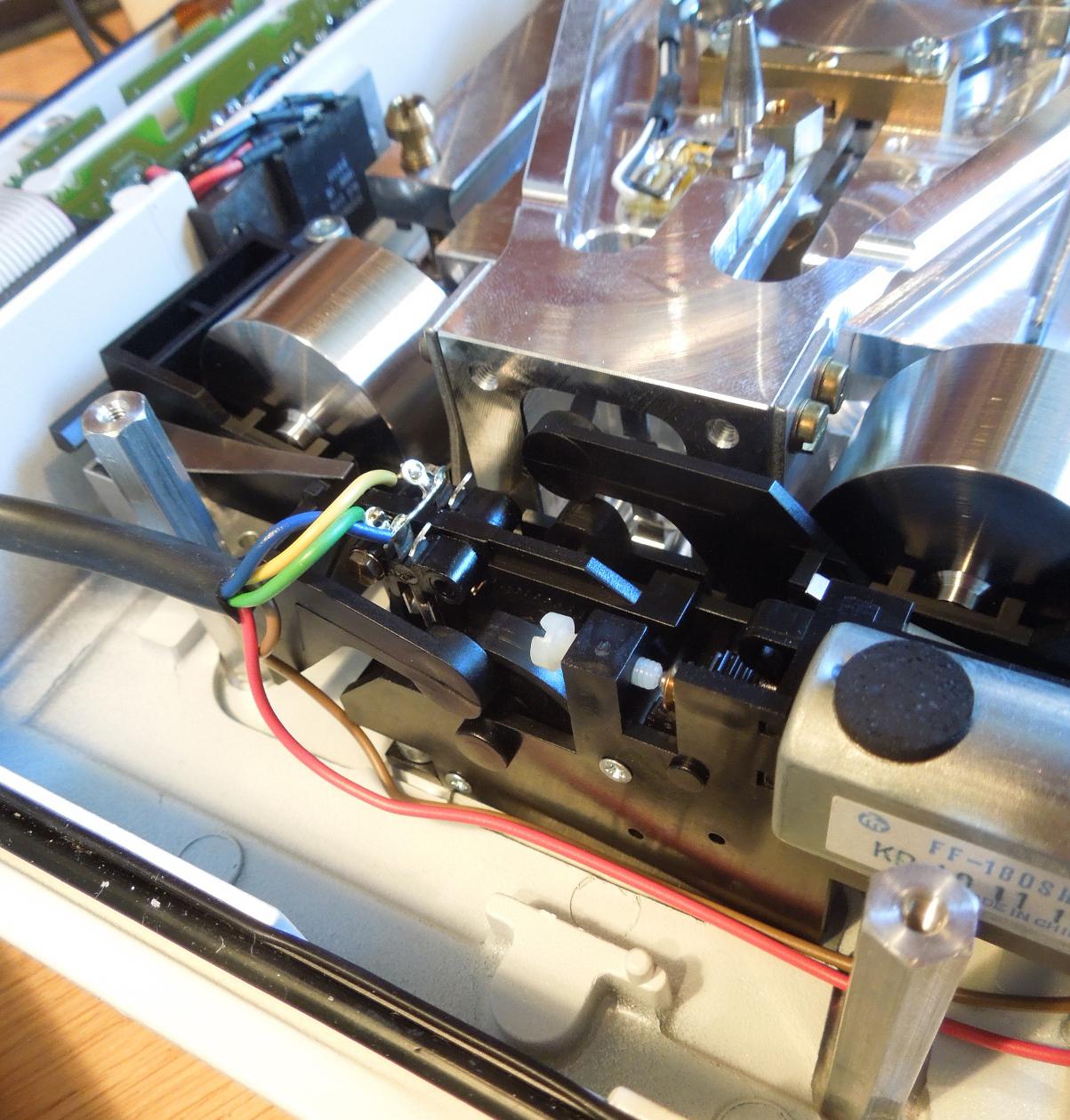

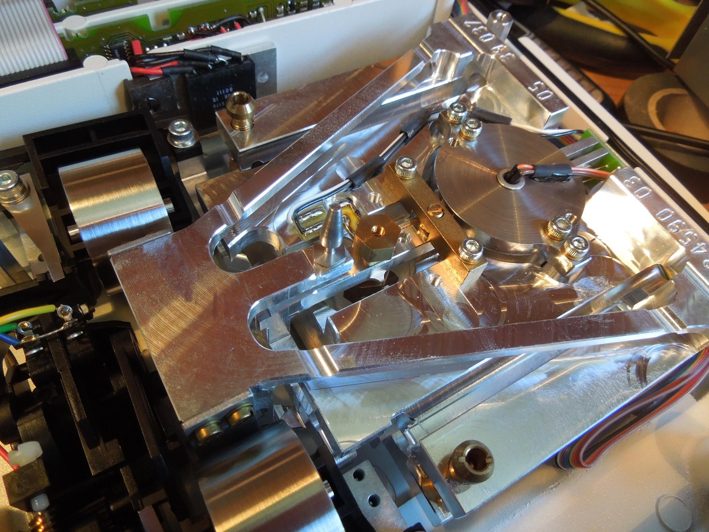

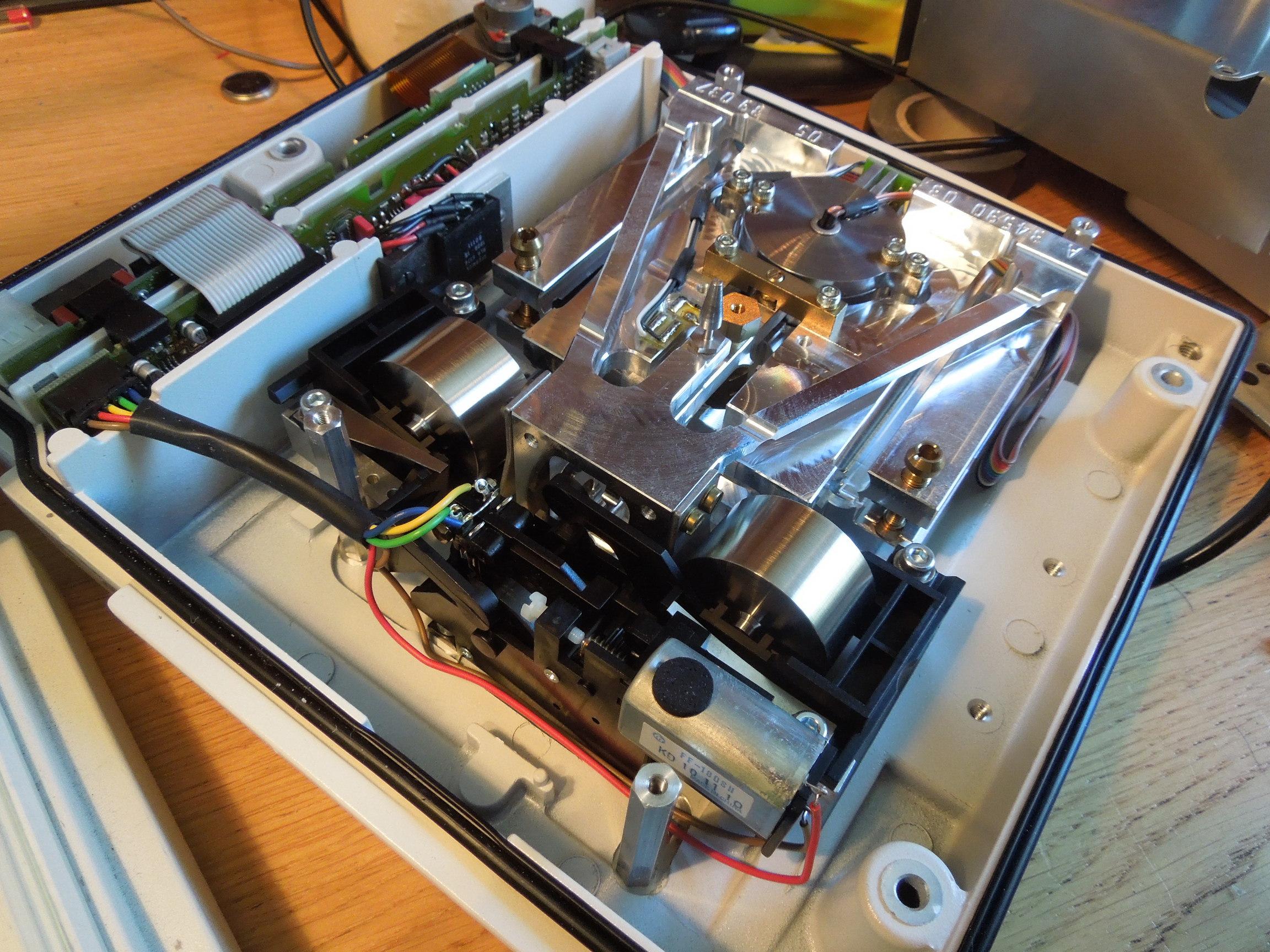

I can't help myself. I saw a totally broken one for sale and bought it to try help solve the few remaining mysteries.
The brass part is the system for lowering a calibration weight.
This arrangement is starting to get familiar. It's a much less panic inducing way of constructing it though than it being machined from solid.
The fault with this balance was that this part had snapped. It's a double flexure to connect the voice coil lever beam to the main parallelogram (i'm making these names up).
This is the inside of the voice coil. There's a pair of fairly strong opposing magnets that go in the middle of it. The lever beam floats on a pair of reasonably stout flexures and is electrically connected by two extremely thin flat wires. The optical position sensor is just a slot cut in a metal bar in between a transmitter and reciever.
Measuring the resistance of the coil. I'm not sure if this gives me any really useful information but it seemed like a clever thing to do!
The circuit has a bunch of op amps on it, a precision voltage reference in the middle, what I assume to be some sort of thermocouple, and this unidentified blob. It was hidden under an aluminium can filled with rubber, and it's quite well isolated. For thermal stability I assume. Might try dissolving that resin off to see whats underneath.
I need to take a closer look at the main board before I can really take a guess at what does what, but i'm leaving that for now. For the record I have no idea what i'm doing when it comes to electronics and i'm mostly just googling the chip numbers.
