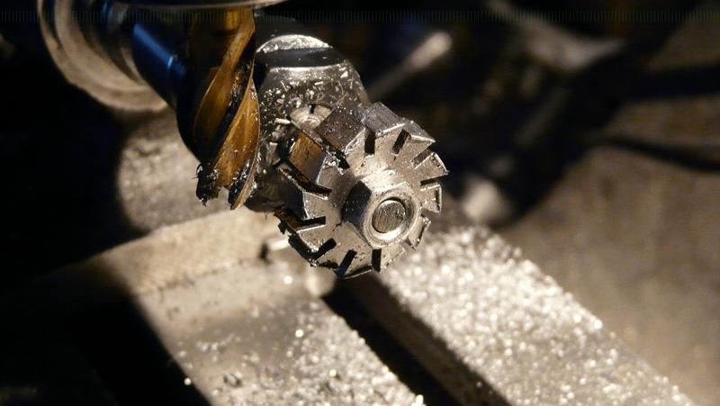

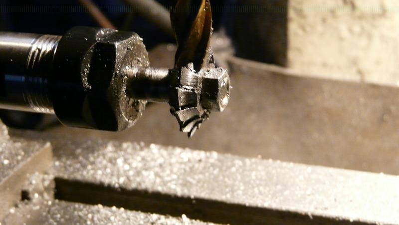

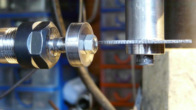

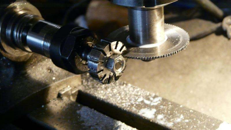

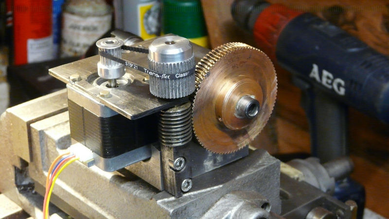

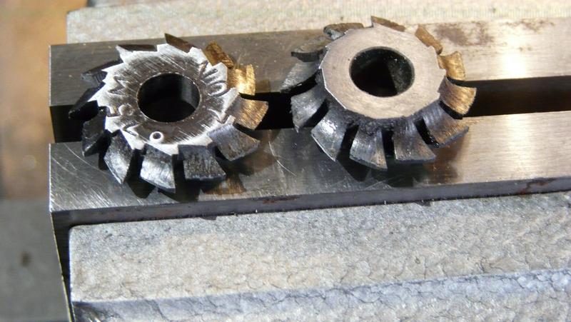

I have been making my own gear cutters for thirty years , mostly cyclodal for clocks by the pin method , this can take some time so I looked for an alturnative , using an end mill that is close to size with some adjustments , a slice of 25mm silver steel mouted on a arbour , and gashed with a 1/16" slitting saw with the bottom on centre will give a 7 degree top rake , turned anouther 3 degrees and faced off .
Re: Making gear cutters
« Reply #1 on: May 21, 2016, 02:39:50 PM »
I use cutter zip from Marv Klots site http://www.myvirtualnetwork.com/mklotz/ ,for a 90 tooth 0.75 mod worm wheel gives pin diamiter of 10.3275mm
pin centre                       of 11.1075mm
in feed                            of 2.7075
a 10mm end mill was used so 0.3275 is subtracted from the pin centres , and because the top rake and the extra three degrees is no longer tangental an adjustment of the in feed is needed , dia x the COS of the angle = 0.3mm this is added to the in feed as well as half the diferance to the pin dia = in feed of 3.171 , heated to cherry red and quenched takes les the an houre .

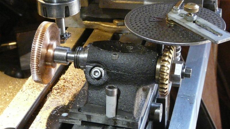

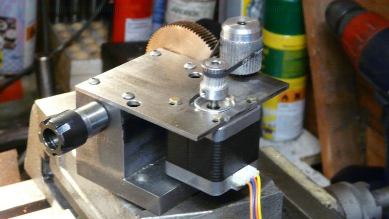

Cuts with a crisp crunchy sound and quickly , a little bit of lapping and I have a forth axis for my CNC .

Smart.
How do you get the side clearance? Is the tooth embryo a little above the centre line or arbour inclined?

« Reply #7 on: May 22, 2016, 12:23:59 PM »
Are the two cutters shown identical? One and a spare? How is the worm cut?
 :Doh: Sorry to be so thick headed today.
Alan
« Reply #8 on: May 22, 2016, 02:13:49 PM »
Side clearance is because the tooth is up ten degrees from centre , the two cutters are diferent one has 3 degrees more top rake and was to big not enugh added to the infeed and is in the bin , turned a worm and mesured the angle with a piece of pinion steel , and the dividing head tilted to that cut twelve times faster than a single point cutter .
