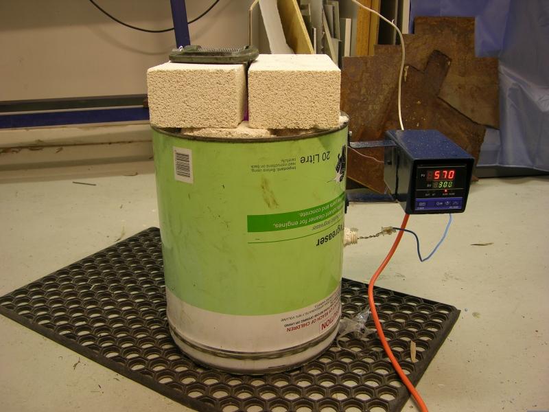

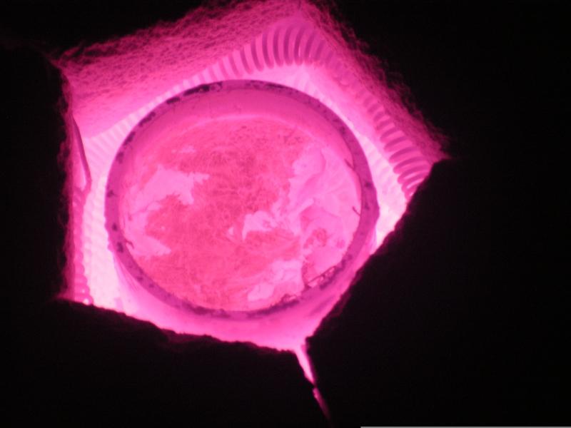

In my little electric furnace, I suspect that a lot of heating takes place by radiation.

Another reason not to put the element in the bottom is because of the thing I forget the name of.....bugger... But it's basically a property of the element wire that limits the power density (ie Watts per unit area) you can have before the wire overheats and cracks.
I ended up having to fit a higher resistance element, so I could space the coils more. This dropped the unit from 250V 15A to 250V 9A with a corresponding increase in time to melt.
It's more of a problem with small furnaces (like mine)... I really should have sprung for carbide bar elements... Or just built a bigger furnace...
I digress... On a small furnace you want as much surface area as you can get to keep the watts/m^2 low...
