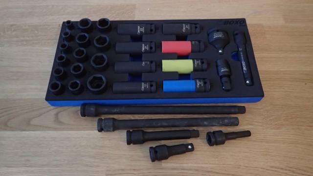

I bought 1/2" pneumatic impact driver, but it needs some goodies. It's small in size, single hammer unit, short body model.
I need a good selection of extensions and sockets. Most of the time I need the impact driver, when I can't use big enough T-drive under the car or such cramped place. Therefore woble extension would be nice.
I have learned on manual drives that it is easy to loose power on tool flex. I imagine that extensions and joints are even more critical on impact drive system than on manual tools.
Is there something that I should avoid or something that works better than the other?
Do wobble drive extensions work?
How well inside/outside torx sockets work with impact drivers?

Pekka,
I have an electric powered and pneumatic powered impact driver.
Both have their own dedicated sockets which are thicker and stronger than normal 1/2" drive sockets....
Maybe something to bear in mind when selecting acessories?

I've only used regular extensions with mine and have never had any problems but you should pick up a universal joint for the impact the regular ones break fairly quick.

I am told the "regular sockets" extnesions etc can shatter when used with impact drivers - WITH NO PRIOR WARNING.
I got dedicated "impact rated " sockets and extensions for mine. Got an 18v electric impact driver- bloody great -lifts the caravn when putting steadies down.Mind you the noise scares the heck out of other caravanners !

Thank you.
Reason why I am asking is that I will use that pneumatic impact driver only for bolts, that I can't break loose manually. Therefore it will be loading extension and sockets to their limit. I have used real industrial impact driver and had few those impact sockets shattered. Not pleasant. Big ones can be pretty destructive and they won't fit everywhere I plan to use it, therefore I bought small, but powerful one. Downside is that it is loud and vibrates like no other.
I have heard comment like sockets are consumables and the ones that will last are that thick wall that you can not use them often. On contrary extensions were considered more important...I guess I have to buy few good extensions and only sockets as I need them.
Last weekend I would have needed a wobble extension or joint to work with a impact driver. Universal joint for impact drivers seem to be pretty expensive. I have to see one prior bying one, I might check as well if that shop has a wobble extensions as well. I like them with manuals tools, but bit apprehensive with a impact driver.

OK. picked up the car from carage and I talked to the mechanic. He was convinced that thin and unnecessary extensions, universal joints and using multiple extensions are no-go. He said that wobble extension is preferable over universal joint. He had some sockets split and told not to buy cheap thick wall sockets, they are no use with modern cars.

got biger set than I thought. The shop had run out of the basic sets. Good news is that for next work I need to buy only one torx bit and I might need one intermediate lenght extension.

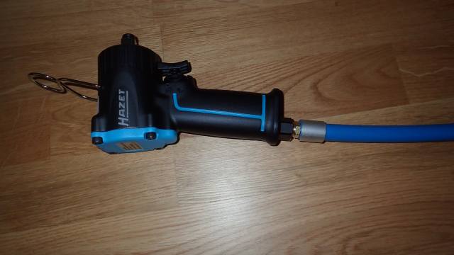

Got the driver
it's very compact. Manual had some interestin reading.

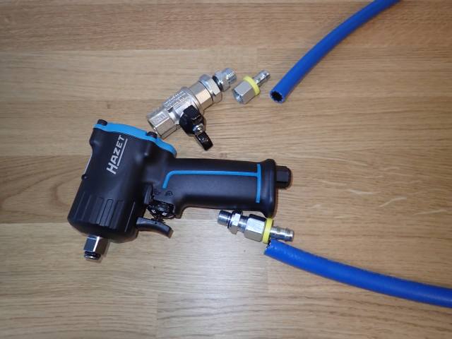

One interesting thing was that the instruction to put least 200mm of hose between quick connector and impact driver. I asked about that on some people. I got some opinions that impact drivers dont't last if the QC is hooked it directly. Some argue that QC couplings fail with vibration. So there may be something to it.
I got some parts to hook up 1/4" impact driver thread to 10 mm ID hose and other parts. The hose is only about 2,5 m long.
Now I have to test oiler and regulator to see if they cause too much flow/pressure drop when in use. Oiler is not that essential on ocasional use, but I am curious.

Parker seems to be G1/4".
Air gun seems to be NTP 1/4". 18 vs.19 tpi and all the fun.
It would have been too easy and neat.

ebay is knee deep in adaptors - here is just one random example:
http://www.ebay.co.uk/itm/NPT-Male-BSPP-Male-Cone-Nipple-Adapters-For-Air-and-Hydraulics-NPT-Connector-/121255605176?var=&hash=item1c3b65b3b8:m:mYS4r5kqIiyfnWSCQrOZglw
Though I did recently buy a set of 1/4 npt taps and dies for just this issue :)

I have put many, many, 1/4" BSPT fittings into 1/4"NPT tools. I like using liquid tape which helps a bit, but at the end of the day its just another example of 'Brute force and lubrication' solving the worlds problems...

Turned out that most tool shops don't actually know at all what is that threaded nipple they are selling. Lucily few pagages have markings (which some tool shop workers don't seem to know). Pretty amazing really.
Anyway, R 1/4" turned out to be the perfect fit and it (and some others tools) have been sorted now.
I asked around and funny thing is that most of the people seemed to resort buying a G 1/4" tap and then it all is standard Parker fittings and sealing glue. Seem to work. Brute force approach I think.
Maybe I should buy a little box of fittings and standard hose. And buy fittings as I use them to keep minimal amount of cash invested, after all pneuamtic fittings are not my hobby and I don't have any such shop nearby.
I don't know if this form of fitting good or safe, but it has worked for me on barbed hose fittings: I measure outside of the hose and make thick wall aluminium bushing that has ID just a tad bigger than the hose. Both inside ends of this bushing are camfered. Then I slip the bushing over the hose, some distance down (usually 150 mm or so), fit the barbed fitting and force the bushing over the fitting. They seem to hold well, I haven't had any trouble with them. I have noticed that some barb fittings have more barbs or higher tops, but they have worked fine so far.
I have been thinking of adding ashessive shrink tube on top of the whole, but haven't found flexible material. Normal electrical one seem to crack after a year or so.
I prefer the bushing over jubilee clips. I really hate them on power tools. They scratch me or something else.
