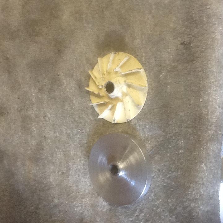

I need to remove the fan on my Bridges drill.....
Any suggestions that dont involve its destruction?

Andrew,
The motor assembly is a complete unit and fits in from the back of the housing, the retaining screws are under the fan....there is no way to remove the armature from the assembly without removing the fan first....
Its a Stanley Bridges drill from the 60's.... If you recall them?

« Reply #11 on: April 03, 2016, 11:04:26 AM »
Nope!
A closer look at it, showed that the fan is moulded around the metal boss....so the back side of the boss is covered by the plastic fan.....
I'm guessing if I want this off it aint coming off whole.....
I just wonder if some localised warmth from my hot air desoldering station might be enough to free the boss from the shaft without melting the fan?
Thoughts? :scratch:

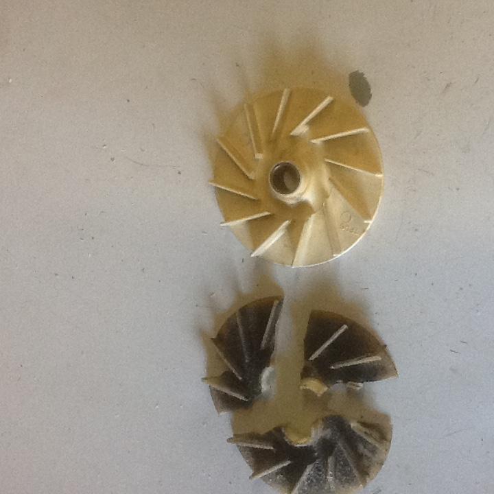

« Reply #16 on: April 10, 2016, 04:50:02 AM »
Ok,
An update on this....
I successfully removed the fan from the motor shaft and got the rest dismantled....Time now to clean up all the bits and fit some new bearings....
Sadly though, on one drill, I managed to break the fan :palm: So I need a new one so that I can rebuild that one too....( I think I got a bit of an obsession going on at the moment, I've got 9 Stanley Bridges drills in total and a couple more on the way.... :Doh:)
Got to have something to keep me busy! :lol:
So ideas please on how to make a new fan......

Re: Fan removal
« Reply #22 on: April 10, 2016, 09:49:16 AM »

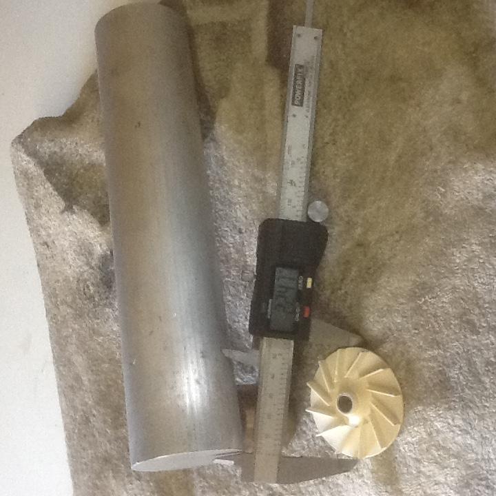

So look what I found?...... :)
Looks like I'm going to be busy making a new fan after all....... :dremel: :clap:
Re: Fan removal
« Reply #23 on: April 10, 2016, 11:59:00 AM »
 :lol: Is that solid billet aluminum  John , the good stuff  :lol: :lol: :lol:
IS IT  DONE YET !  :poke:
Rob  :beer:
Re: Fan removal
« Reply #24 on: April 10, 2016, 12:10:54 PM »
Rob,
Yup solid aluminium.....approx 10 in long.....
I need to work out how I'm going to cut the curvy fins.... :scratch:
Re: Fan removal
« Reply #25 on: April 10, 2016, 12:20:20 PM »
 :scratch: Blades look straight to me mate , just off set  :smart:

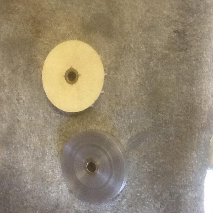

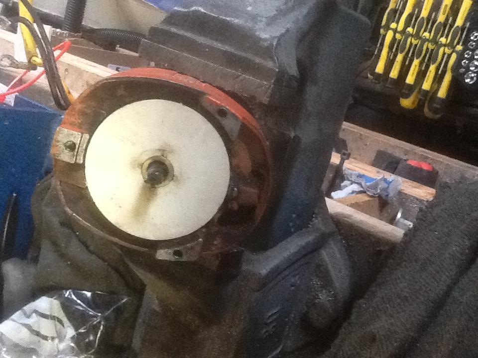

Some progress made today......
I now need to mount the disc on a mandrel, put it on the rotab and mill the fins....then job done .
I hope...

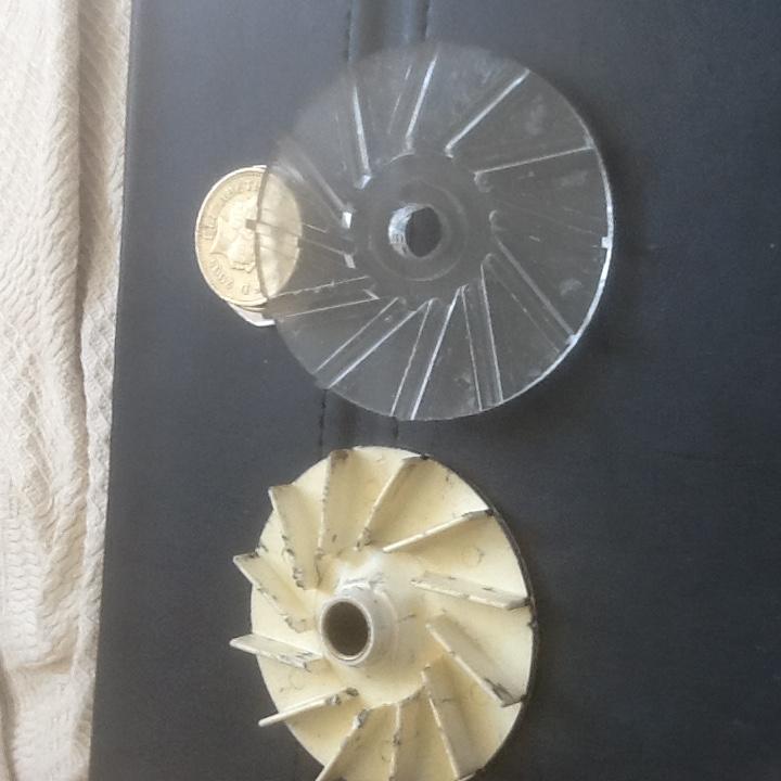

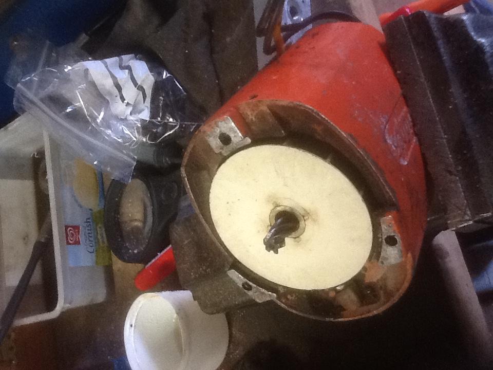

Re: Fan removal- proof of concept
« Reply #34 on: May 23, 2016, 08:15:35 AM »
Thanks Rob, had a great time at the pictures on the Wednesday....( I dont kiss and tell.... :lol:)
So, abandoned the idea of making a new fan from ally, coz it hurt my cutters too much....
So after Andrew's comments about a printed version,......hang on a minute....I got some acrylic sheet somewhere....
Well after an hour I got this made.....
I'm not sure about its durability, will it survive spinning at 4-5000 rpm?
Who knows....?
