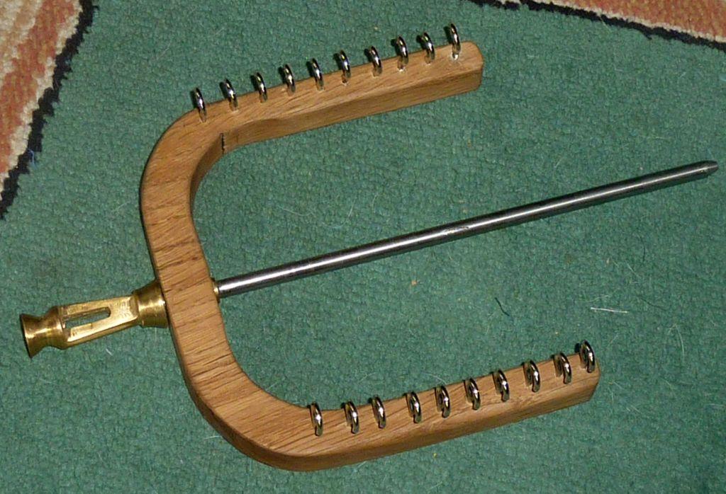

I had no idea where to post this being its part wood part brass part stainless steel  :Doh:
Sue asked for a 2nd flyer for her spinning wheel slightly smaller arms, less hooks, wider between arms.
Had fun machining this as well as making the Oak U, Stainless steel shaft from an old printer threaded M6 into the brass.

Nice piece! err... what's it do?

Winds the spun yarn onto a spool on a spinning wheel at progressive axial positions. I've been trying to work out a design for one that automatically processes back and forth across the spool like a coil winder does, to fit on my wife's spinning wheel.

good job mate should score you a brownie point or 2 , but and there is always a but aint there i think it will break very easy on the cross grain section at the bottom of the U probably would of been better made for 2 or 3 bits of wood laminated with the grain at 90 degrees to each other or even made with an off cut of good ply wood .that aside i hope it stays in one piece and lasts forever and i am wrong about the weak point on the cross grain .
johno
Thanks
It did Johno she got me a bigger shed  :D :) thats part of reason for late reply been buys packing as shed comes with new abode as well.
You are right they do break if dropped, man handled and abused. I have had to repair other ladies flyers in the past. The reason for design is keeping it original I had discussed with LOML making a 3 part type like she has on her Wee Peggy  :whip: she's a hard taskmaster/mistress.
