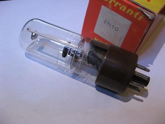

Steve, mine was made yonks ago - probably in the 1950's from the black crackle paint finish - by Ferranti who I worked for for many years. I've seen the same design made by several of the defence companies so I suspect that it was an NPL design (National Physical Laboratory)
It used a tube like this one currently featuring on eBay, and is just a relaxation oscillator. Capacitor charges via a variable resistor, until the tube fires and discharges it.
