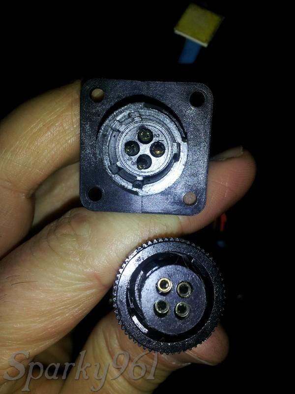

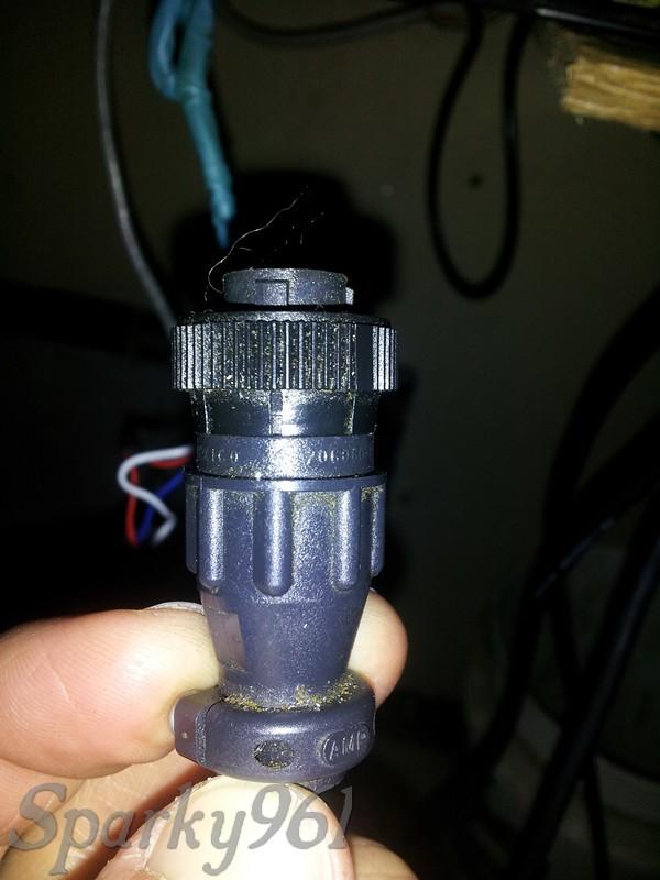

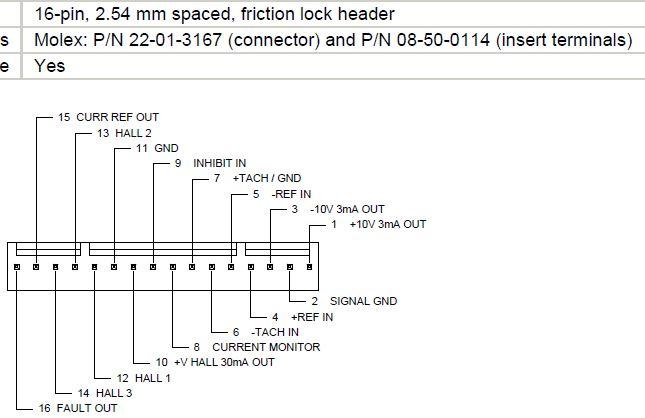

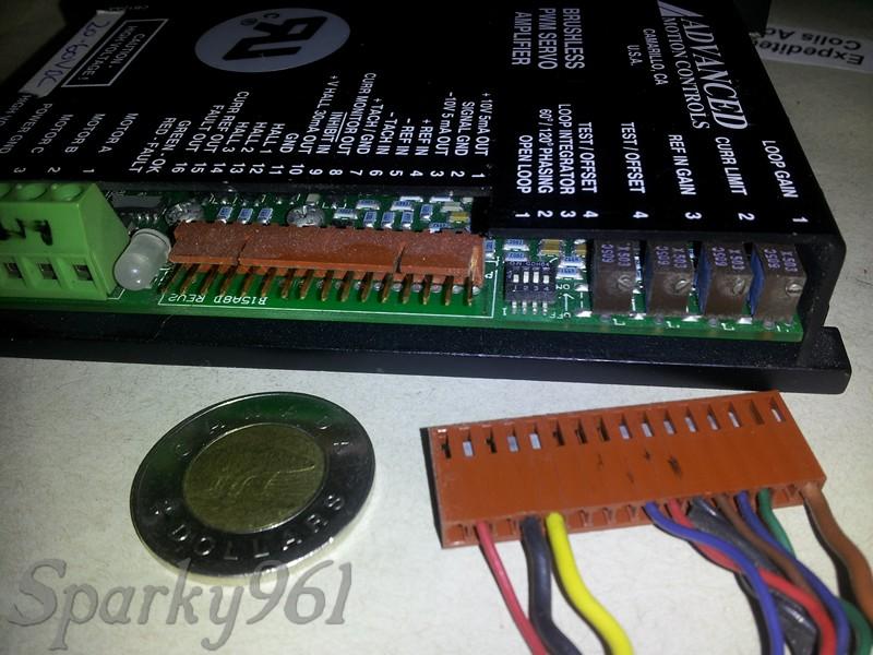

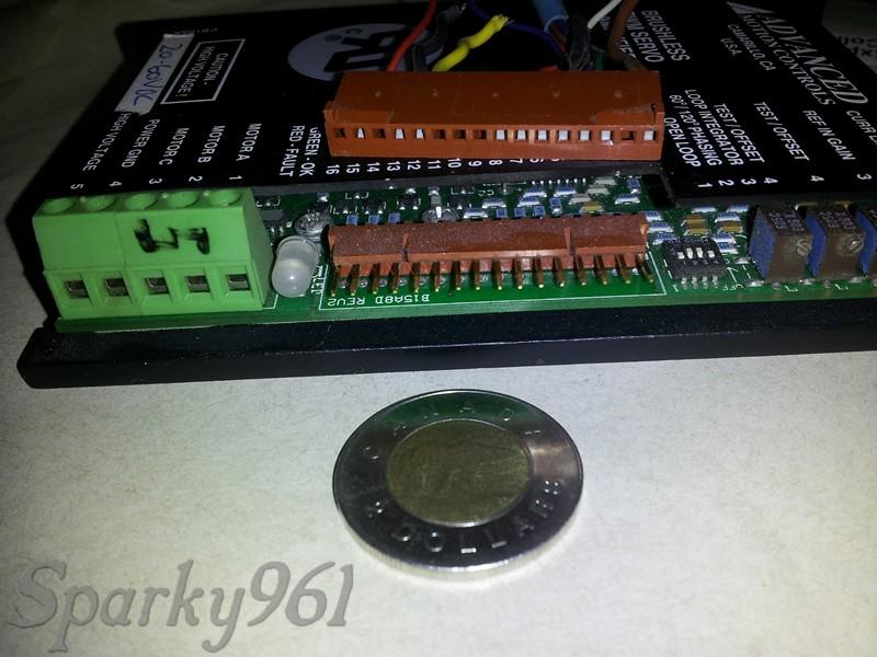

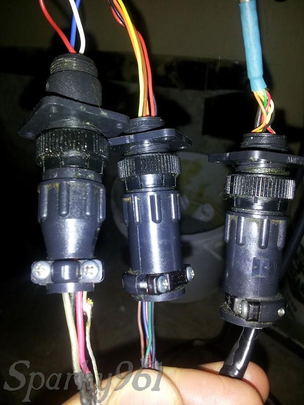

Sorry, I put up the original message on my way out.  Upon re-reading it I wasn't very clear in my request for info.
AMP is the manufacturer, but they make bazillions (yes, that's a scientific term) of different connector types.  I've attached pictures showing the two (M and F for each) that I'm currently working with.  Also some technical drawings.  Now that I'm looking at them again, the first isn't even "AMP", it's "Molex".  The second is AMP/Tyco
For the AMP/Tyco, part number molded on the shell is 206060-1.  The data sheet has information about a bunch of others in the series as well.
http://www.farnell.com/datasheets/1276248.pdf
I was hoping to have a more generic solution that will work with others too but maybe I'm asking for too much there.  Maybe I can just butcher them with pliers ;) ?

For the circular Amp type I've always bought 'solder spill' contacts hence avoided the need to crimp. Slip a sleeve on the wire first, solder it then slip the sleeve over the exposed bit of contact.
For the Molex ones I bought the crimp tool from RS if I remember correctly

« Reply #5 on: March 19, 2016, 10:49:50 AM »
Thanks, Andrew.  I didn't realize there were solder-type contacts for the round AMP connectors.  The terminals are usually the inexpensive part, it's the crimper that's generally pretty insane to buy.  I'll try that route for those.
I also looked into the price for crimpers for Molex and they weren't near as bad - though still a bit costly for occasional hobby use.  I was able to find some multi-purpose ones that looked decent so that might be the way I go there.

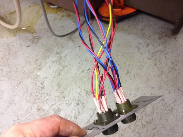

These are the ones I used on my servo driven 4th axis:

« Reply #7 on: March 19, 2016, 01:01:06 PM »
Oh, so the pins don't actually come out of the shell?  I have some SUB-D connectors like that.  Not bad to work with, but I was hoping to re-use the shells I have.  It isn't critical I do so, just trying to save a few bucks.

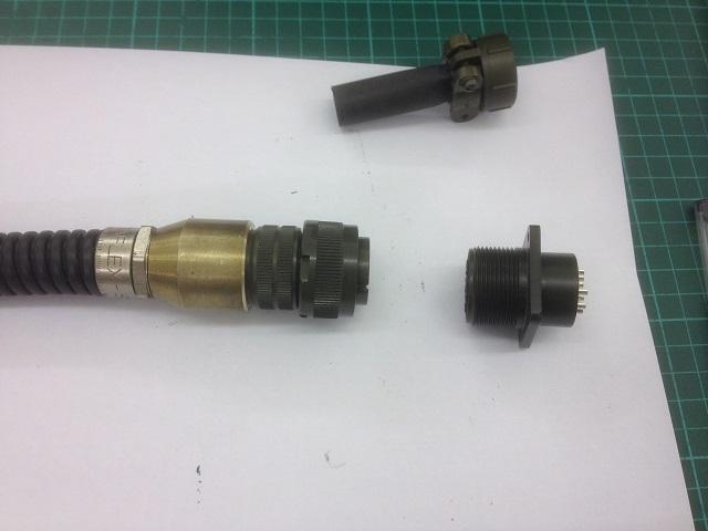

« Reply #8 on: March 19, 2016, 01:43:50 PM »
They may do perhaps with one of those tubular extractors - mine came fully populated - they are well made Chinese copies off ebay sold as 'circular military connectors'. Initially the seller cocked up the male / femaleness of the free cable plug / chassis socket, so I ended up with a few of the opposite 'orientation'
Here is an example:
http://www.ebay.co.uk/itm/Military-4-Pin-Cylindrical-Voltage-Circular-Connector-/191653795399?hash=item2c9f74d647:g:JkMAAOSwyQtVwfUN
