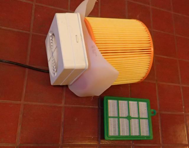

I have some experinece on cooker hood filters. I have washable mesh "grease" filter and big mat charcoal filter atop of i. Works great on grase and such. Not sure if it works on smaller particles though.

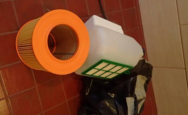

I discovered trashbag method used to measure small fan flow. Basically you measure how many seconds it takes to fill an empty trash bag.
I used that on small axial duct fan. Made a setup and measured it without any filter. about 6,8 sec. Then with a big stationary vacuum cleaner exhaust filter (big yellow/orange flanges canster type. It it slowed dow the fill rate about a second, big coarse AC matt offered slightly less resitance. No problem there.
Then I checked the fan with an vacuum cleaner exhaust fileters, rating was HEPA 12, another brand new and other one rather dirty, used about a year....both of them had way too much back pressure, the fan stalled and did not fill the trash bag even on 20 seconds.... Those filters would bee good eneough, but would need completely different fan.

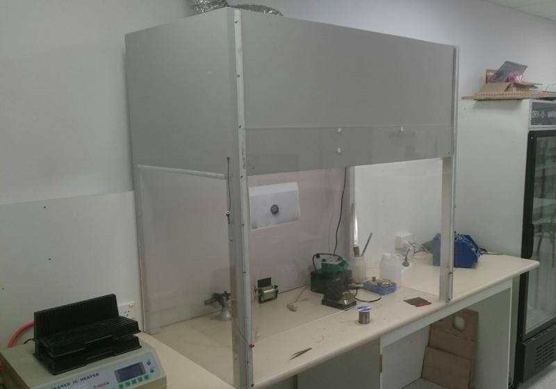

Here's one I prepared earlier. There's a plenum chamber at the top and a row of holes at the back of the 'ceiling' with some filter foam over them. But mostly it just vents out the main extraction chimney (same system used for the laser cutters and reflow oven). I'm sure the roof is littered with bird carcasses by now....
The front cover slides up some PVC trim strips and can be pinned into a couple of positions.
Before we had this, we tried all the 'point extraction' options. The only ones that removed enough fumes to prevent headaches were so noisy and cumbersome that they were impractical.
This is just some MDF, acrylic sheet and a lick of paint and removes 100% of the fumes.

« Reply #10 on: March 24, 2016, 06:42:50 AM »
That is very nice. Very professional and works100%. I would not be too worried about dead critters on the roof. Outside tends to be pretty good ventilation and any small exposure is spatially dispersed.
I have few small snags on this solution, although something like that will be my firs choice:
* I do most of my electronic hobbies in the winter and typically here weather is pretty cold. If used too long it will pump some air (heat) out.
* Snow load on the roof  cold weather. This means that the duct on the attic must be insulated and outlet must be made pretty professionally. When few tons of snow starts to move, all stuff must be bolted to roof under structure or there will be hole...
* Inavasive to the house construction.....red tape and all that.
Lot of that problem could be avoided if I could went air out trough the ventilation window, but I need to test how to avoid condensation and other issues.
My plan to is to test venting out and then build on three way valve. Exhaust out or into room. Plan "B" is a loud fan with local removal and good filtering.

The nice thing about the fume cabinet approach is that you don't need much air flow or velocity.
All the other options require fast moving air to entrain the fumes.
