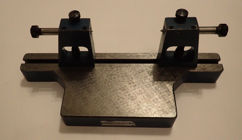

Depending on your intrest this might be OT or not. Least my question is closely related:
How to true female centre to OD of the clinder? Specimen is surface hardened very accurate tool steel rod, relatively soft centre (carbide cuts easy, HSS just about).
I bought well used and some parts missing small bench centre. Checking against blued surface plate shows slight dip on the middle of the table and rails. Very slight.

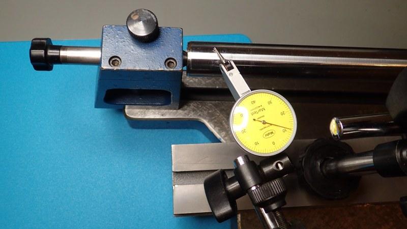

Just about fits my DIY clindrical "test bar" l=300 mm OD25mm.
Shows less than 0,02 mm of TIR, I would like improve it a little without grinding OD.
The indicator is off on that picture, I moved the bench centre to be able to take clear photo.

Pekka,
I made a test bar for my lathe using some hardened and tempered ground bar. I could drill the centres with a centre drill but there was still some runout. I held one end in a collet and supported the other end with a fixed steady (right at the end) and then bored the centre with the topslide set at 30 degrees to the lathe axis and it's now within about 0.001mm TIR.
Re: Do you lap your female centres ?
« Reply #16 on: November 24, 2018, 08:13:56 AM »
Thank you Phil.
I tried it once, but had trouble of making a small boring bar to bore out small enough centre. Now, when you reminded of this method and I'm thinking if I have broken solid carbon end mill I could grind the small boring bar.
