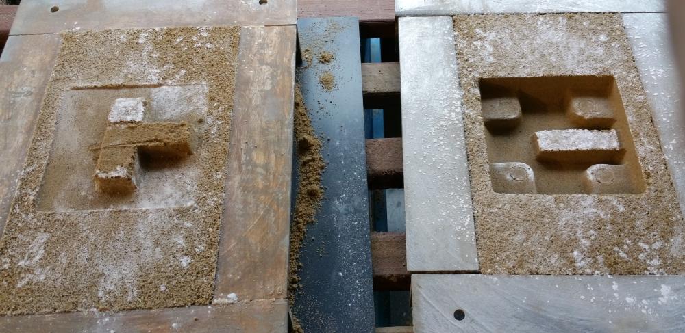

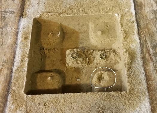

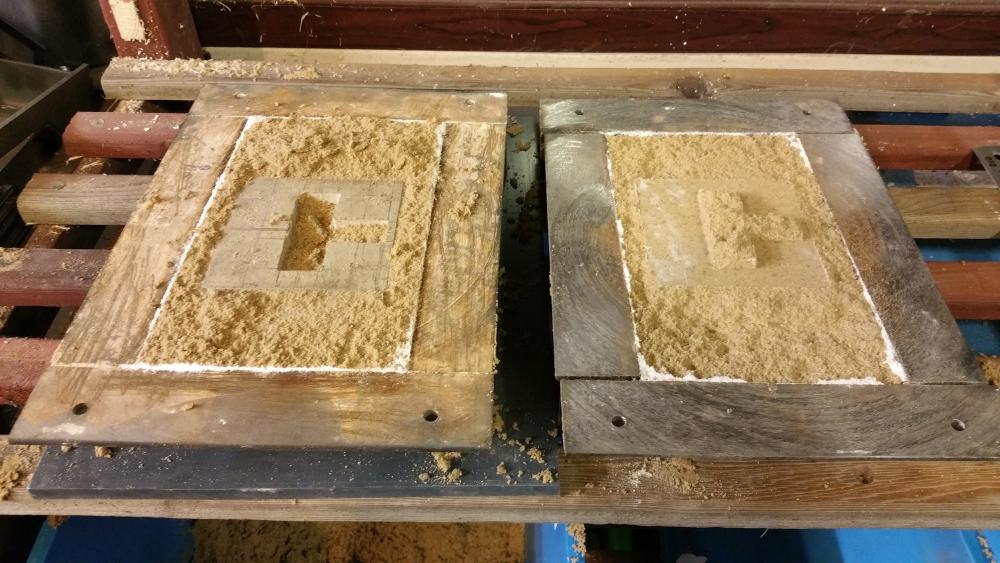

I have added a few pics of the results of my attempts to create a green sand mold but despite putting plenty of powder the sand is sticking together.
I first thought it was too wet so added a bit more sand to the mix and tried again, the results of which you see in the pictures.
I am now thinking that maybe there isnt enough clay in the mix but would like to see if anyone thinks its possible. I origionally used approximatly a 10 to 1 mix but that was before adding the extra sand.
The drag? actually turned out pretty well concidering I forgot the powder on the pattern it pulled away a little (circled) and the core? pulled away too but i think I need to increase the angle on the pattern for that to work.

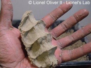

Do a 'squeeze test' on the mix. Take a handful and clench your fist with it in it. Relax your fingers to a flat hand. The sand should take the impression of your fingers, but the bit you've squeezed should be able to be picked up. Holding both ends with thumbs and two fingers, bend the sample. It should break cleanly showing exposed edges like cracked cast iron.
Too much clay and moisture and it won't leave your hand cleanly.
Too little clay and it'll crumble and not break.
Moisture content should be about 4%   by weight

I did try to take a pic of the squeeze test too but trying hold sand in one hand phone in the other and press the button with my nose didnt work out too well  :lol:
However mine was much more crumbly than that so more clay may be in order will try it tomorrow.

Added more clay tonight and got much better result on the drag but I need to mix it more I think the cope pulled a big lump away but it was very rich with clay where it happened. This is the problem with having to work for a living you rush stuff.

How are you doing your mixing?
The idea is that each grain of sand has a very light coating of binder (clay) with the whole body being uniform in texture - I'm a bit concerned to hear one area was 'very rich with clay' as that implies it's not mixed well enough.
Not always possible, but if making your own sand mix (rather than buying Mansfield Sand for instance which already has clay in it), then start with dry sand and dry powdered binder - bentonite clay for instance - and mechanically mix it (cement mixer or a paint stirrer if on a small scale) .
Only add the water to temper it when it is already well mixed

by hand but I will get it mixed just need to keep at it. Not possible to mix it dry now unless I waste the big bucket I have made up.

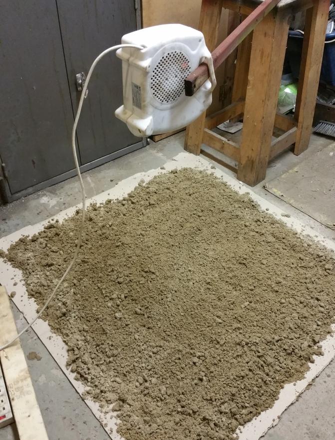

You don't have to waste your big bucket full to mix dry, spread the mixture out on news paper, as thinly as you can, crush when dry (anything will do to crush, a hammer, a piece of wood) and remix with a mechanical stirrer or by hand when dry. Use a mask when mixing dry sand, watch out for dust!

My patent pending drying system  :lol: Had the heat setting on while I was sat in there but switched it to just blower mode for the night and left the extracter which I installed to help stop the condensation in the shop on permanent.

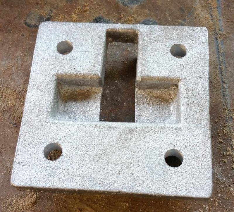

What a difference dried, crushed and sieved and the results are amazing especially the drag still need to round the corners on the cope impression but it seems like I am very nearly good to go.
Was amazed at how little water was needed only added a cupfull of water once it was done.

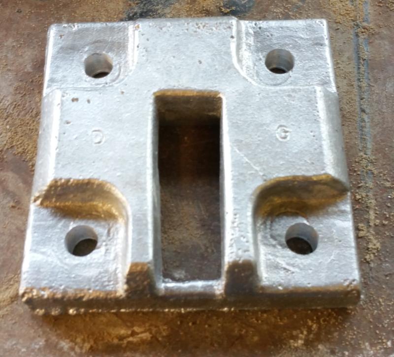

 :ddb: My first ever successful casting  :ddb:
Thank you all for the help   :beer:
