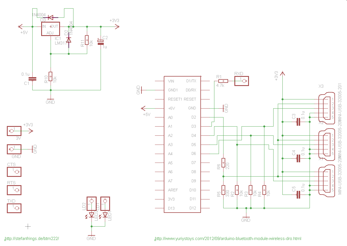

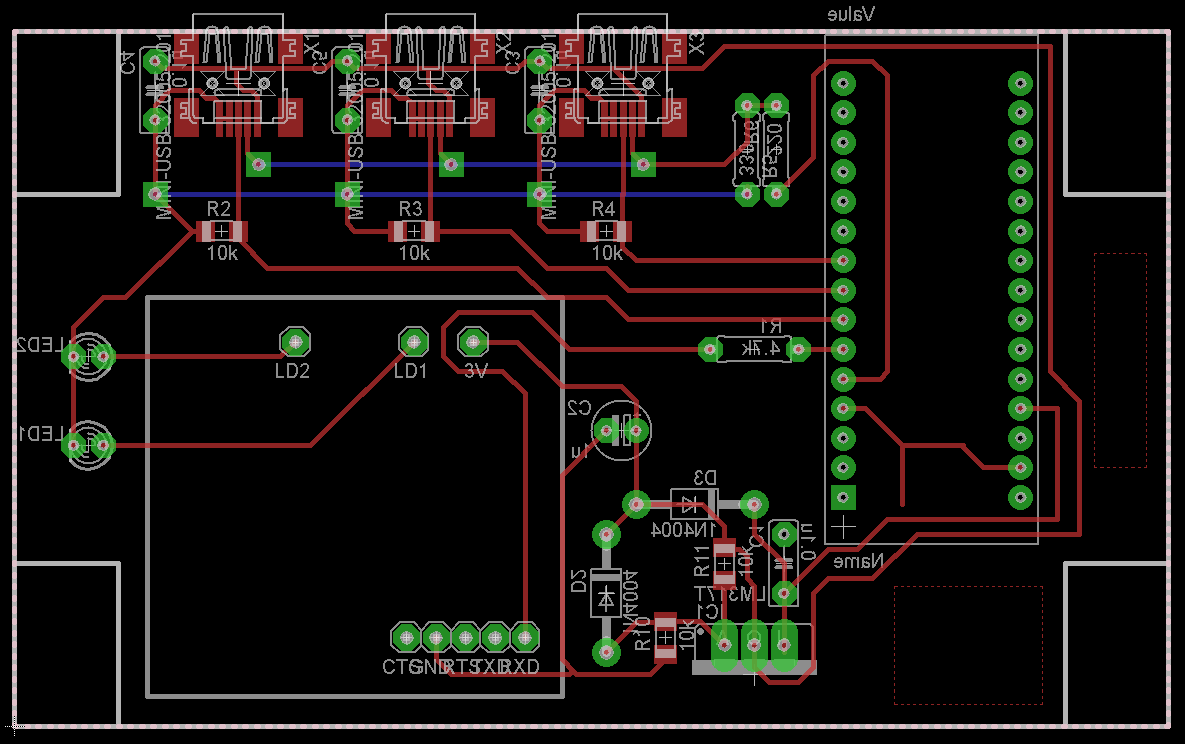

One more from me, you made a custom board, did you use a drafting package like Eagle or something else?
Care to share your design?

Sure...
It's nothing special, it kind of works for me but you will want to replace the jacks by something else depending on your scales.
I used a BTM-222 for bluetooth but would not recommend that. There are other modules which are more complete. I had to make a PCB antenna myself. It works, but too much hassle.
Also, most parts of it are re-used from the web, the URLs are in the schematic. :)
