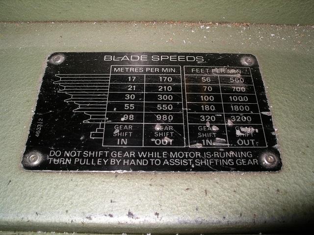

« Reply #5 on: February 12, 2016, 05:57:54 PM »
Blade speed needs to be way higher for wood by a factor of ten from metal.  Teeth per inch needs to be way coarser for wood than metal.
My Startrite - I think it's a 10V - has a knob to pull out to change between two speed ranges which gives the 10x ratio. It also has a gauge built in by the tension knob calibrated in blade width. It also has a spinny disk thing that gives  blade tpi and feet per min for different materials.
Here is a picture of the change pulley chart that I happen to have on the PC

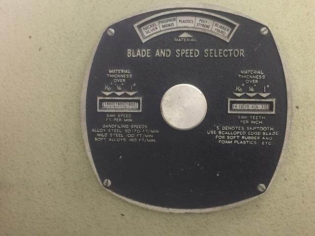

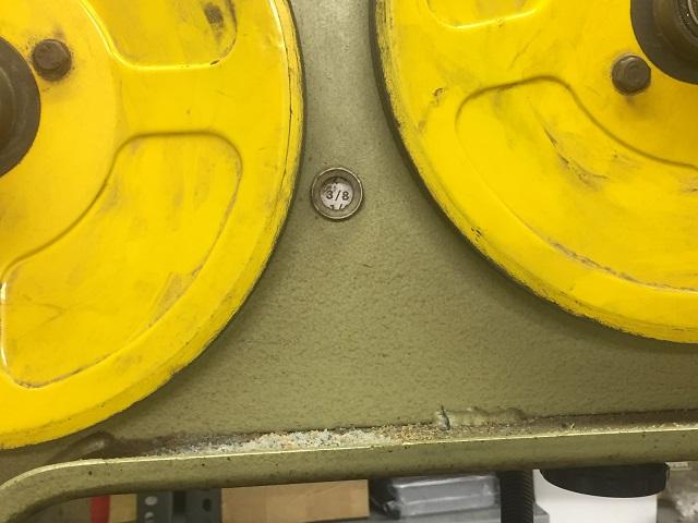

« Reply #7 on: February 13, 2016, 04:13:01 AM »
Ade,
A couple of photos I've taken this morning for you - it turns out mine is an 18V10
First the tension gauge nestling between the wheels (I'd be very surprised if yours doesn't have this)
Secondly the TPI / Speed / Thickness calculator
