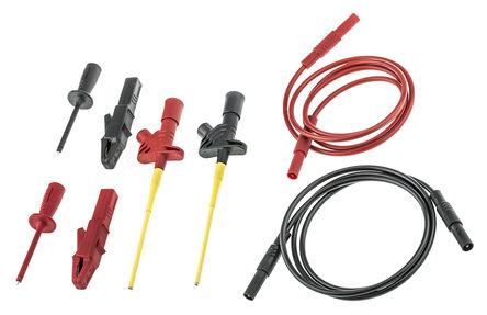

I have a mötley collection of various 4 mm plug test leads and then some scope probes.
Much of the economy crocodile leads and cheap versions of IC clips and wire probes are crap.
Hirschmann kleps seems to work and has endured. I'm going to order a set or two.
This sort of stuff would be traditional low voltage "kit":
https://www.conrad.de/de/messleitungs-set-lamellenstecker-4-mm-lamellenstecker-4-mm-100-m-schwarz-rot-sks-hirschmann-pms-4-co-120030.html?sc.ref=Category%20Overview
And it offers great flexibility, but:
* I have always been a big fan of 4 mm system, can use all leads together
* Does 2 mm system offers anything else, but smaller current rating and smaller size?

I think its inevitable we end up with large collection of test leads
the kits you have linked to are a good start , I have started off with similar ready made  test leads
over time I have added various shrouded test leads and DIY leads with 4mm shutter plugs

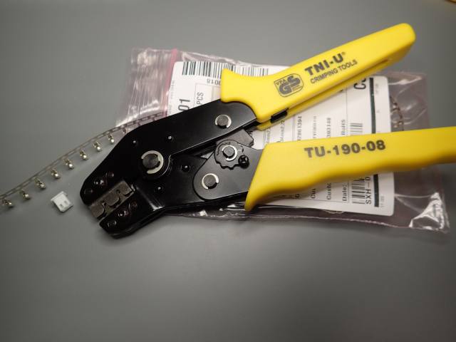

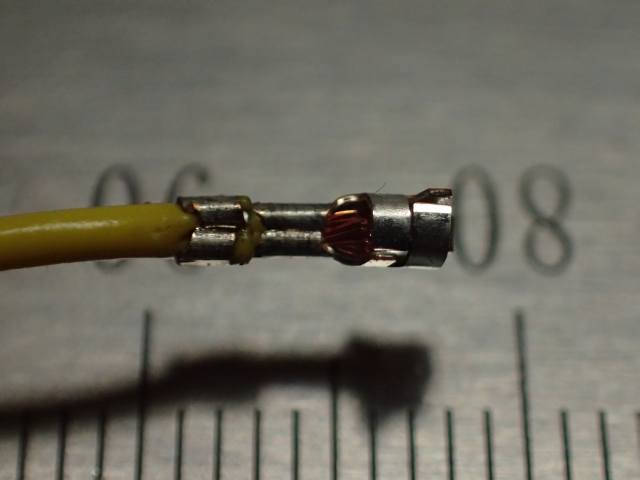

I 'think' I found economical crimpper plier to these pins....let's see when it arrives. Really starting to like these JST connectors.
Got this plier home and it seems to work, first one I stripped too long.
http://www.ebay.com/itm/321383053381

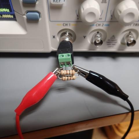

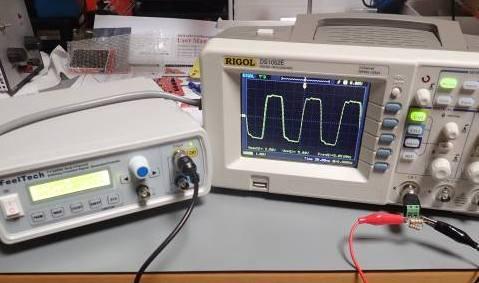

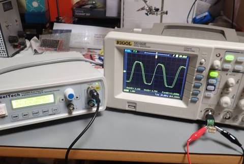

And got cheap signal geneator up to 24MHz to check if the connectors/cables/termations are any good for the speed.
Since I don't have BNC-T (for termination) and BNC/BNC straight cables I gobled up BNC/terminal to two 100ohm 2W power resistors....some inductance for sure....That should be good up to few MHz.
Now: Never have done any BNC cables and all seem to have crimp connections. Should I have buy cables readily terminated and cut them if shorter pieces are needed?
Where to buy few 50 ohm BNC cables to hook up signal generator/Scope and measurement rig?

There are a few screw together BNC cable options. They're not as robust as a crimp though...
Re: What leads and probes you use and where to get them.
« Reply #13 on: February 28, 2016, 09:44:12 AM »
Like some F-connectors? Novel.
I bought some readymade 50 ohm BNC/BNC cables, terminators and BNC-T:s just need to wait them to arrive and then I can test if the chinese ones I got are 50 ohm or something else.
