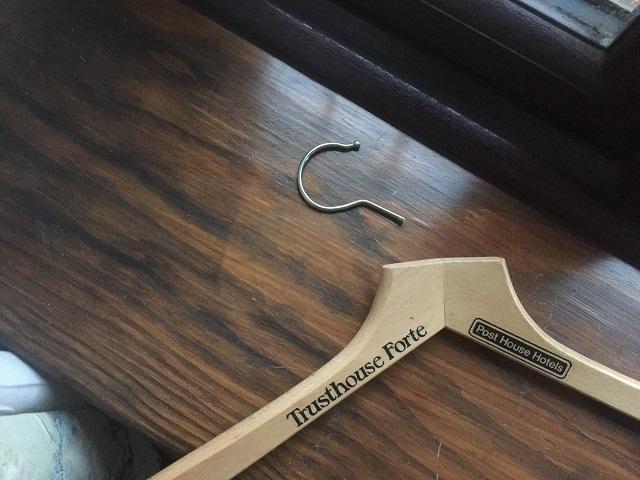

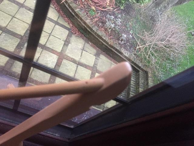

A few months back I decided that I was running out of decent coat hangers with bars. Years back I had bought a whole load of ex Trusthouse Forte hotel ones, but gradually they've broken - usually with the hook bit shearing off as it wasn't designed to rotate.

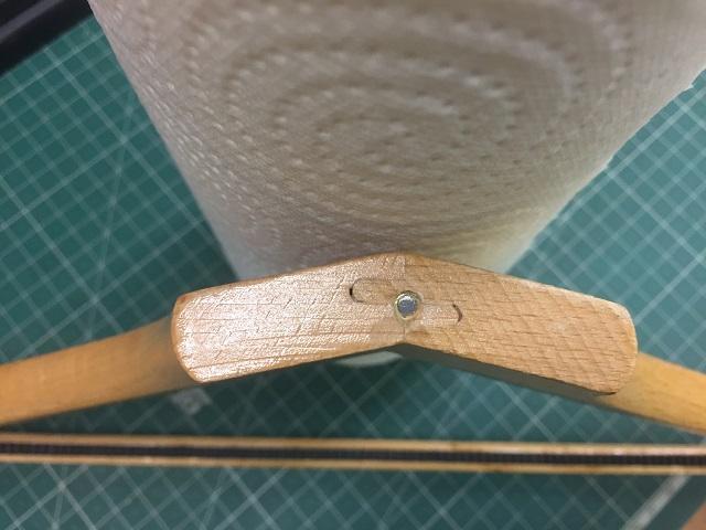

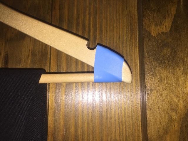

So I bought 40 on ebay - they seemed quite good quality, with shaped backs, rather than the slab sided one that a lot are, and they were cheap as chips. Now it turns out that the way the trouser bar is fitted is rather crude. Rather than being let into the coat part and then pinned, it is just pinned, so gradually the pin works loose and your trousers end up in a heap on the wardrobe floor  :bugeye:
This calls for a modification  :ddb:
A simple bit of heat shrink sleeving over the join solves the issue  :thumbup:

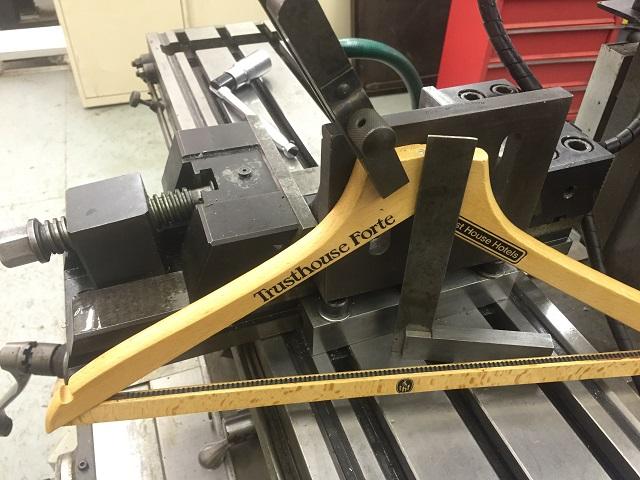

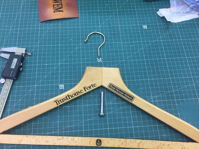

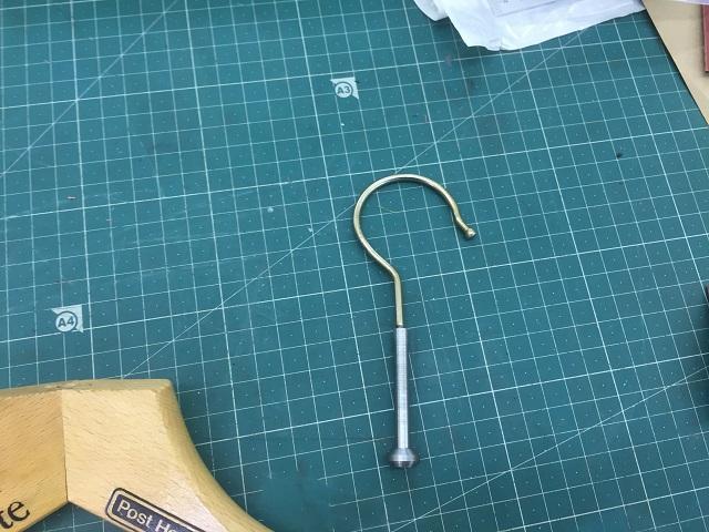

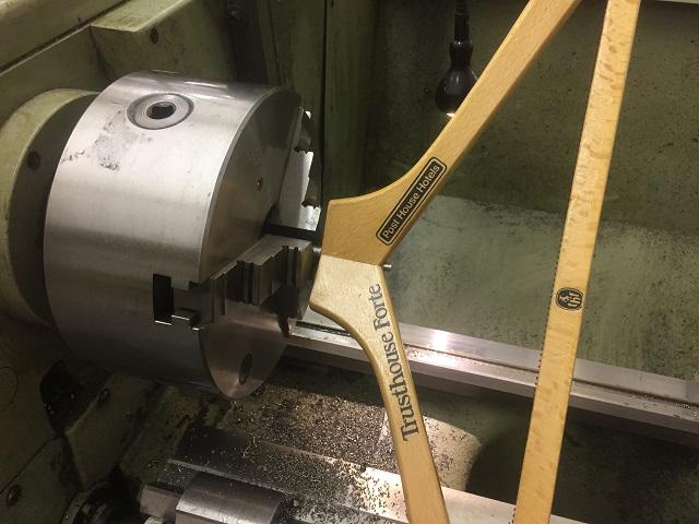

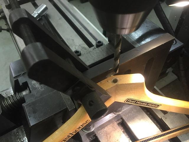

The plan:

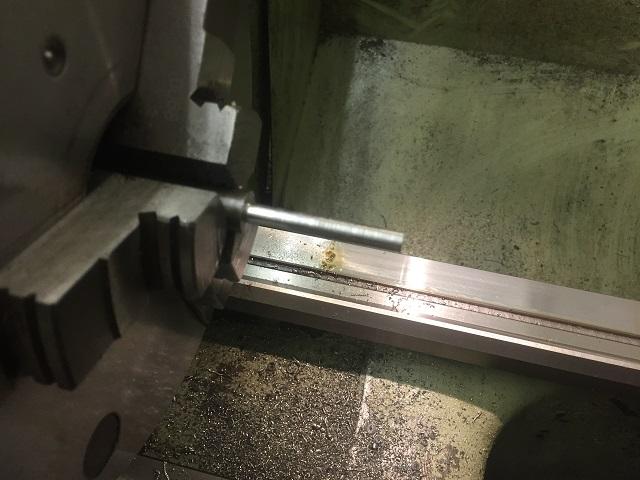

Bore out the broken end of the hook, that was originally just screwed into the wood, having a wood screw form on the end which had sheered off. Then make an adaptor to slide in upwards, drilled and tapped to accept the end of the original hook, that had had a male thread cut on it.

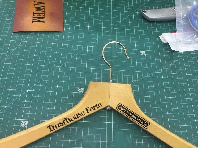

Conveniently the hook was bent from 1/8" material, So the wood was bored out 1/4" (fixturing was fun !) and the 1/8" Whitworth threading gear located, an adaptor turned up out of a scrap of steel and all glued together with loctite high strength retainer
« Last Edit: December 27, 2015, 12:20:30 PM by awemawson »
Re: Coat-Hangers - Don't You Love 'em
« Reply #3 on: December 27, 2015, 11:57:22 AM »
So there you have it - one of those silly little projects that aren't really worth doing but get done it the quiet time between Christmas and the New Year - and at least now the hook will rotate  :thumbup:
