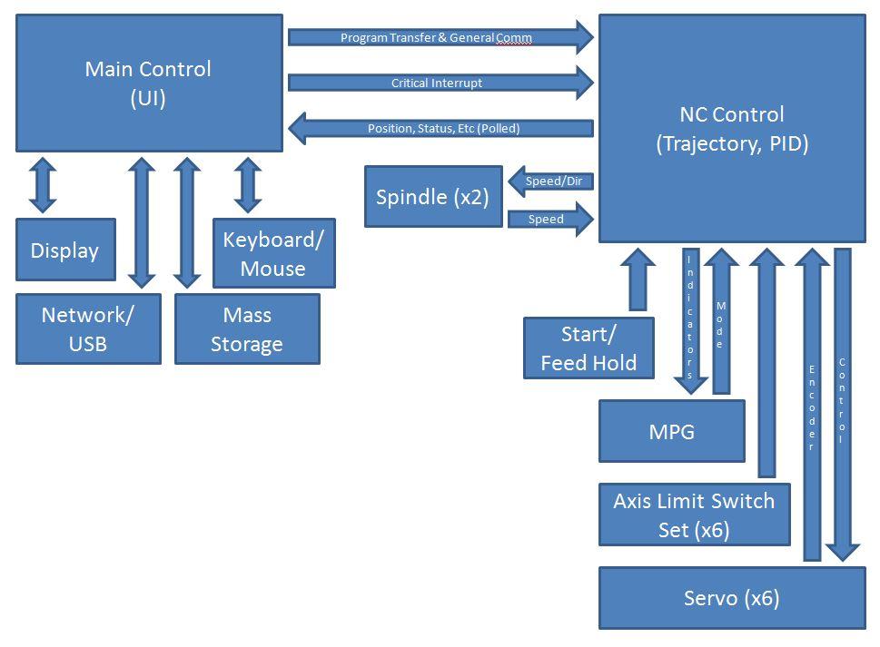

Motion control has always been of great interest to me.  The one question I've never been able to find an answer to though is exactly how multiple axes are synchronized in a motion controller.
Let's say we have a typical 3-axis machine and we're performing linear motion combining all 3.  Does one central controller dynamically figure out the position of each axis in tiny steps, commanding them to each of those steps as time moves on?  Or is there a way to "queue" the motion of each axis then tell them all to "go" at the same time.
Perhaps a naive question, but I think I've always been attempting the latter and I've begun to think it may be the wrong way to approach the problem.
I'd appreciate well-documented code examples, technical papers on the subject, or first hand experiences.

Any suggestions for a development environment for my next creative push?  My current thought is to divide the system into 2 processors.
The first doesn't have any timing critical responsibilities and would handle all the mundane stuff like user IO, display, external communication, storage, etc.  A high powered off-the shelf solution like Raspberry/Banana Pi or maybe an Arduino SBC would be cost effective and well suited.
For the second one the choice is a bit harder.  I'm thinking 200+ MHz clock speed to get the kind of cycle times I'll need for very fine-grain control of motion.  It will need to be all from scratch or run a good RTOS - no fancy operating systems using up cycles on this one.  IO will be quite extensive with an estimated 100 digital I/O pins, though not all of them are time critical.  Some sort of simple MUX or BUS could be devised for the slow signals.  I'd prefer, however, to limit external components even if this means overkill on the processor.
Characteristics that could sway me toward a particular uC or board:
- Motorola/Freescale architecture (familiarity)
- Arduino (slight familiarity, ubiquity - seems to be all the rage, but for how long?)
- Hardware quadrature decoders
- Hardware PWM or D/A
- Existing reference designs
I'm using 6 axes as a basis for design but I'd be very pleased if I were to have success with 3 and thrilled with full coordinated motion of 4 axes.  That's going to be how I proceed with the software/firmware but I'd rather not have the hardware impede future development.  On the same note by the time I get to that point there's going to be much better hardware around so I might just ignore the other axes.  Oh, and really - who the heck has a 6 axis machine to play with?
Working block diagram attached.  Did I miss anything obvious?

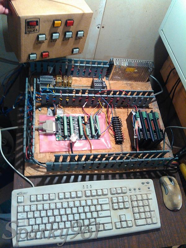

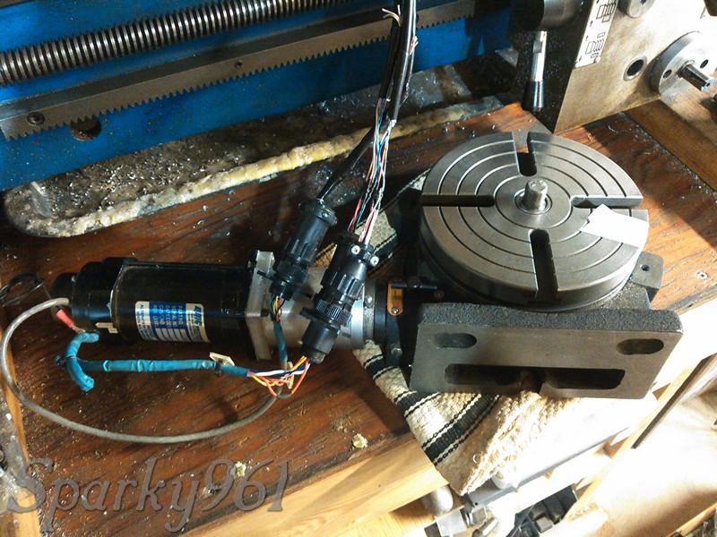

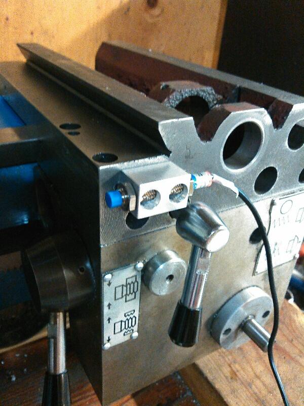

A bit of a bump and status update to this thread....
The guys over at the LinuxCNC Forum have been instrumental in helping to get things up and running quickly.  I've been happily surprised by their willingness, patience and thoroughness to help out with what must sometimes be frustrating "noob" questions.
I've attached two pictures below showing the current state of things.  Don't laugh!  Well, ok... go ahead.  Every time I look at my cardboard box control panel I think of the magical adventures that were spawned by the arrival of a new kitchen appliance - or rather, the box it arrived in.
This is a prototyping stage, so it's all good.    I want to keep things neat and tidy enough to work on it without frustration, but without getting too wrapped up in organization, planning, and looks.
Current status is that I have a single axis machine (Rotary "A" axis) with working MPG/pendant.  Just this evening I wired up physical power and e-stop circuits and associated relays.  LinuxCNC is also aware of the status of the latter.
I have a lot more wiring to run for the remaining 3 axes, their limit switches (which I'm impatiently waiting to receive from China), and remaining buttons on the control panel.  After all 4 axes and the control panel works the way I want, I'll be transferring everything to a custom sheet metal enclosure.  I think that would complete what I previously referred to as STAGE 1.

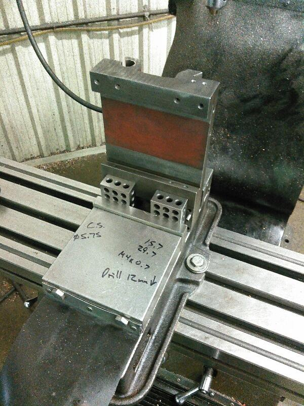

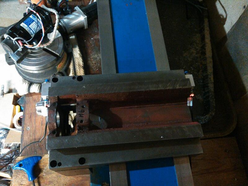

A surprising amount of time has been spent thinking about mounting limit switches and wiring management. There's a lot more to go but now that my sensors finally arrived I spent a bit of time designing and building brackets for the Y axis. Attached photos and simple drawing. Sensor is M8 inductive proxy.
While at it I also drilled and tapped holes both for the sensors and "flags" that will actuate the X axis sensors later on.
