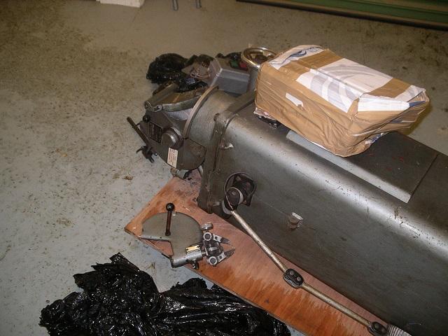

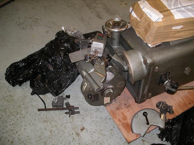

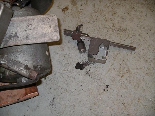

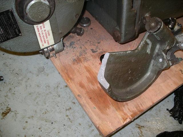

Several years ago (2009) I bought a very nice Dormer 108 drill grinder, complete with it's mounting cupboard / plinth thingy. All in very nice 'ready to work' condition. Purchase included delivery at seller risk.
This is what arrived
Re: Dormer 108 Drill Grinder Resurrection
« Reply #1 on: December 06, 2015, 09:22:24 AM »
All very annoying as I had work for it to do. Seller had literally lain it on a home made pallet and put a bit of plastic 'pallet wrap' round it, and it had been smashed to pieces in the pallet handling system. Not the carriers fault, and the seller did the decent thing and refunded and dragged the carcass away.

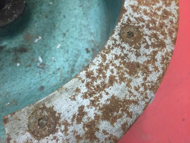

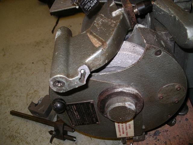

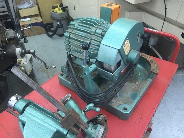

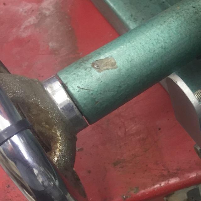

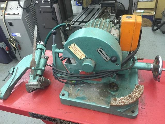

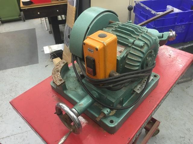

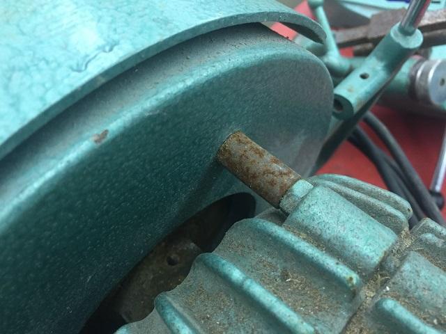

Now having dug deeply into the container, the crate with the Dormer 108 Drill Sharpener came to light - I'd been wanting to get it out but it wasn't easy with all the other stuff in the way.
It's suffered a bit from storage, with evidence of condensation rust on the bare metal, but I think that it is eminently recoverable, so that is what I intend to do.
Great shame I didn't retain the broken one as the plinth would have been handy as probably would a few other bits, but the insurers wanted it all back for inspection.
So this is how the second one came out of it's coffin after six years:
« Reply #3 on: December 06, 2015, 09:37:07 AM »
Shame, as a quick spray with Shell Ensis before I put it in the container would have stopped all that, but we are where we are  :bang:
It's mainly superficial rust - not like the rusticles on the Titanic  :clap:

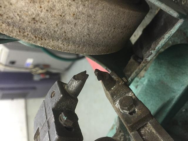

Rather than a chuck, it uses 'fingers' to hold in the flutes of the drill close to he cutting edge, and either a male or female centre for the other end.

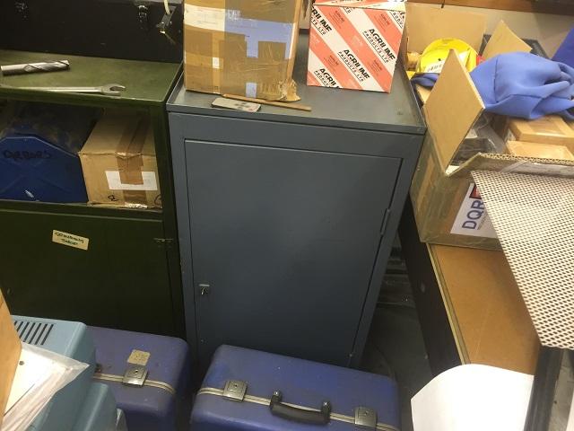

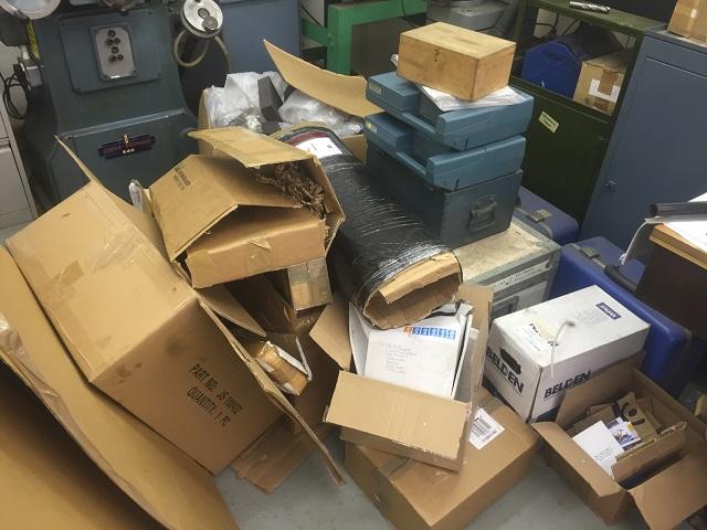

I have a machinists cabinet that I will probably mount it on, but it'll need putting on castors, and it's current contents redeploying. However I can't get at it at the moment as there is a mountain of cardboard packing waiting for the next bonfire  :scratch:
This probably will be a slow project as it's not top priority - one I'll dip back into several time over quite a period, as I've a few things on the go at the moment  :bugeye:

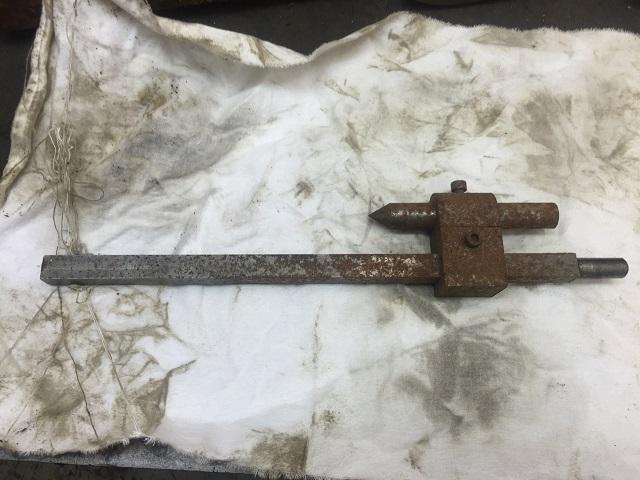

« Reply #5 on: December 10, 2015, 02:48:43 PM »
A little bit of progress:

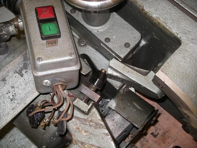

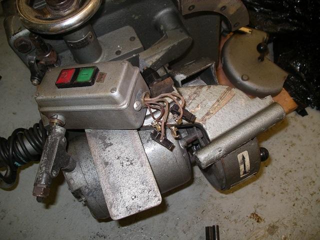

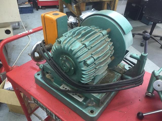

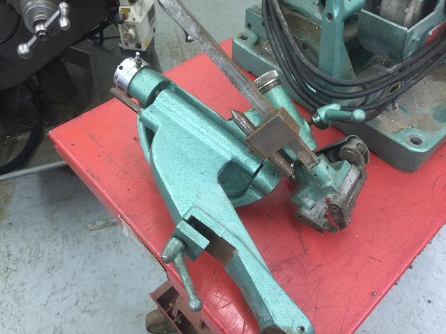

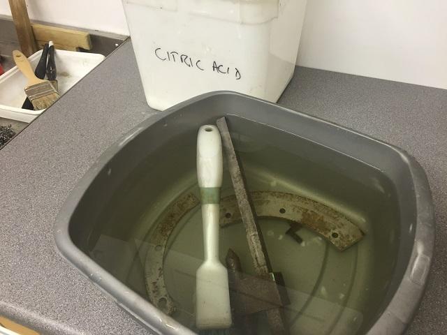

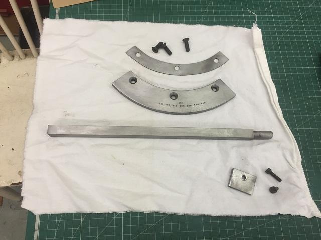

I put a plug on the three phase motor and proved that it did at least work, as that's rather fundamental to this machine. Then I found a diamond wheel dresser and installed it in the swing across dresser holder, and dressed the considerable dishing from the wheel periphery.

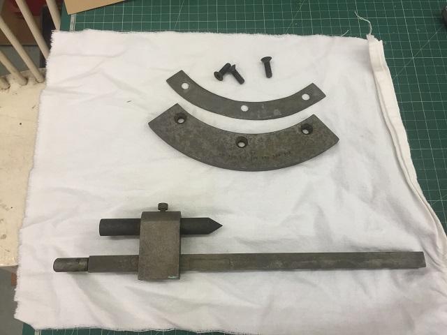

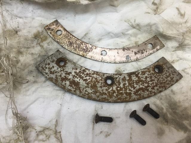

So now having decided it was worth carrying on restoring the machine, I started the de-rusting process. I removed the square bar that holds a sliding double ended centre. One end is male, and the other female. They were too rusted to dismantle without doing further damage, so they got dunked in the ubiquitous citric acid bath to clean up. Whilst this was happening I removed the quadrant that is used to set the drill point angle, and that also went in with the other bits.
« Last Edit: December 10, 2015, 03:15:11 PM by awemawson »
« Reply #6 on: December 10, 2015, 02:51:32 PM »

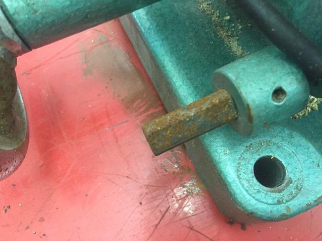

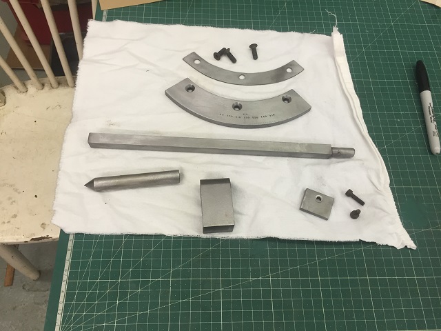

A couple of hours later they came out like this
« Reply #7 on: December 10, 2015, 02:57:20 PM »

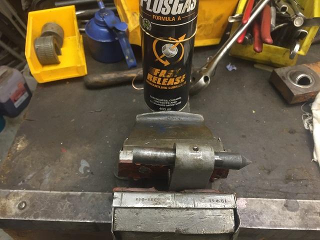

This let me start to dismantle the square bar assembly without damaging things - it came apart easily except for the male / female centre.
Soaking with 'Plus Gas' followed by thumping with a block of lead eventually released it. Obviously the female centre has vanishingly thin edges and the male has a similarly delicate point, so it could only be thumped with something soft. It did come out, the only damage being to my thumb that leaked an enormous amount of blood  :bugeye:

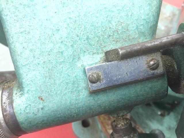

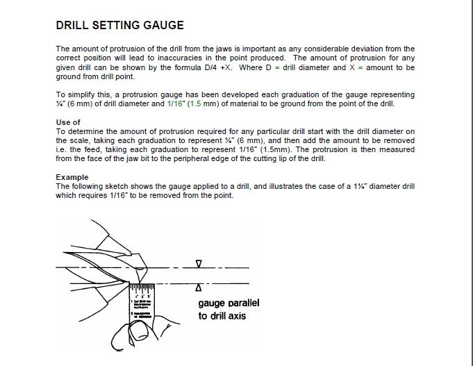

Turns out that there is a firm still stocking some spares for this machine. I thing that I needed was a 'drill protrusion gauge' - only a little rule giving the amount that a drill has to protrude from the holder to get the correct geometry - simple but essential so I've ordered one.
They also had a reasonable copy of the manual. Although I had one with the machine, mine was a photocopy of a photocopy made on a wet day in the middle of  a flood, and not much was legible, whereas their one had been cleaned up and re-typed by a nice girl call Claire who had not only photoshopped the parts drawing, but also let me chat her up into discounting their price from atrocious, down to just about manageable  :lol:

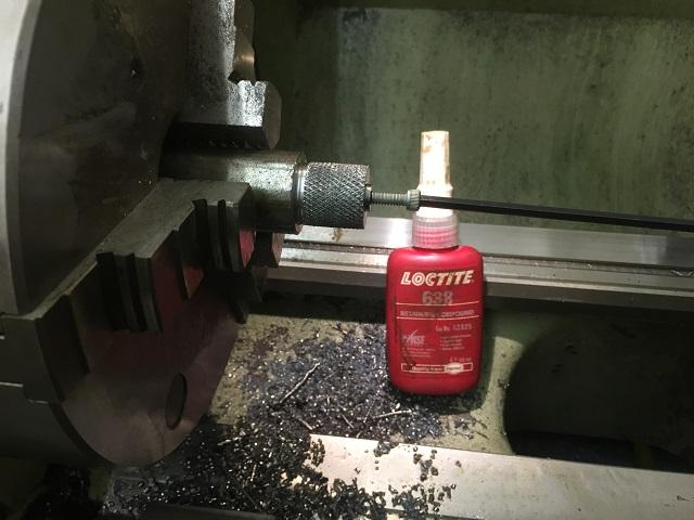

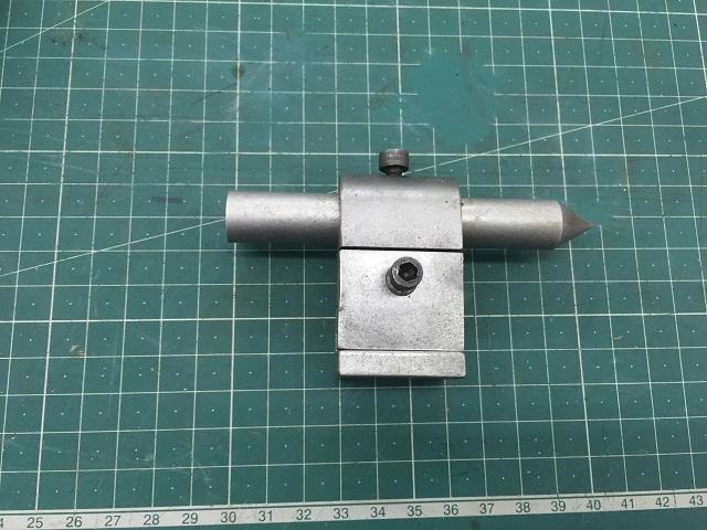

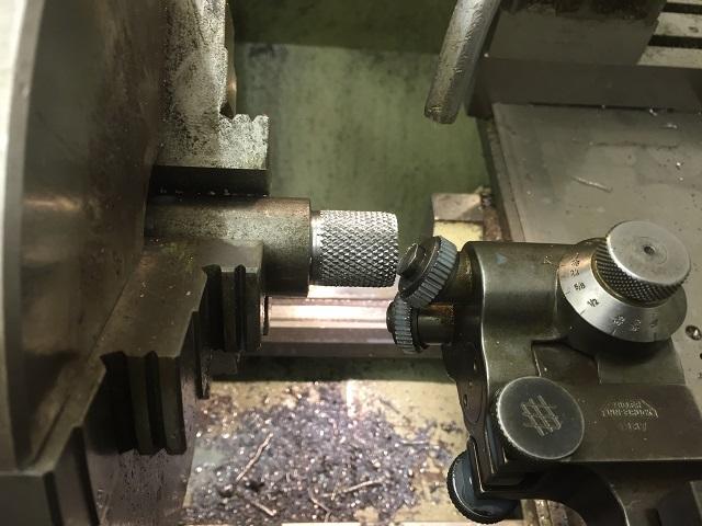

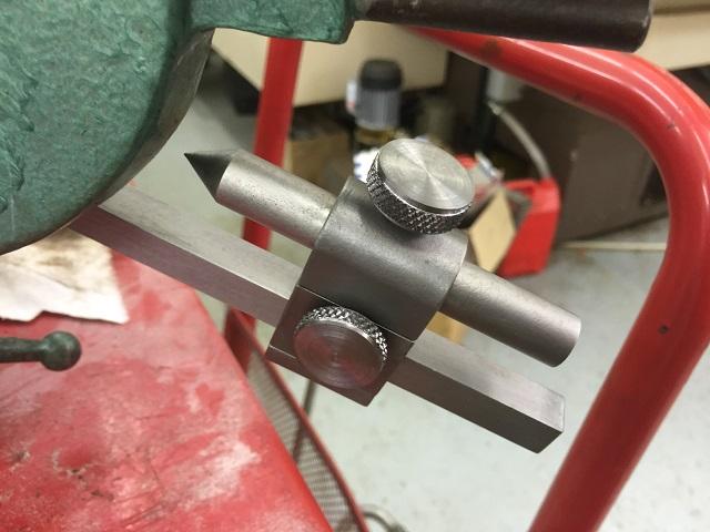

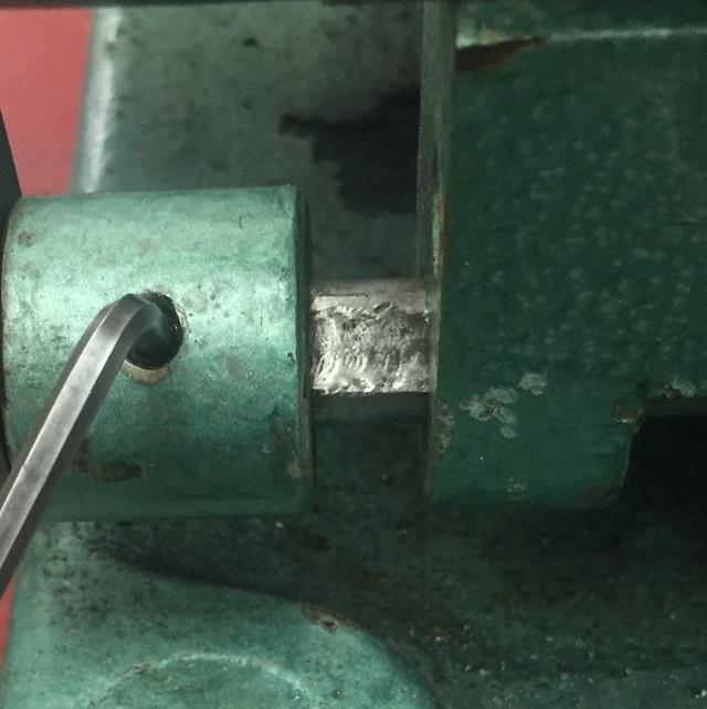

Well that gauge still hasn't arrived, but I've been playing a bit - I've even successfully sharpened a 9 mm drill  :ddb:
However, the protrusion of the drill, which is what the gauge is for, is set by moving the 'tailstock' in or out along a square bar, and it's ever so fiddly as the clamping is with a hex key, and you run out of hands  :bugeye:
So I decided to make some knurled clamping screws this morning which have made the setting up far easier. Simple turning and knurling exercise - I 'loctited' screws into blind tapped holes, then parted the screw head off. I'd really have wished to use brass for the one that bears directly on the male / female centre but nowhere could I find a 2 BA brass screw of suitable length, and I was too lazy to thread a bit of brass!
 I think long term I'm going to make some form of screw advance for the tailstock, as it's not the most subtle of adjustments as it is.

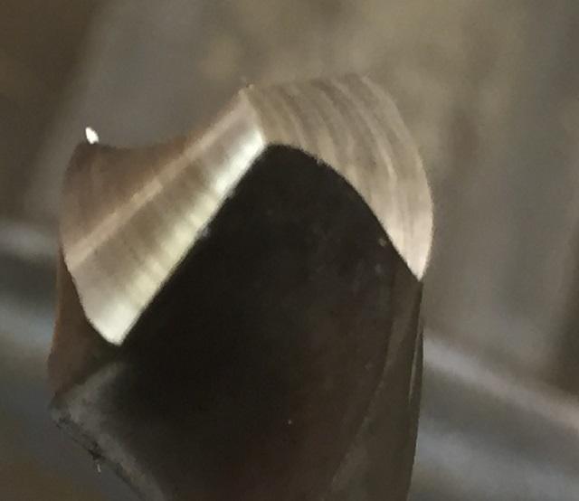

« Reply #12 on: December 13, 2015, 10:13:09 AM »

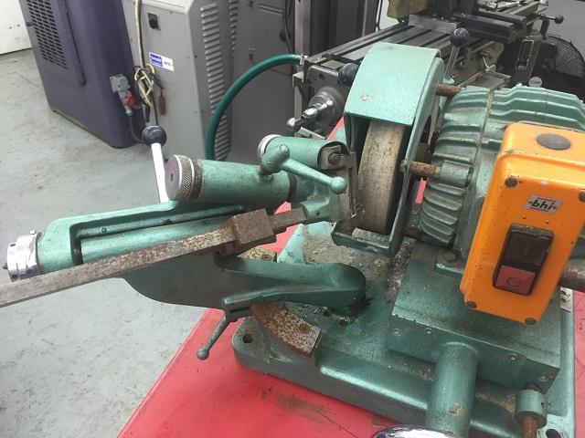

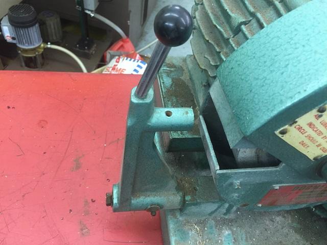

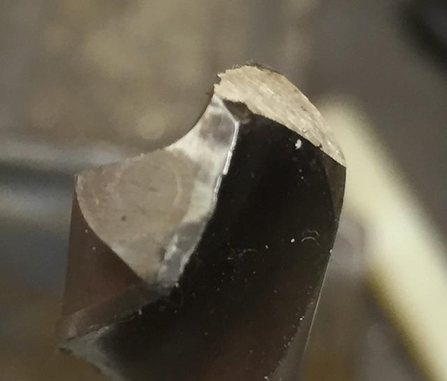

Seems to work - this is an abused 13 mm drill I just put through the machine. I still need to experiment with web thinning, chisel angles, and varying the relief.

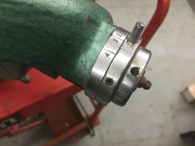

To operate this grinder, the drill is clamped between jaws, a calculated amount ground off, then the wheel is backed off to let you remove the drill, rotate it 180 degrees, then grind to the same point on this second flank.
To do this reasonably accurately there is a 'stop collar' that can be clamped to physically stop the movement at a particular point, however it's very hard to not over run as the feed handle has much mechanical advantage so it can slide the collar - certainly not precise enough in my opinion.
In the later model the feed handle had a 'friction fit' collar carrying a pointer that could be rotated to show zero, and give you a positive indication that you were where you want to be. No such collar and fidicule line on this one.
« Last Edit: December 15, 2015, 10:22:31 AM by awemawson »

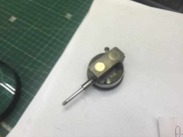

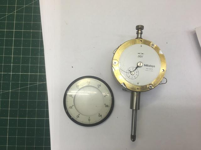

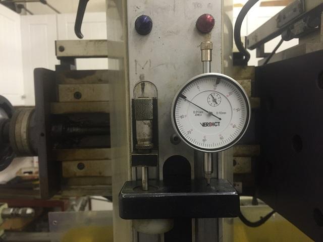

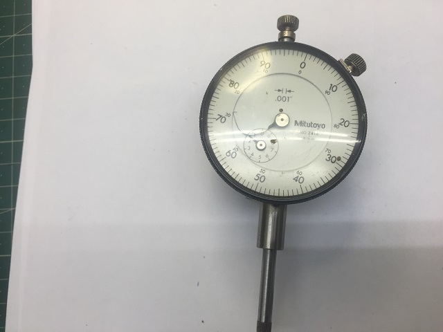

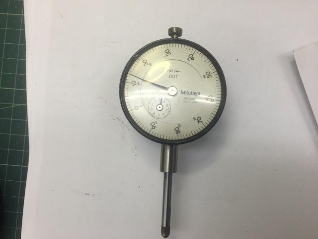

I may well modify the machine along those lines in the future, but as a test I decided to rig a dial gauge up to show me when I'd 'arrived'

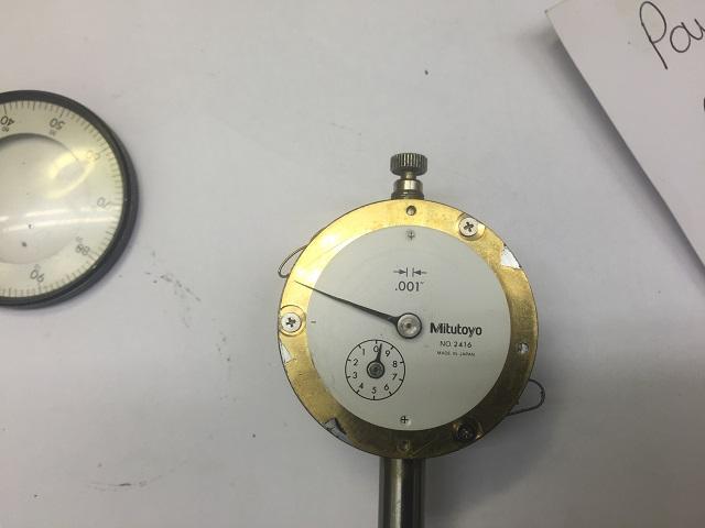

I have had a magnetically mounted Mitutoyo one that I rescued from an EDM machine I pillaged for spares - it was used to show cutting progress like this one on my own EDM machine, but it was in a sorry state, with a bent needle
« Reply #15 on: December 15, 2015, 10:18:00 AM »

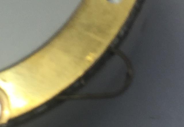

Now as Bob KRV3000 wasn't actually locked in a cupboard in the workshop I had to 'have at it' myself, and try and bend it back to a semblance of straightness  :lol:
So, remove the bezel (retained by spring clips), gently bend the needle with very fine pointed tweezers, and put it back together. I was scared that I was going to break the needle if I fiddled too much, so got it 'reasonably straight' but not perfect

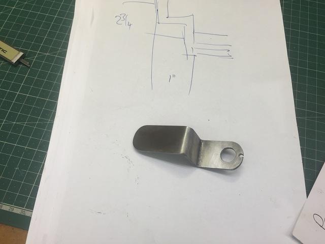

So now back to the drill sharpener  :ddb:

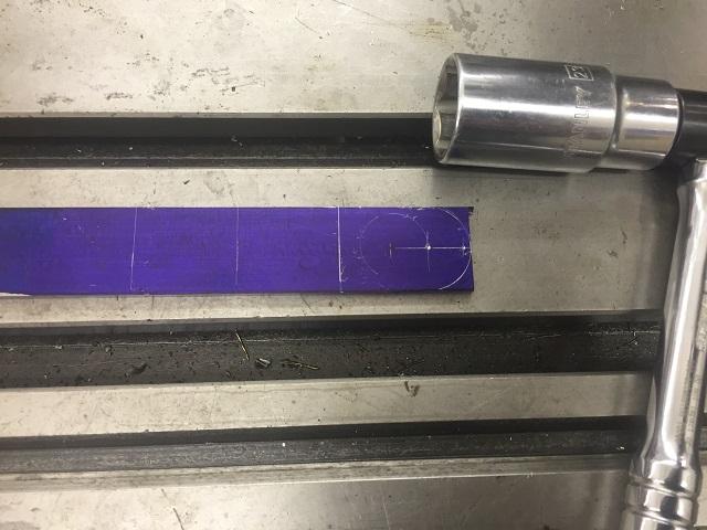

Needed an offset bracket to fix on the original 'stop collar' to act as a target for the dial gauge to press against. So a bit of layout blue, drilling, bending and tapping and here she is
« Reply #17 on: December 15, 2015, 10:21:51 AM »
It actually works rather well, and gives much more confidence that both flanks are being ground to the same position.
