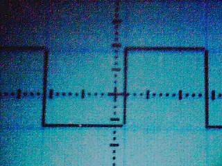

tried  the DSO138 power supply mod
with firmware 113-13801 -050 you don't get an improvement
unlike that as described at -
http://forum.banggood.com/forum-topic-61279.html
for the early version that's cloned using FW  113-13801-040
managed to buy 6 AA nicads for the Velleman K7105 'scope I built back in 2002
with no back light , the picture showing the trace of the test signal from the DSO138 is not great but shows the trace for comparison

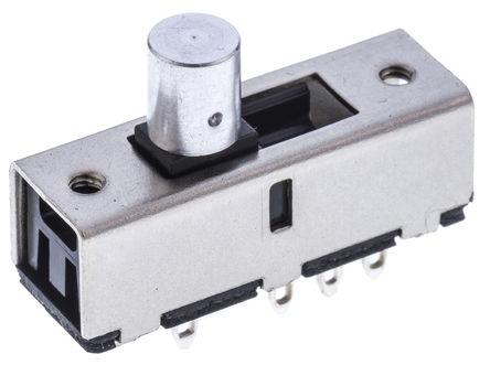

RS Components do a slide switch that could be OK to mount onto a new front panel
 thought the 2 slide switches (sen1 & sen2)could be replaced by 1 rotary switch
but the rotary 4  pole 9 way switches I've found so far are several times more than the cost of the kit !

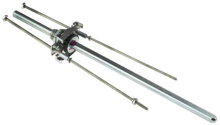

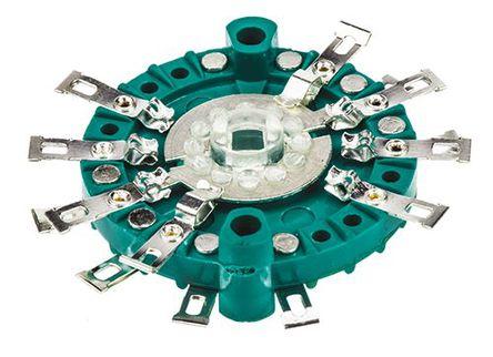

twice I have resorted to making a custom switch using parts from RS Components
http://uk.rs-online.com/web/p/rotary-switch-shaft-assemblies/0327894/
plus
http://uk.rs-online.com/web/p/rotary-switches/0352193/?origin=PSF_428206|acc
or
http://uk.rs-online.com/web/p/rotary-switches/0352222/?origin=PSF_428206|acc
  an expensive solution , but it worked

Those "Wafers" are not silly money, but shaft and rest of it will add up. But they are higher voltage and probably lower capasitance etc.
