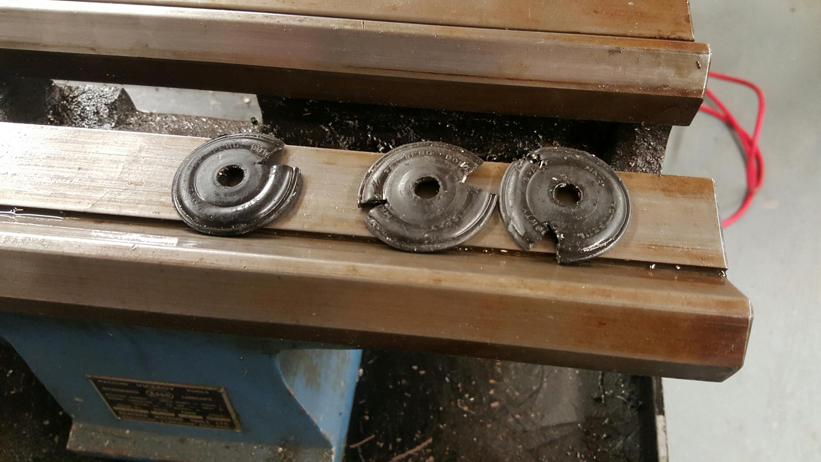

I'm trying to level (untwist) the bed on my Denford Viceroy lathe, but it turns out there are no leveling screws underneath the bed!
It's cutting quite a larger taper when I chucked up a 75mm x 200mm aluminum test bar. I haven't checked the head alignment but as I know the bed was removed from the cabinet by the previous owner, I'm assuming it's a twisted bed.
I lifted the bed off the steel cabinet today and found it was simply bolted down, one bolt in each corner, passing through a clearance hole in the chip pan. One of the bolts was missing altogether.
This is actually the second Viceroy I've owned and the previous one had a double-threaded widget in each corner which you used to jack the bed up and down.
Any idea what gives here? It looks to me like it was this way from the factory, because the chip pan holes aren't threaded. Should I just resort to using shims under one corner? Any idea why there are no leveling bolts?
Would appreciate any advice, would like to get this thing cutting straighter.
Here's the rubber washers which were squished between the chip pan and the bed:-

No help for the twisting issue but those 'squished' washers look to me like those used to seal the heads of the nails used to secure corrugated iron or asbestos roofing sheets.

Is it possible that the rubber washers were intended to do the job - just squash as required?  Having said that I think that would be a lousy idea.
I'm not sure I understand about the number of mounting feet.  Surely a single mount at the tailstock end would mean that you can't adjust for twist anyway.
If you can I think the first thing to try would be bolting it down solidly at the headstock end and see how it sits at the tailstock - can you get a feeler gauge in?  Can you raise a corner of the cabinet and does that make a difference?

That's exactly what the washers are - they're made by 'SPAT' according to the text imprinted on them, Googling for that reveals they're usually used for roofing.
My thinking is that only one corner really needs a leveling screw - 3 points will always make a flat plane, so just one corner should need adjusting in theory (like putting a beer mat under the one wobbly corner of a table). Just need to find which one it is.
For what it's worth though I think I'm just going to make 4 - I'm going to drill & tap the chip pan M16 and make some hollow M16 widgets through which I can bolt the thing. Then by screwing the M16 thing up or down I'm jacking the lathe up or down from the chip pan. This is what is per the drawings/manuals for the lathe.
I would assume the leveling screws have simply been lost but the fact that the chip pan isn't threaded seems to preclude that, I guess for whatever reason they just stopped fitting these at the factory. Seems surprising but also seems the only possibility.

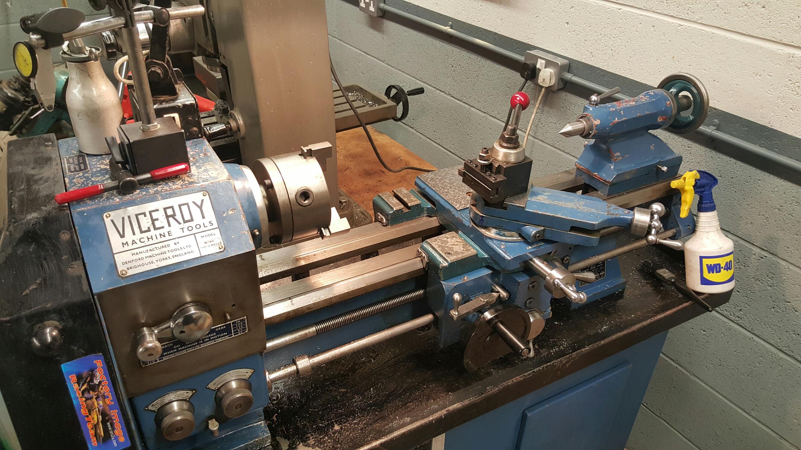

I got the precision level out today and checked the bed properly, it was twisted when bolted down just fingertight, with the tailstock end being I think about 0.3mm/m higher on the operator side.
Turns out I could undo this twist simply by tightening the bolts different amounts, so perhaps I don't need any adjuster screws after all! I think the sheet metal chip pan not being flat means it kind of acts like a spring.
The rest of the lathe is in bits so I can't check the headstock alignment at the moment.

Sorry about the confusion, the headstock has never been removed as far as I know, I just said that the bed had been removed from the steel stand.
The headstock is bolted down onto the bed with 4 cap screws which you can access via the rear cover, on my old Viceroy there were then two taper pins hammered in, on my new one there is a bar bolted across the bedways in front of the headstock, plus there appears to be some kind of tight fitting key between the headstock and the bed at the rear end too.
I'm rebuilding the whole lathe at present & servicing all parts, once it's back up and running I'll take another test cut and check the head alignment.

Well I finally finished rebuilding this lathe - fitted a new motor, all new electrics, replaced the gear head with a direct belt drive + VFD, added a lamp, hand scraped the saddle and compound, generally took every single thing apart and cleaned/lubed/rebuilt as required.
Lathe is turning really nicely but sadly is cutting a taper of 0.01mm per 25mm, ie half a thou per inch. Bit more than I hoped for! My last Viceroy lathe cut 0.00mm per 6 inches...
I tested this with a 7 inch length of 3 inch aluminum turned down in the 3 jaw. Pretty sure it's head alignment rather than bed wear or suchlike as the taper is so linear.
Maybe one day I will remove the head and rescrape/adjust to get it better. Will begrudgingly accept it for now!
