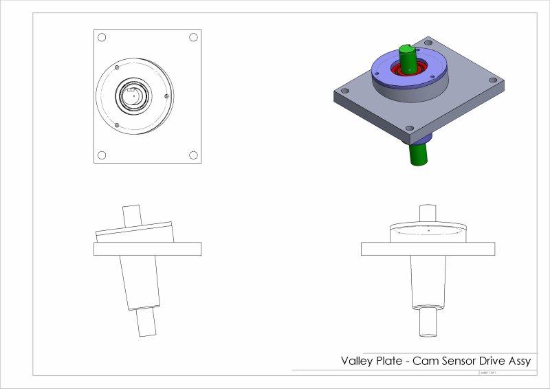

Problem: I am making a new "valley plate" for my Jaguar V12. I want to use the distributor drive to give me an accurate engine position reference for the ECU. I can't easily use the original valley plate, because I'm also mounting 12 coils onto it, and headroom is an issue.
Here's the original distributor mounting plate:
The inner hole is 40mm (maybe a shiver less), the recess takes a rubber seal, and the rest of the plate is a reference surface for the bottom of the distributor to sit on.
What's not obvious from the photo is, the plate is at an angle with respect to the mounting face, of 6 degrees. Fortunately it's only off-horizontal in one plane... otherwise I'd be in serious doo-doo... Anyway, this is the underside in case it's useful:
The flat bits are my horizontal reference.
So... what I need to do, is accurately locate the hole in my replacement valley plate, at the same angle, but I'm not sure how to do it...
My thought so far is: Turn a bar to a sliver under 40mm (the original dizzy drive is 39.80mm by the digi calipers, I've not broken out the micrometer yet). Turn a point on the bar, so effectively a fat dead centre.
Next, mark up the plate with some micrometer blue, and clamp to a piece of cardboard. Smear a little micrometer blue on the point of my "dead centre", and push it through the hole, until it contacts the cardboard (leaving, one hopes, a tiny blue dot). Remove & unclamp. Measure from blue dot to edge of casting using a digivern. That should give me the exact centre point of the circle at the base line of the valley plate. When it comes to milling out, I should be able to centre-punch the bottom of the plate, set my angle plate up to 6 degrees, use a pointy centre finder to align the spinde, then using a fat end mill, mill a flat, then centre-drill, twist-drill out to as big as I can get with a twist drill, and finish off with a boring head to give me the final 40mm dimension.
Am I on the right lines there, or is there a better way? Thanks in advance!

I'm interpreting your question as: "how do I get a hole in exactly the same spot with the same angle regardless of what that angle actually is".  The "measuring" part may not actually be required if I understand correctly what you're trying to do.
This suggestion assumes you have access to a mill with a tilting head.  If not the same can be accomplished with a bit more difficulty by shimming up the work piece as has been discussed in other recent threads.  You'll be using your existing part as a setup fixture.  You need to have some references that are identical between the two (mounting holes, edges, or the like).  Set up some locating pins or stops so that you can positively remove/replace the old and new while maintaining the same position each time.
Mount the old part on the table and set the head at the correct angle to drill/bore the hole.  Make sure there's enough travel in the quill to do all of your operations without moving the knee once you begin!  Take the crank off or lock it to prevent yourself from doing something you'll regret.
Use a DTI in the spindle (or coaxial indicator) to get yourself centered on the hole in question.  The bore is pretty shallow but you should be able to verify the angle by moving the quill up and down as you sweep the indicator around the inside of the bore.  If the mounting flange is on the same axis that makes it much easier because any error will be more obvious when sweeping the indicator on it.  Get yourself as close to "0" as you're happy with - meaning the quill and your hole are on the same axis.
Replace the old part with your new part using the established references and go nuts.

Maybe I'm missing something but I think it is a very easy calculation to make provided you can measure the angle and the thickness of the existing cover accurately.
If the angle is 6 degrees and the thickness is, say, T, then the offset is T x tan6

Using the transfer punch, which someone suggested making, the centre point of the inclined hole is transferred to the top of the new plate. The new plate is positioned vertically under the original with mounting holes lined up. The centre mark produced will be offset to one edge by an amount that is the "opposite" side of a right angled triangle. The thickness of the original plate is the "adjacent" side. The measured angle we're currently assuming is 6º. Therefore, for a right angled triangle opposite/adjacent =tan 6º. This can be rewritten as Opposite=Adjacent x tan 6º
The value for the Opposite is the distance that the the centre mark must be relocated towards the middle of the new plate which then becomes the point that drilling/machining starts. This does assume that the bore of the hole is square to one of the edges. If not it becomes a little more complicated.

« Reply #19 on: November 24, 2015, 12:55:11 PM »
Just for clarity, I've thrown together a CAD representation of what I need to do. As I forgot to bring the USB stick with the plate drawings to work today... I've re-created the plate as a simple block...
Not included are the gear on the bottom of the green shaft (for that I will use the original), nor is the "cap" and single-tooth "gear" wheel shown, nor the sensor mount. I'll do those later.
For the purposes of drawing up the final valley plate, this will do me; but when it comes to making it, as has been suggested, I need to be within a gnat's pubic hair's width of exactly the right place, or it's just not going to work properly. As far as getting everything in the right place for milling the hole:
1) I'll make a jig with 2 dowel pegs & 2 screw holes in opposite corners, these will allow me to both accurately locate, and secure, either the original valley plate, or the new one, to the machine in exactly the same place.
2) Jig will be mounted to the angle plate, angle plate mounted to the machine, align jig to be parallel to table.
3) Tilt angle plate until a dial gauge run around the outer-ish edge of the dizzy mounting flange reads zero at the four compass points at least, preferably fluctuating only with the roughness of the metal. That gets me the exact angle
4) Use a concentric dial gauge (? I think that's what it's called) to centre the quill over the bore hole.
So now the quill is directly over the centre of the hole, at the exact angle needed to bore it out.
5) Switch original plate for new plate. Mill the boss flat (to make the drilling easier, but also to mount the top-hat cover)
6) Drill/bore holes as required.
