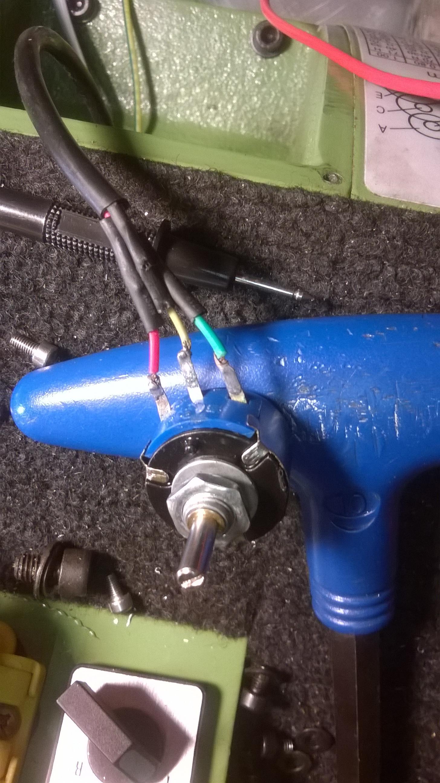

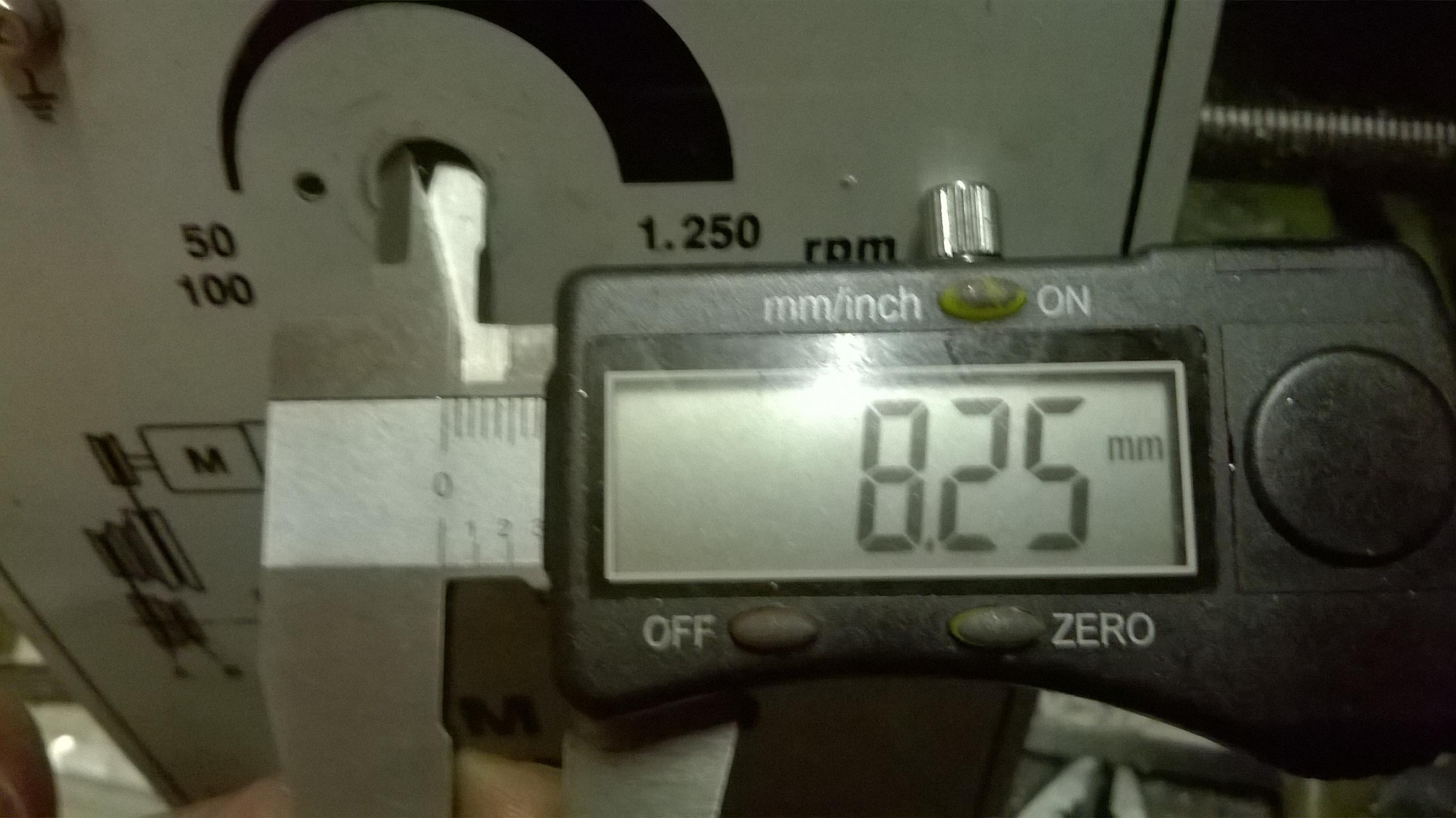

Hope I'm in the right place, it's my first post. I've got a Warco WM180 variable speed lathe and unfortunately after a year or so of very light use it has stopped working. I've traced the fault to the potentiometer (knob that changes the speed) but don't want to replace it with one from the makers, as it is Chinese electronics at their worst and the tiny little plastic lugs that keep the centre rotor in place will surely break off again. Does anyone know of a good supplier of potentiometers? short of any advice, I will call into RS components on Team Valley tomorrow to see what they have to offer.
Any help would be gratefully received.
Cheers, Griff.

« Reply #4 on: November 11, 2015, 05:22:02 AM »
Hi and thanks for replies,
Sorry I thought my location was revealed in the header on my post, I'm in Consett in the north east of England.
Its Just a simple 3 terminal pot with the on off controlled separately by the main switch.
Hope attached photos will clarify.
Cheers, Griff.

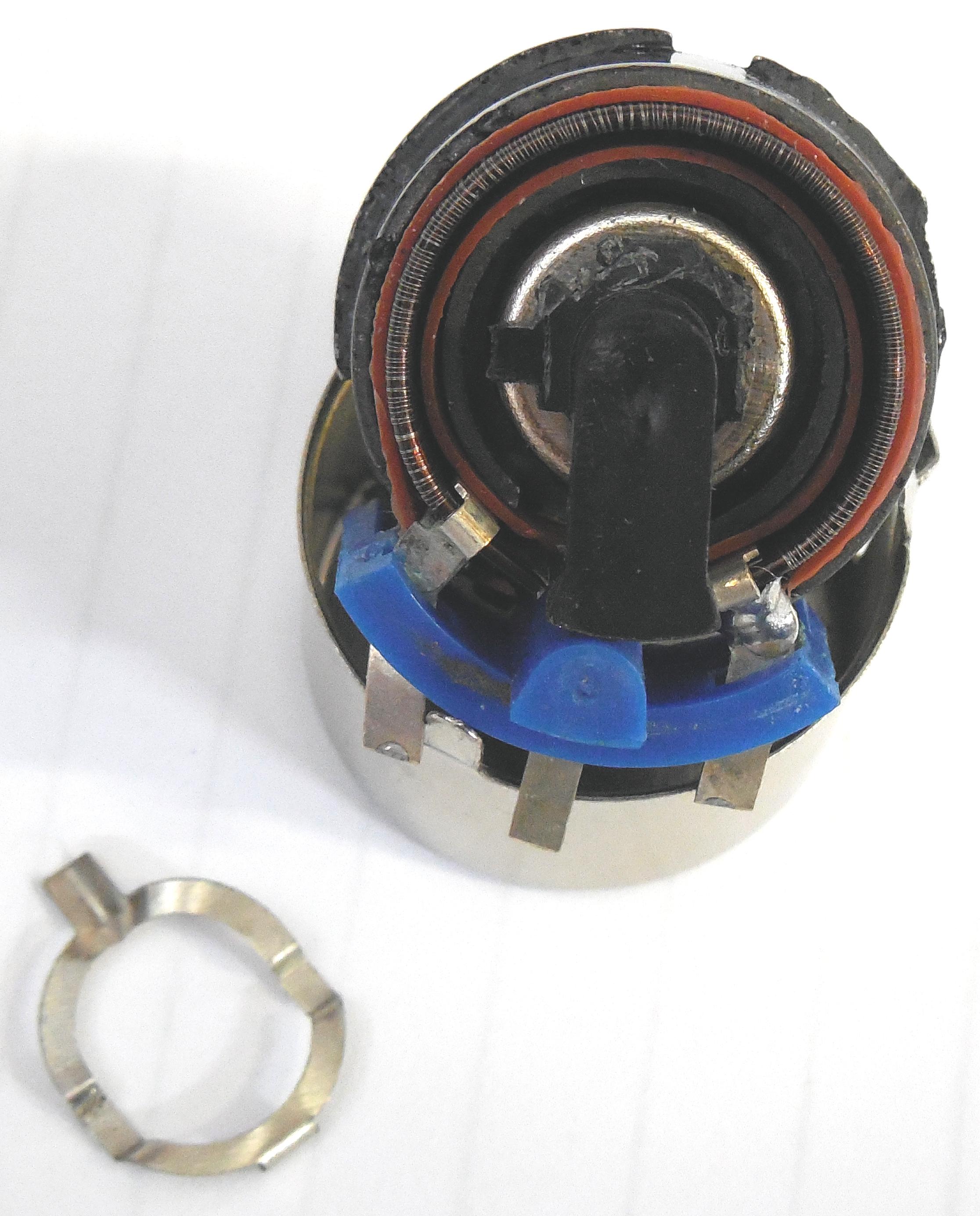

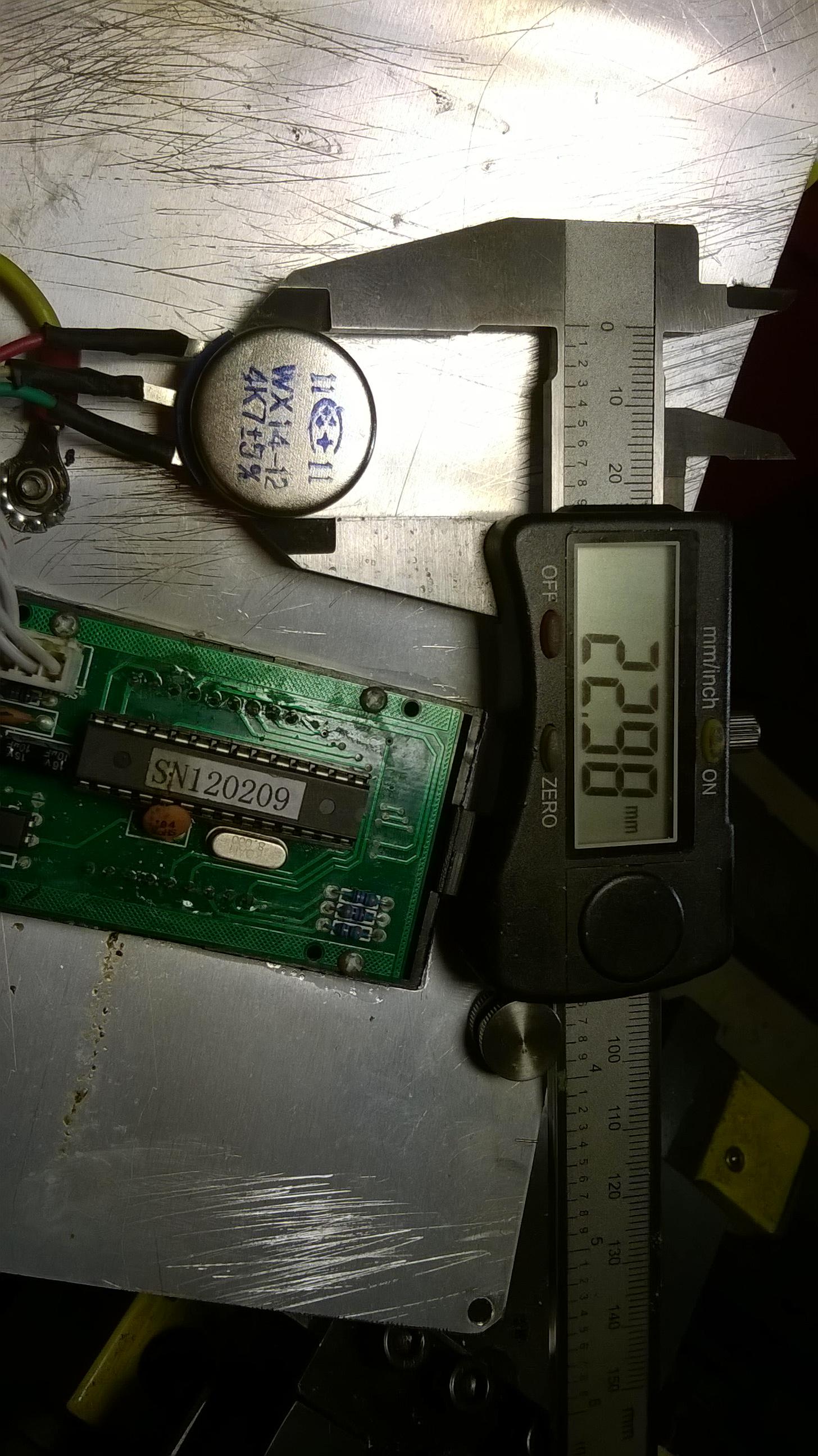

Hi John,
I've taken the back off the pot, you will see that it is wirewound and that one of the little plastic lugs, that hold the centre rota in place, has broken off. This has allowed the rota to come loose and fall out.
As requested I've also posted photos of the board as well as its label.
Cheers, Griff.

That's a REAL quality pot - so how uneven the wire winding is on the track  :lol:

« Reply #16 on: November 12, 2015, 12:58:08 PM »
Hmmm, Kbic controller...fairly reliable...
So what are the symptoms with the lathe that drew you to the pot being faulty?
Do you have a digital multimeter to fault find with?

Mmmmm, Yes I have a multi meter and the problem started quite a while ago with the lathe tripping the circuit breaker on the mains board but it only happened a handful of times and the problem stopped. Then a week or so ago the trip switch went off a couple of times when I turned the pot. After resetting the circuit breaker for the second time the lathe wouldn't work at all and the pot had fizzed a bit when it tripped out.
I checked everything with the tester and the only fault I could find was on the pot. Current was getting in but no matter where the knob was rotated there was nothing coming out! I then took the back off the pot to find one the tiny plastic lugs had broken off and the central rota had come off (with hindsight it must have been loose and occasionally touching the case causing it to trip out).
As I've mentioned in an earlier post, when I bypass the pot and connect the wires the lathe works but obviously only at one speed! This would indicate that everything else is working and reinforce the theory of the faulty pot.
I've located a couple of wirewound pots in china with the correct specifications and ordered them to try out my theory and I may try to bond the centre rota in place on its plastic carrier and rebuild the old pot as a temporary measure until the new ones arrive from china.

I rebuilt the pot with a little hot melt glue replacing the tiny plastic lug & it now functions as it should, according to the multimeter. However, as someone previously forecast, the shorting out that was part of the original problem when the pot fell apart inside, has damaged the PCB or one of the components on the control board. When I re-connected the pot & wiring the lathe works but only at one speed the equivalent of about half the max rpm, regardless of where the pot is rotated to.
Looks like I'm gonna have to bite the bullet and buy a new pot and control board from the dealers! I assume it would be cost prohibitive to have it tested and repaired professionally, unless anyone else knows better?
I will wait till the new pot comes from China first though, just in case the problem is in the old repaired pot.

Re: Warco WM180 problem
« Reply #19 on: November 14, 2015, 10:44:20 AM »
Griff,
I can repair your board if needed, or alternatively supply you with a good  tested second user one.
You need to bear in mind that where ever you source a replacement board from that:
1) you need to install the white resistor onto the replacement board( the big white resistor in the right) and
2) you will need to fine tune the board to your motor....the min/max speed accel, IR a d IC adjustments
I can give you a link to the instructions on how to do this or send a copy via email.
