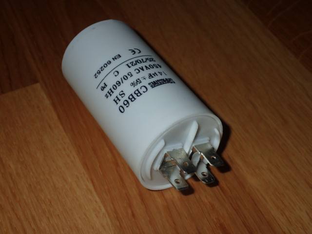

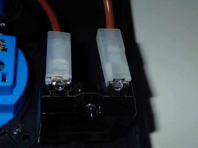

I pretty much hate normal colotful insulated Abico connectors. I have used non-isulated ones that you first crimp and then stick on connector body (1...may pins).
Now, I'm working on one project that needs motor run capacitors and other mains voltage stuff.
1) I think I should choose nickel plated contacts? Right? I think those brass color ones are for low voltage, like automotive ones.
2) Which is the "real" name for those abico looking contacts, I'll see them called "Spade" and generally 6.3*0.8 mm contact etc. but I'm having a hard time having a good hit rate with ecomerce.
3) How to pair correct plier with these? I have heard that there are no really good standards and generally they sort of work, but not always.
4) Is there a "kit" that has uninsulated contacts (female and male) and insulators for them? I have seen some automotive molex type, but they needed special plier, were expensive and that was not ofcourse compatible with single spade pins, like they are in start capacitors etc (no standard pin spacing to fit with a standard multipole contactor).
Thank you a lot. I have searching few UK and DE shops and sort of see what I need, but are they?

I think I found right plier/crimp combination. I'm still wondering pin material and plating.
Brand crimp pliers are as expensive as I remembered. From cheaper ones, I have been recommended Hanlong HT-236C
http://www.tme.eu/en/details/ht-236c/crimping-tools-for-terminals/
Anybody used that one?

Ok, just ordered pliers, terminals and connector bodies. Let's see how they work out together.
If someone has found reliable source for brand/quality terminals, please share.
