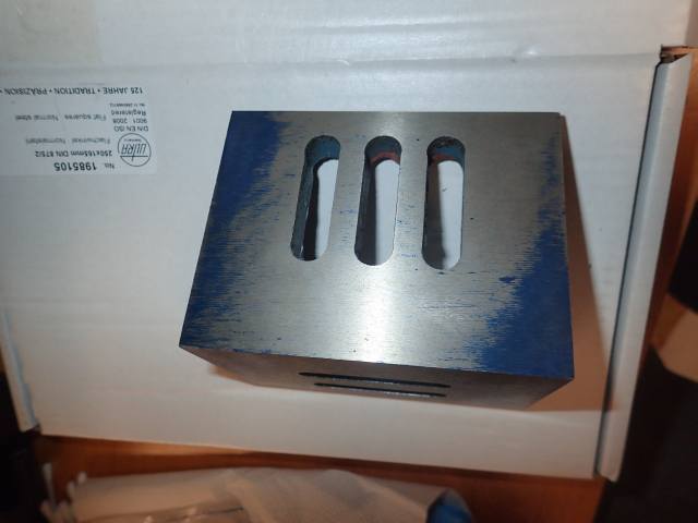

Hello,
I'm going to have a go scraping and need to proceed on baby steps, because ultmate goal is to get my old and tired milling machine closer to acpetable level than it is. Not perfect of über accurate, but closer to HMS standard.
I have a small granite surface plate and standard equuipment. So far I have used good known square and geeler gages to check other square pieces. I have also used a DTI and parallel to indicate dips and walleys.
But how do I check error on two planes that are supposed to be square to ecah others. I can spot each plane indvidually and I now that both of the planes are about 0,02 mm concave in the middle....but how to indicate which corner to scrape more to bring both planes closer to square?
Is there any other way than:
1. true DTI on master square
2. get comparison readings from the angle plate (plane that is expected to be most off)
3. Scrape offending corner down
4. Spot of flatnes and race for next offending bigger spot
5. Indicate again and cycle until "square" enough
6. Scrape flat
I don't have a master square, I have two pretty good flat squares.
This is probably a daft question, but I had pieces on small granite surface plate and was wondering "how on earth I make it sure that I know which way these planes are skewed without making assumptions I can't verify?".
« Last Edit: October 18, 2015, 01:11:47 PM by PekkaNF »

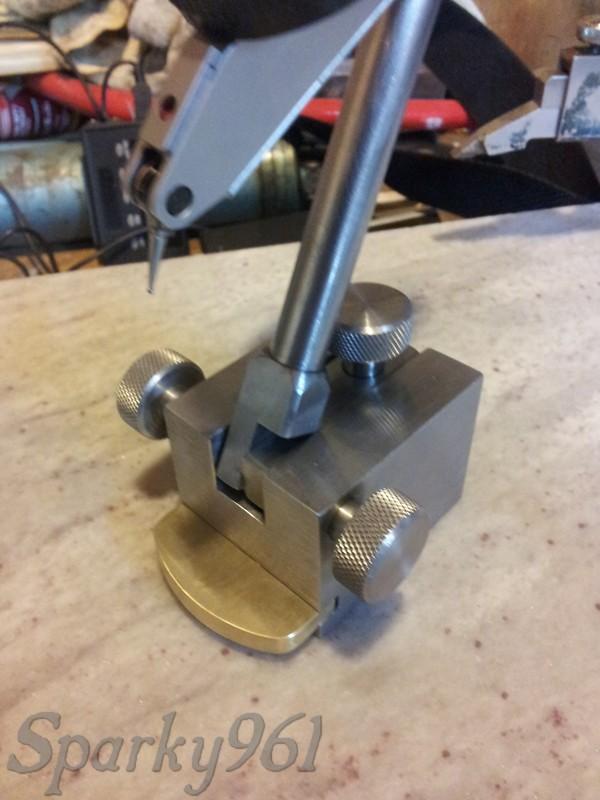

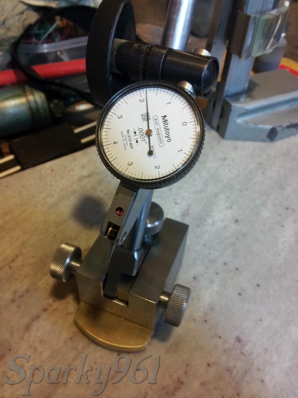

Here are some pictures of the gauge I made from scratch.  I have a SolidWorks model and dimensioned drawings that I'll share if anyone's interested.  I haven't made the clamp for holding an indicator yet, and have just been using another one that's offset a bit too much for my liking.

Thanks Sparky,
That book is new to me and pretty exhaustive, I paged it trough and it looks very interesting. Although most of the methods and equipment is out of my reach.
That stand looks nice, how does it works?

I think you're on the right track, sort of, with pursuing the fabrication or purchase of a cylinder square.  I say "sort of" because I think you might be taking it to a level of precision slightly beyond what's required.  I think a lathe that's painstakingly set to cut with taper less than you can measure with your most sensitive mic (so likely within 0.0001) is more than acceptable.  Get a nice fine finish on it and check along the length for consistency.  Unless you're doing something way beyond home shop stuff, or even precision fabrication, I think lapping is a bit excessive and may cause you to get stuck in the process instead of producing results.
Beyond my additional comments in the other thread, the squaring gauge I built has proved to work very well.  I've reproduced measurements to fractions of a 10th interpolating between graduations on my 0.0001" DTI.
Many, if not most quality angle plates I've seen are square within 0.0002 over 6".  A few I've checked are dead on to the best of my visual discrimination.
The only advantage a cylinder square has, in my opinion, is that it is self-proving.  Even if the base isn't perpendicular (they make them on purpose like this too) or there's a slight taper, it is still a functional tool.  You just have to be careful where around the circumference your line contact is, and know the exact difference in diameter where your gauge contacts it so you can mathematically adjust.
Re: How to measure "square" for scraping? Angle plate

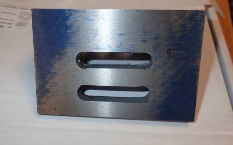

That is very correct. Sometimes I'll get too much into the process itself, because I want to learn stuff before I actually (and often desparately) need it.
Angular error is a killer, as you note it's possible to reach good accuracy, but it is much of a mental process as well. I had very small accurate square and all shop squares tested differently. It was a pain to work with them and I know that there are ways to true them, but they were different sizes and different models. I needed a standard I could trust to some degree. Threrefore I bought two bigger and identical pretty accurate squares to DIN standard and class #1. I tried them and they are nearly identical
I can tested this angle plate with them and surface plate using feeler blades. I can "feel" the hills/valleys, but can't really put number on it. Here it is not much, but for rudimentary "mapping" it would be nice to get a value.
My lathe is not that accurate, it needs adjustment during turning, therefore I need to figure out which parts to make and in which order to get acceptable results. I have noticed that as soon as I move tail stock on the ways, it moves sideways too a little unpredictable way. When I know more about this subject I will fix the actual problem, but I'm not too keen on much of the quick/dirty methods (like much of the "in situ"  lapping on internet).
« Reply #11 on: October 21, 2015, 03:14:28 PM »
I digged out my souvenirs from last trip to USA: Brayer and Dykem spotting blue.
Dykem tube had seeped out a little even before I opened it. It was a bit lumpy and harder to work that Stuart mictometer blue. Then again I don't know much this stuff.
This time I used cast iron surface plate, because:
1) Now I can keep it clean and I know it is good
2) Cast iron palte is bigger and it apears to be good, but I haven't check it all over yet.
The suspect angle plate does not rock, but it does not feel "tight" against the surface plate.
I checked it with with square and feeler blade, can feel it is not all straight and it feels like it has a dip in the middle both sides.
Then I spotted it twice and got similar results, although I'm not confident about it, I clearly can feel and see that spotting needs some practice. I'll lower it down on it's fulcrum then lay it flat and move 3" back and fro.
I'm not sure how much pressure to apply.
Also I need to think which high spot to start. Not onlyt to get it flat, but also square.
« Reply #12 on: October 21, 2015, 04:53:40 PM »
It's own weight will be enugh press to hard and you can bend it , to get it square a cylindrical square and a back light will work .
