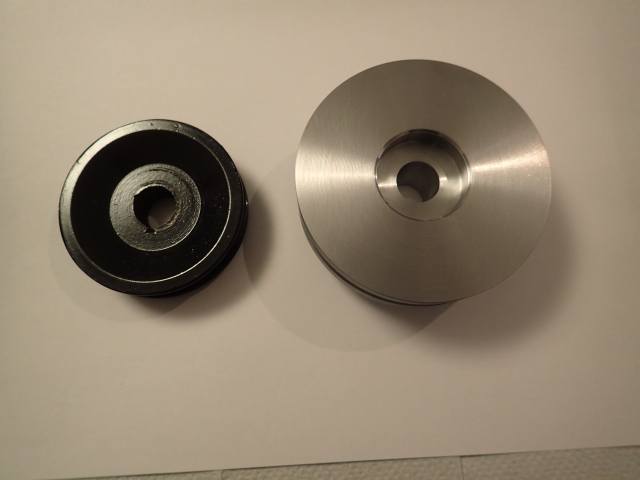

Father bought a Pile of various metals and calls it a tractor (Massey Ferguson). Mom calls it his mistress Fergie...
It's missing an DC generator. He bought a chinese ARC18 alternator copy, that has small modern V-belt pulley, that is for modern belt profile, that can'not be fit to tractor without making two new pulleys.
Therefore I'm of to make one. According to table values, pulley of correct size is outside of the working envelope in every aspect. Althoug that table states that it is not valid for agricultular and automotive use.
www.alexandris.bg/images/products/vb.pdf
Minimum pulley diameter 178 mm. All pulleys ae smaller than that on this tractor.
So, the plan is use eneough iron and make it smaller utill alternator rescharges battery eneough on normal use but does not spit belts out at alarming rate.

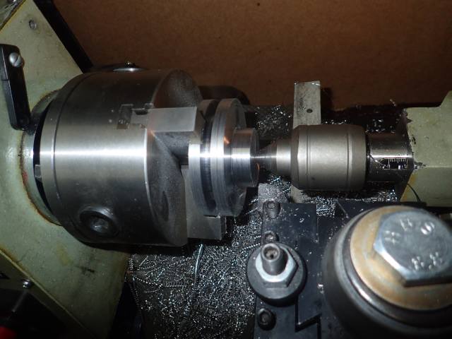

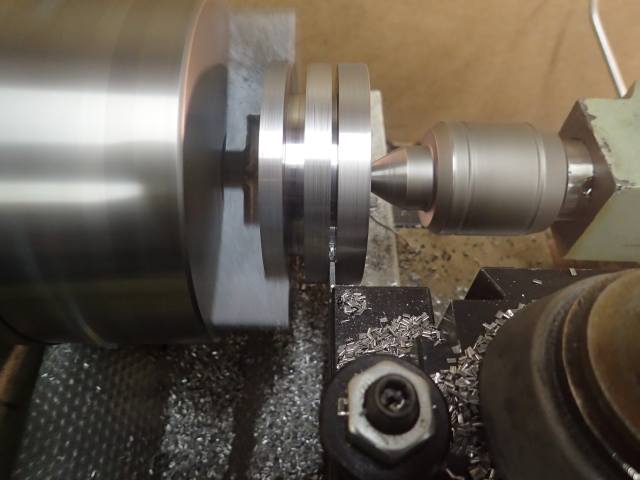

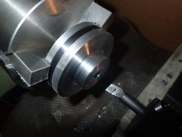

Roughed out from 85 mm dia rod and now I'm waiting a compact inser tool that will allow me to machine the groove.
The grove will be turned when pulley has been mounted on arbor to make hole and groove concentric.
All pretty basic really.

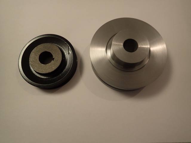

« Reply #5 on: November 09, 2015, 03:29:50 AM »
Finaly got keyway broaches from ARC eurotrade and friend twisted my arm to accept his small press. Just about enough for 2 and 3 mm broaches.
I had to make "special" bushing for 15 mm ID kole and 3 mm keyway broach. making that bush and broaching my first ever keyway took whopping 40 minutes total. Bit of an anticlimax after finding out all the facts. people and papers were right on this one. Takes surpricing large amount of force, best use plenty of cutting oil, align everything and goes well. What surpriced me is that every tooth cuts quite a bit. All tooth spaces are filled with the swarf.
Used this broach set:
http://www.arceurotrade.co.uk/catalogue/results.aspx?search=060-400-00100
And about 40 kg weight 2-ton or something arbor press, arm is about 400 mm long and it feels rigid at this force, but throat is pretty small. I'm not sure if it can accommodate much bigger broach.

« Reply #7 on: November 10, 2015, 03:25:58 AM »
Best part was that I finished it for my father for fathers day.
