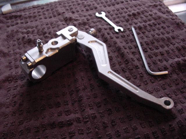

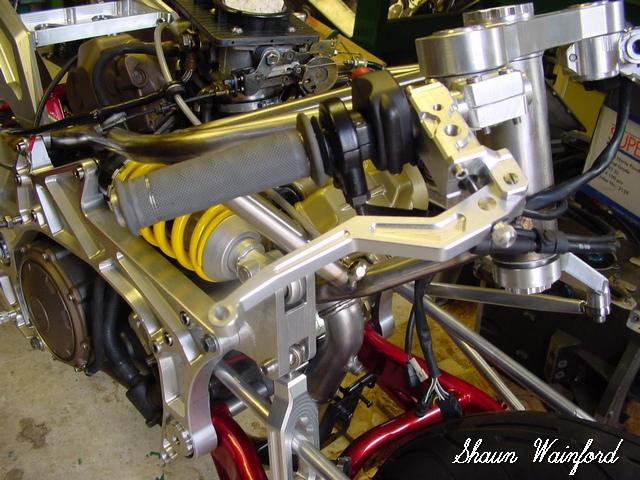

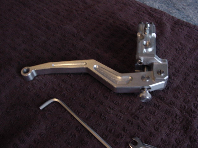

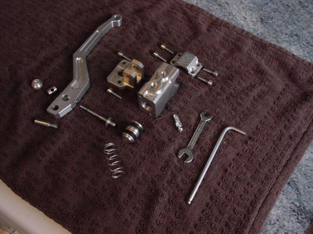

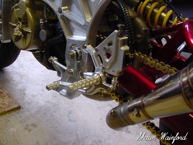

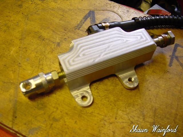

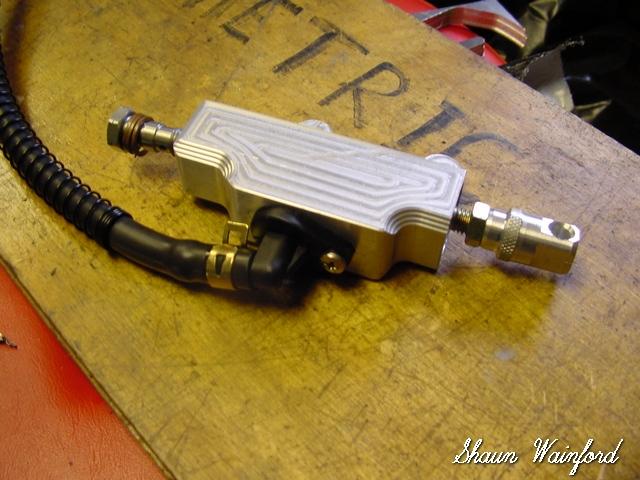

I haven't posted on here for quite a while I've been busy with moving workshop and house etc, anyhow I've recently got going again with my latest bike project, which is a Centre Hub steered sports road bike, anyhow thought you might like to see these Radial Master cylinders I've made for the bike, they are machined from Aluminium 6082, 2048, and stainless for pushrods etc, I actually made the bodies when I built the last project, they worked so well I decided to use them on this one as well, I also made the rearsets as well, oh and pretty much all the other stuff..........

Looks like a Tesi  :beer:
More pictures please ;-)

Yep! it inevitably will sort of look like a Tesi, I would rather think of it as an updated Difazio, after all it was Jack who really developed this steering system in the 60's and 70's, although it had been done in a fashion in the 20's, with the Neracar, there's a link to some other pictures on my thread Ducati Belt covers.

The Hub now then there's a question, I looked on the web to see what others had done, I also looked at Jack Difazio's patents, however the drawings are not upto much and give very little detail, all the other images I could find are of completed Hubs with little or no info on the details, having said all that I decided pretty early on I wanted to do my own, its basically a kingpin setup, I decided I wanted taper roller bearings, the rest was designed around this, the main problem was making it small enough with enough steering lock, and with some steering offset, also making the kingpin bearings adjustable for preload without removing the wheel, other problems to overcome where machining the external and internal splines with the equipment to hand, I ended up designing my own splines loosely based on the Torx system, this worked very well on destructive test pieces, other major  obstacles are bump steer and anti dive levels, I used Tony Foale's suspension software for the anti dive calcs, this is set at 50% digressing, the bump steer I did by animated cad drawings, I also use this method to draw the suspension links front and back, in tests up to now on full bump I have 2 thou deflection at the bar ends, I have ridden the bike down our lane without power, brakes or handle bars!, and it steers pretty neutral, this only happened when I brought the bike to the new house, I couldn't resist, I don't claim to be breaking any new ground here, I just wanted a CHS bike, but I also wanted to see if I could do it in my home workshop, besides I could not justify the money to buy one, I still have a lot of work to do, the main parts left to make are the Rads the fuel tank and the *@*#**&* Wiring which I don't enjoy....   :)
