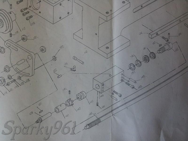

Ok, a picture's worth at least a few words, right?  A saving grace of this machine is that it did come with a full set of exploded drawings.  It has helped many times to see how things come apart and where I can modify things without having unanticipated problems.
I was hoping to be able to improve the action without massive changes.  Looking at the attached exploded view, I was wondering about maybe replacing the "dogs" (142, 143 - lower centre) with custom versions having a different contact face angle, and also very smooth, tough and hardened (4140 HT?).  I'm definitely concerned in doing this that the clutch will have a tendency to disengage on it's own due to the pressure forcing the dogs apart.  To counteract this I was thinking to add a spring or lock of some sort to the actuating lever (135) or associated parts.
Some of you have probably read posts of mine in the past dealing with this machine and its limitations.  It is for this reason why I don't want to spend a ton of time on this.  If I had more space, I'd almost certainly have a separate full sized lathe and mill.  Who knows, maybe it just turns out to be an interesting discussion on clutches and machine design.
Regarding the angle of dog engagement, can you be more clear on whether this angle is from horizontal or vertical?  Maybe a sketch or link?

There's not a lot of space to play with, is there?
Improving the general fit and hardness of the parts will, I'm  sure,  improve it.
Pay attention to any part that forces another to  i.e. are the dogs exactly 90 degrees apart ? (if you remake it, i suggest two dogs 180 apart would be easier ) does the slide lever try to push the dog to one side (causing it to jam) .?
I have a very similar mechanism on my Haughton Cadets they can get stiff but are usually ok under normal threading loads.
Btw. The dogclutch is not usually much use when threading as there is not  normally a simple relationship between the clutch engagement points and the screwpitch. For instance the Cadet's 10tpi lead screw and four tooth clutch, means that is is only useful on 0.025" pitch (40 tpi - where is can be engaged at any point) .
You may find it easier to fit an electrical stop (and reverse ) or thread backwards away from the shoulder (there's an explanation somewhere on the forum of this) .

« Reply #6 on: October 12, 2015, 03:39:28 PM »
Hi Sparky
The pictures tell the story not a lot of room to play around in is there.
Bill Todds suggestion that two points of contact to separate the clutch will help.

« Reply #7 on: October 12, 2015, 05:08:02 PM »
Hi Again
Pondering on this over breakfast Came up with this to get two points to operate the dog clutch
Bore the bottom of the gearcase and fabricate two shafts with a yoke on the outside of the gearcase.
Attached a rough sketch

Hi Sparky
The angle on the dogs is from the shaft centre line with negative rake of 5 degrees tending to disengage the clutch then an over centre locking is required or a spring and  a lockout latch.
manxmodder
""Also I can't see how a carriage stop could be used with the lead screw half nuts engaged as when the carriage meets the stop the lead screw half nuts would come under destructive strain.....OZ"".
It doesn't a 1/20 hp gearmotor with poly vee belt with just enough tension to move the carriage hits the stop and the belt slips.
