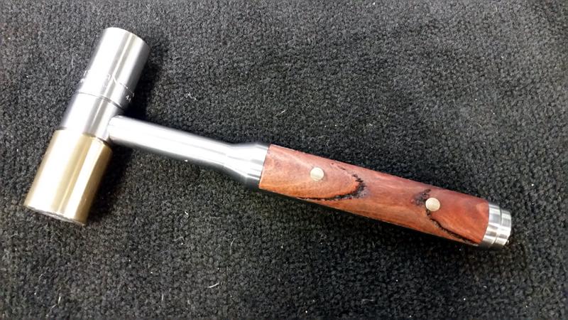

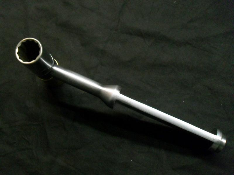

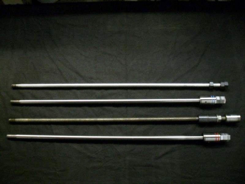

Been a while since I have posted here, so I thought I would share the drawbars that I made for my Kondia FV-1 mill as well as the hammer.

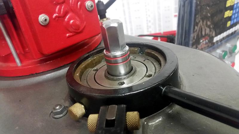

Given that I buy most of my tooling OS, I have ended up with two different threads on my tooling: 1/2-13 for the US stuff and M12x1.75 for the metric stuff.  Both are made from 4140, using ground and polished 1/2" pinned into ø30mm stock that was turned and milled to for the hex.  The coloured grooves are so I don't mix them up!

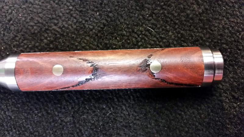

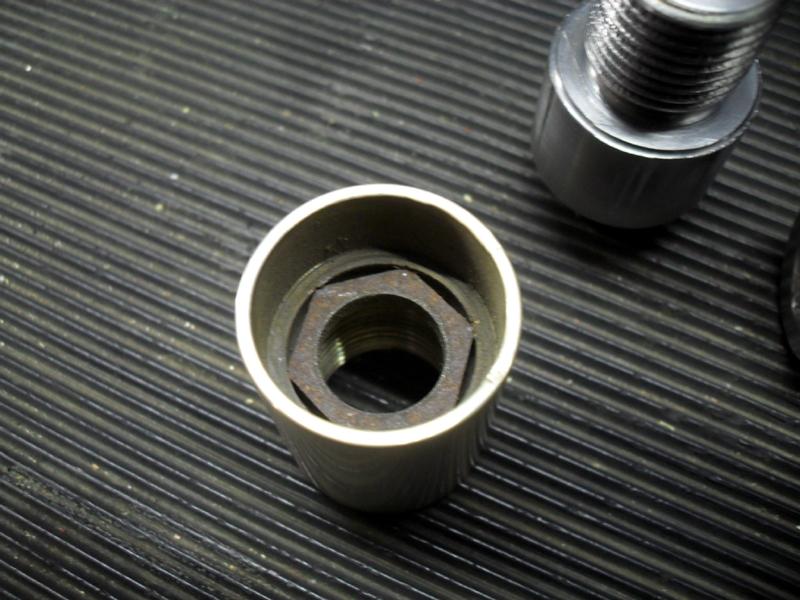

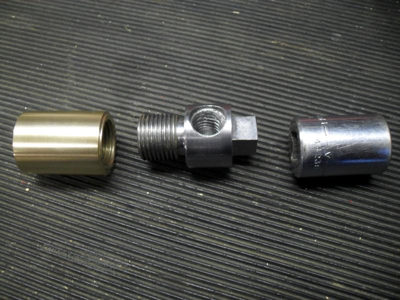

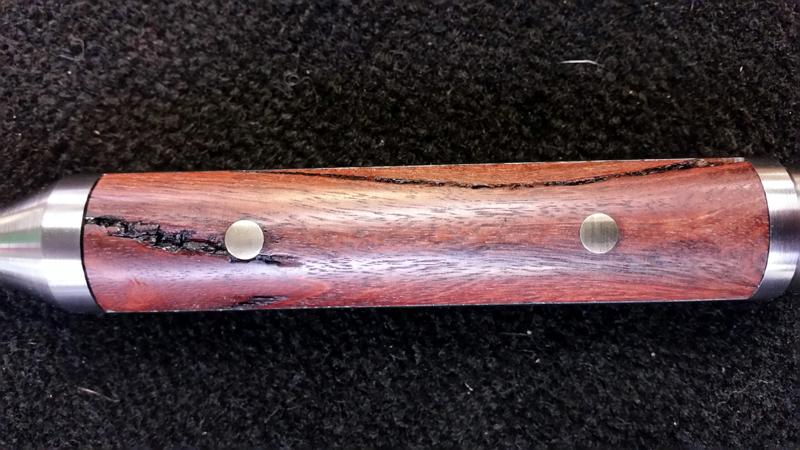

The hammer uses a 1/2" drive 19mm socked and a weird brass pipe fitting that I found. It has a 1-14 threaded end and once screwed on, I filled it with lead.  I did contemplate simply knurling the handle but I decided to steel someones idea of making wooden scales.  The wood is recycled Jarrah (eucalyptus marginata) and I deliberately cut the wood looking for some imperfections.  Oiled with Ballistol and once that soaked in it got a polish with some locally made gun stock polish which leave a nice non-slip finish.

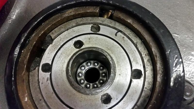

I'm really happy with these and they are much nicer to use than to two crappy ones I had been using (one came with the mill).  I also added a thrust washer which sits in the top of the housing and it works very well

Nice job Mayhem. :thumbup: I've never had any problems knocking out the drawbar on my mill as I don't over tighten it but I used to get amused at our cousins over the pond bleating on about Morse tapers not being self ejecting in spite of the fact that on some machines they are. Mine wasn't though so I made one!
Bottom thread is M12 x 1.75 to fit all my tooling and the top is M14 x 1.25. I suppose it's a bit kinder on the mill but no big deal.

Thanks Arbalist.  The NTMB30 taper doesn't require a beating but it does need a quick, firm tap to break free.  I've had one come loose once through inexperience and not wanting to over-tighten things.  With the thrust bearing, a quarter turn past the point of initial resistance has proved to be tight enough.

Hi Arbalist, can you help me understand your drawbar a bit better?
If I understand your concept, your threaded the other end of the spindle (or it was already threaded for the purpose) at a finer pitch than the tooling tapers? The ejection force is thus generated by the DIFFERENCE in pitch - unscrewing the tool fast than the drawbar fronm the spindle?
That seems very clever!
Could you have a loose nut to tighten the drawbar, independently from the length of the drawar? SOme of my MT4 tooling have a small variation in taper length and drawbar position. I manage that with various spacers and washers at present. But can't quite picture how it will work with an ejecting drawbar....

Yes, it's just the difference in thread pitch Joe. I got the idea from Ralph, here:
http://modeleng.proboards.com/thread/5804/mill
Some of my tapers vary a bit in length but I've not had any problems with the operation of this draw bar. It works fine.
