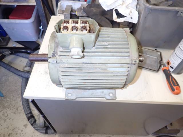

aargh...got two motors and both are hard to modify:
1) Finnish made botor that apparenty has the rotor shrunk supertight (maybe used residula heat from aluminium casting).
2) Italian motori is a two piece design..Back bell is integral with shell.
Has anybdy modified AC motor bearings to angular contact bearings?
1) Finnish made botor that apparenty has the rotor shrunk supertight (maybe used residual heat from aluminium casting).

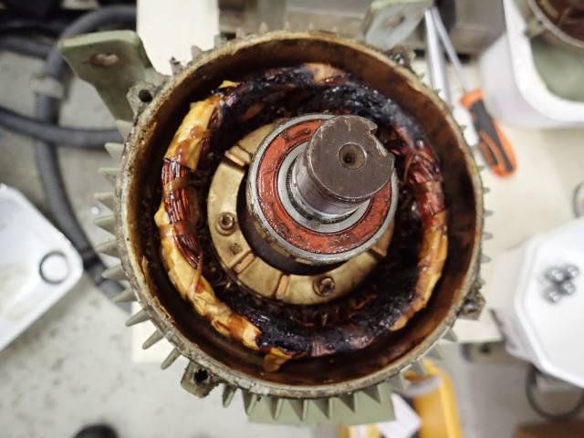

motor #1 flunked on insulation tester...one phase very low on 500V, low voltage measurement does not indicate anything too special. Bridges are off ie. coils are floating. This was the one that mechanically would disassemble easiest and would modification, but rotor is a bit of mystery.
Connection box has quite a bit of rust in there. I spayed it with first rust remover oil and CRC product I got my hands on. Then tipped it upside down, maybe it's just some gunk on connection box?
Motor #2 is nice and works, but can't work on it. It's awkward size and shape.
Probably should buy new italian motor and try it.

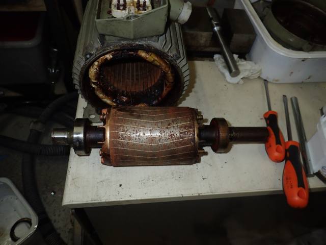

Motor #1 is a toast. Turned out that rust was not a conductor...it was an insulator.
All toasty inside. Now question about rotor on that motor is purely academic. Have to lug it around a bit, need a big press to coax it out, I don't care now how it survives.
