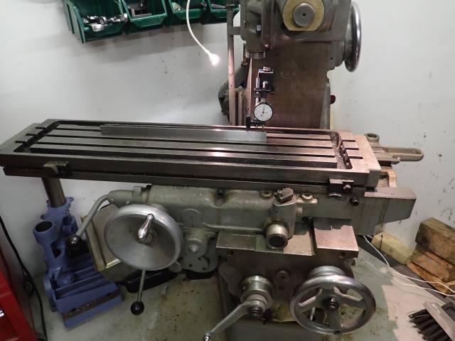

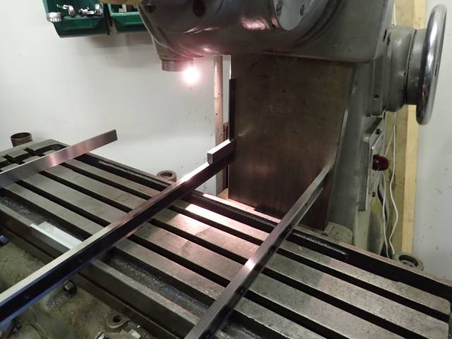

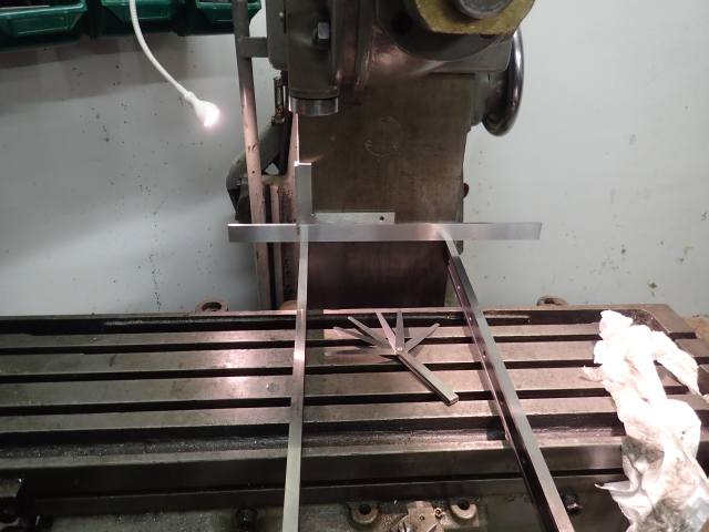

I took some pictures yesterday.
Yup, table tilts just a little bit, I'll clock later today where is that clearance, looks like right amount, but I'd like to know where the paly is and how much.
I ordered two bigger Mitutoyo squares grade #2, that should be close enough.
Ok, some pics
This is just aproximation to find out biggest source of problems and to make sure I don't overlook something easy and obivious.
Re: Knee mill table aligment?
« Reply #4 on: August 17, 2015, 03:35:10 PM »
Bit more crankking table left and right, fore and aft, while DTI is mounted on knee. Hardly any movement on fore and aft. Knee tilts just 0,03 mm when cranked full left to right. I did lean on table on my full weight and DTI nedle hardly moved.
When table is moved from full aft to fore it raises just 0,03 mm (parallel on top of the table) DTI stylus on parallel and base on column rail (base rail).
Now I have to establish that axis are square. That is the hard part. Second test with better square, then I'll ask one friend to check with square spirit level and make the adjustement plan. Last part is to retram the spindle and take it to test drive.
