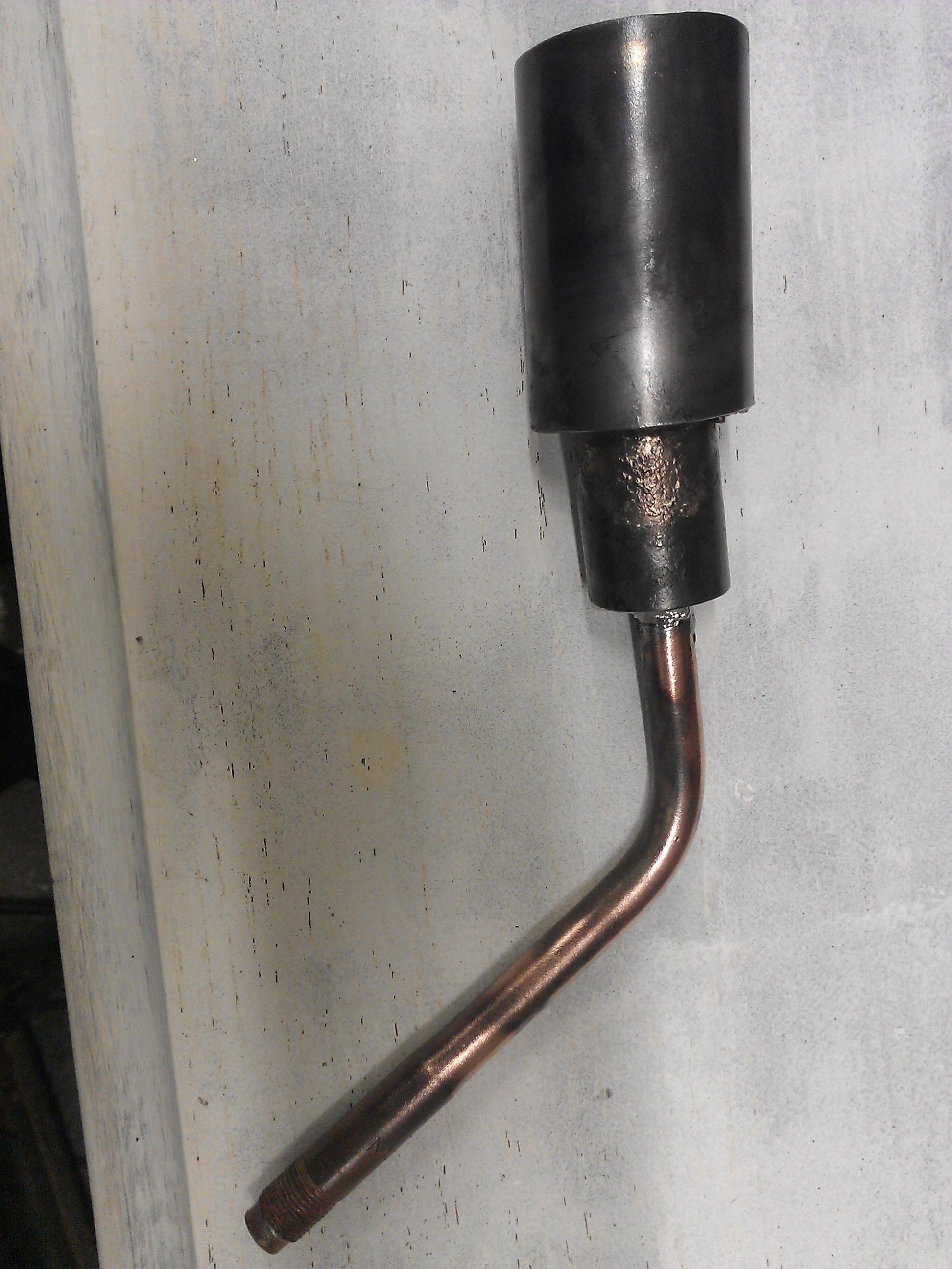

For anyone interested, here is a picture and video of my compressed air - propane torch. I followed the dimensions given by "Ironman", although the jet is not set as far back in the throat. I need to sort out some new hoses and a connector to the compressor as it leaks badly, but I am really pleased with the overall result.
Thank you for the help.

Re: Compressed Air Propane Torches
« Reply #26 on: May 08, 2015, 04:42:18 PM »
James, seems the video is private.....?
Were you able to braze with it?

The video should be public now. I have not tried brazing with it yet, mainly because the airline leaks too much to keep running for more a minute of so, but I shall try over the weekend and update this post.
James.
UPDATE
I have now. tried the torch out in practice and it brazes well. I tested it on the head of the dragon, on which my other torches only just work after a very long time heating. This new one achieves a better result within a very short period. The flame is a bit wild and I will play to see whether I can make it more focused. I may bend a sleeve up to go over the tube so that I can slide it up and down and vary the effective length.
