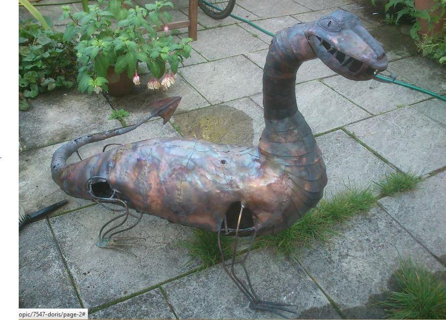

I am building a large copper dragon and up until now, I have managed with propane gas powering a MAPP torch. However, as the bulk is increasing, I need a more powerful torch to get the heat into the metal. Due to the size and shape of the work, it is not practical to surround it with fire bricks or the like.
I have read odd bits, here and there, about compresed air assisted toches and was wondering whether anyone has any experience of either using them, building one or converting a standard one to work in this way. Due to cost and space, I would rather avoid going down the bottled oxygen route and the cost of MAPP gas itself makes it prohibitive for the size of job. In addition to the MAPP torch, I have a Clarke torch: the cheap sort that are sold under various brands and come with three nozzles and an air compressor.
Any advice would be appreciated.

WOW! I like your Dragon very much,James. :clap: :clap:.....OZ.
Re: Compressed Air Propane Torches
« Reply #22 on: January 22, 2015, 06:01:51 PM »
Hey, Cool catceefer!! :thumbup: :beer:
« Reply #23 on: January 22, 2015, 06:41:28 PM »
James
Now you are geting our attention. I can see a lot of back yard treasures turning into front yard art pieces. Well done.  :D  :D
