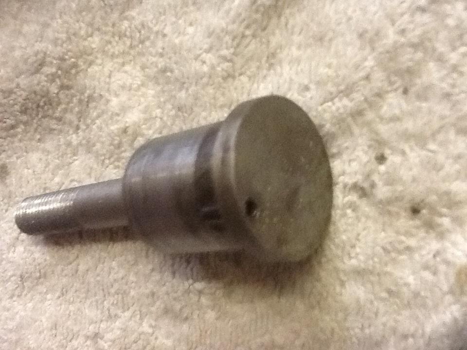

For those wondering what it is I'm making... I'm copying the vice jaws of a Manchester Rapidor hacksaw for a couple of guys on another forum. The half rounds are 3 1/2" tall, and rotate within a backstop, and allow you to set the saw to cut at +/- 45 degrees from "straight ahead". They're held in place by a single large bolt, there's a curved slot cut in them which allows them to be rotated.
You can probably see what I'm making in this picture, courtesy of the mig-welding.co.uk forum:
Obviously, the originals were cast, presumably the front faced to give a smooth surface, then they'd be glued(?) together and the outer diameters turned to size.

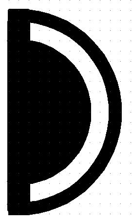

« Reply #12 on: July 22, 2015, 02:42:45 PM »
ok now i know what your making I have a suggestion. What about taking a bit of 4" X 3.5" X 3/8" plate a bit of 3" thick wall tube and a bit of 4" thick wall tube and arrange them as in the pic. You could fill the gap in the smaller tube then machine it all to make it pretty.
