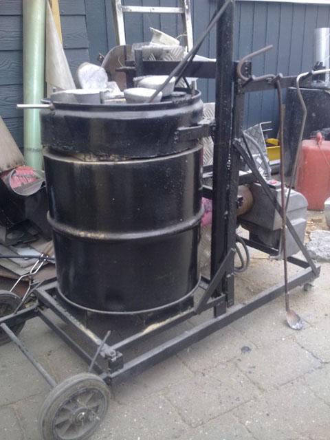

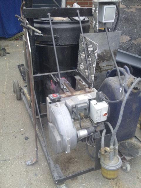

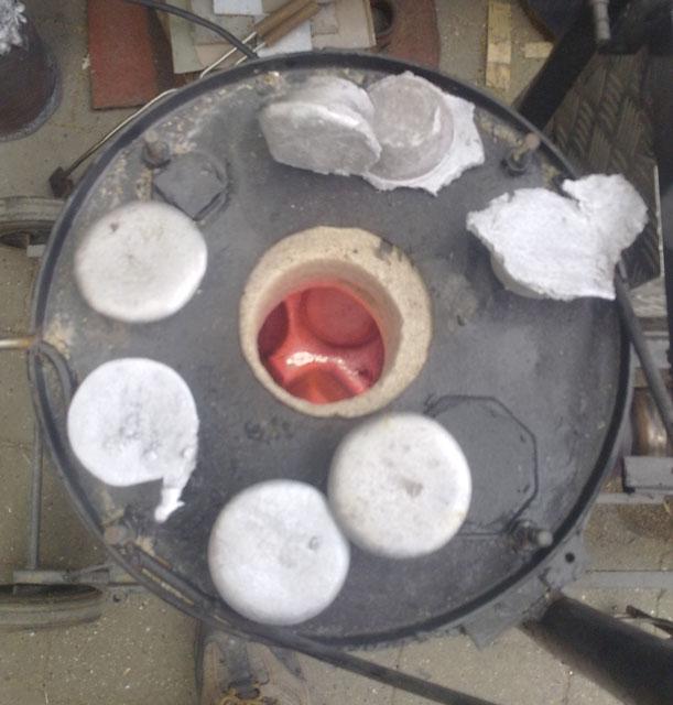

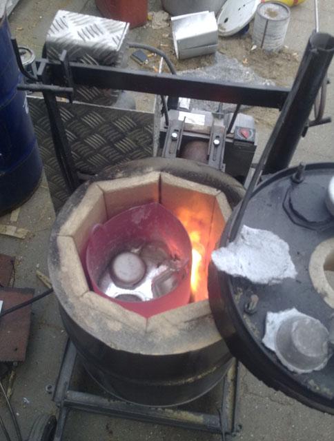

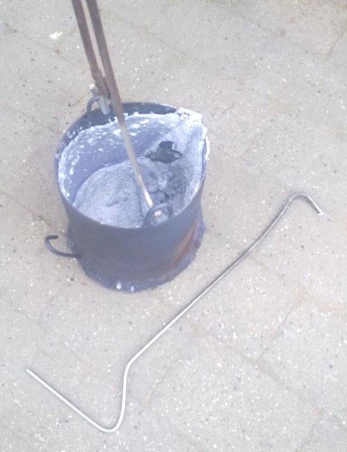

I have been asked to show my melting furnace, so here we go.
Its made in a 60 liter oil drum, where i made a inner core out of Vermiculite plate, and pored concrete arround it.
The heat comes from an oil burner coming from a central heating system.
in the pictures i was filling the largest crucible i have, it takes 22kg aluminium, and takes arround one hour to melt. i do prefer to use the smaller crucibles since this one it fairly hevy to pour, atleast you dont freeze when pourin this one  :bugeye:

its a nice thing to have, and i have made some 100 Kgs by now,
Actualy the pictures was taken yesterday while i was making casting for a new drive wheel for my diy belt sander, and i did fill the crucible to ca 4 cm from the top, so around 20Kg.
Man its hot to pour 20 Kg of hot metal one man, its not that easy to hold it at a distance, so the crucible was max 20cm from my legs  :drool:
Martin

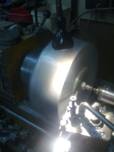

The biggest so far, is on this pic, mounted in my emco compact 8 lathe, and that was after i shaped it on the bandsaw

Nice chunk of aluminium.
John.
Offline Neubert1975
  • Posts: 67
  • Country: dk
Re: Melting Furnace
« Reply #21 on: July 16, 2015, 12:43:09 PM »
John.
at least heavy, the only mold i could find that size was a pot from the kitchen.
quite challenging to work on this size in a small lathe.
Martin
