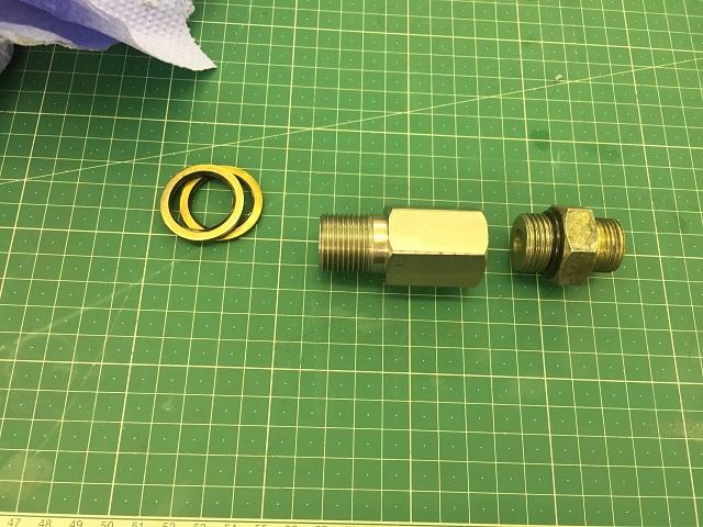

Why can you not use 'bulkhead connectors' and pass suitable bundy tubing straight through them, using the connector as a support and a seal? The pump line will be under a few psi pressure, but the other return line will be under very little.

Would it not be a good idea to put a Dowty seal on the bulkhead connector?  I know they're OK with hydraulic fluid but are they also fuel-proof?
(I guess my calling them 'Dowty seals' shows my age!!!)

Should work nicely Pete, and even if others call then bonded washers, they're still Dowty seals to me :)

Are we talking about these THINGS
  • Posts: 2540
Re: Truck fuel pump hanger
« Reply #7 on: July 08, 2015, 04:00:17 PM »
Looks like it to me.....
And these....
  • Posts: 9051
« Reply #8 on: July 08, 2015, 04:44:05 PM »
Yes basically an 'O ring' slightly fatter than the thick washer that it is bonded inside, allowing two flat faces to seal as I did in the modified fitting for my JCB 803

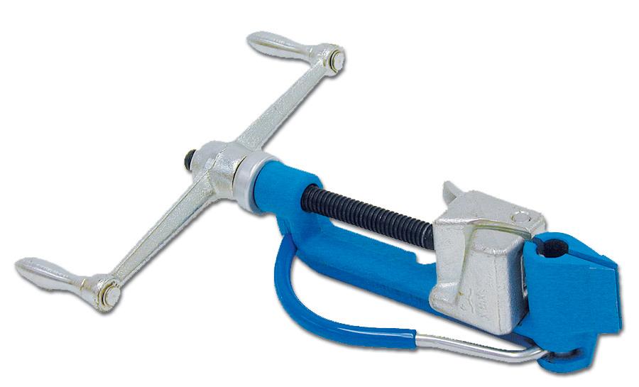

I have a gizmo called a 'Band-It' which would be ideal. Clamps a stainless band of any size.
http://www.band-it-idex.com/en/products/Band%20%26%20Buckle/Valu-Strap%20Band,%20Valu-Strap%20Plus%20and%20Valuband.html
