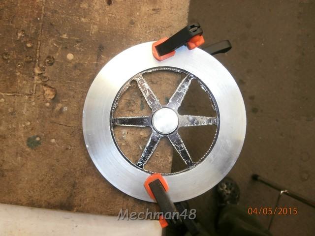

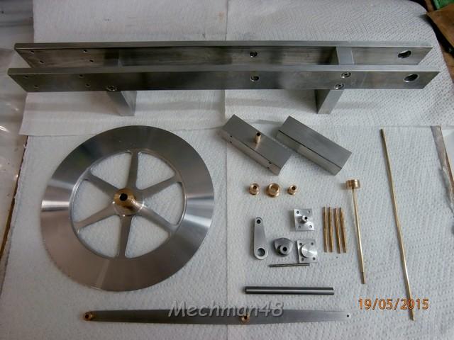

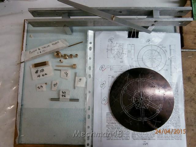

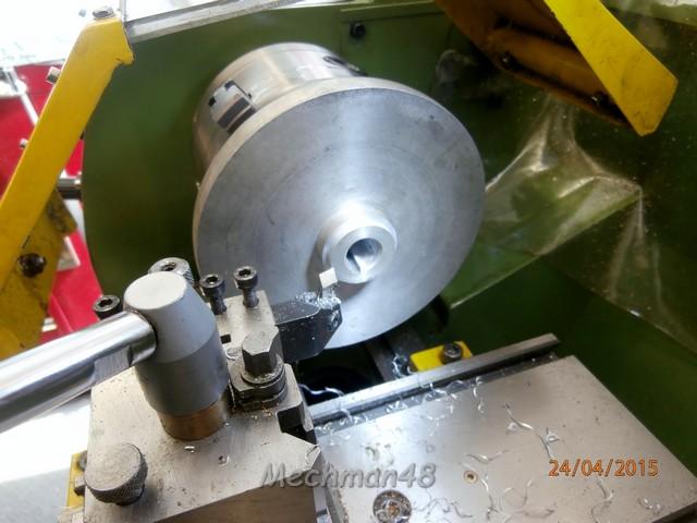

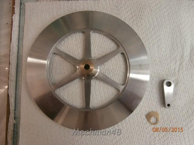

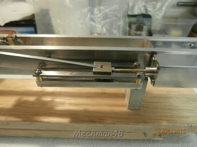

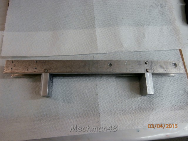

Have just about completed educational model paddle engine; a demo model to show the principle of how a paddle engine works but using a flywheel instead of an actual paddle assembly ( most probably add one later ); made from material to hand & the scrapbinium, Have att. a few pics for your viewing & hopefully a link to YouTube to see it running. the flywheel needs a case of looking at as it has a bit of a wobble but is not thick enough to machine out at the mo', have some thin aluminium on order to build up the rim so it can be re-machined true with the crankshaft. There are a couple of tidy up bits to do, make a new base, figure out the best way to paint the flywheel centre (advice welcomed) etc. ... but at least it works ok on approx 10psi air, so far I'm pleased with it..

Thanks for posting Mechman,  Did you work from plans or is it your own design? I did try searching the web but found nothing resembling what you have made bar a video of a twin version with paddle wheel between. Of course, I had trouble finding it again but finally :-
[ Invalid YouTube link ]
   I'm guessing there must be plans somewhere, I did try Jon Toms but alas.
Thanks again
Offline mechman48
  • Posts: 327
Re: Simple paddle engine.
« Reply #2 on: July 05, 2015, 10:31:19 AM »
Hi Swarfnstuff,
Plans for my model...   :headbang:
http://www.john-tom.com/ElmersEngines/50_edu.pdf
George.
« Reply #3 on: July 06, 2015, 02:58:43 AM »
