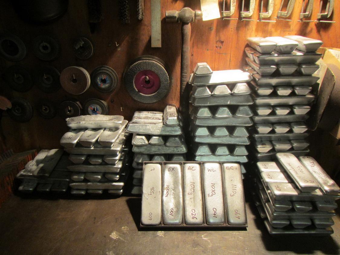

Numbers and weighed every bar and looks like over 100 bars.  Is there a reason you are stockpiling so much? Do you do metal casting or have some other use for it?
I was stripping manifolds as they are easy to get to the non ally bits but time consuming. The heads were too much of a hassle to think about stripping them so I melted them whole.  I now do the manifolds the same as the ally just drains off and  leaves all the little plugs and bits and pieces behind.
I want to do an aluminium plate. I was going to do 1000mmx500x60 but I'm having second thoughts.
I figured out haw many litres of ally this would take and what it would weigh. Who says ally is lightweight??
I think I'll reduce the plate to 600x 500 instead.  Still going to take 18L of ally. Ally is 2.6kg per litre so it's still going to be a substantial Piece.  I thought I had a bit of ally in stock till I worked this out, now I'm not so sure!

Wow!
You sure do like your ally!
I have about 400kg worth of bars.
These are a combination of Extrusions, Cans, Wheels and Engine Components.
I have plans to start casting components soon.
I just want to finish my CNC Router first so I can make some patterns.
I will also be melting my stockpile of copper and brass soon as well.
My crucible for the ally holds about 10kg max.
