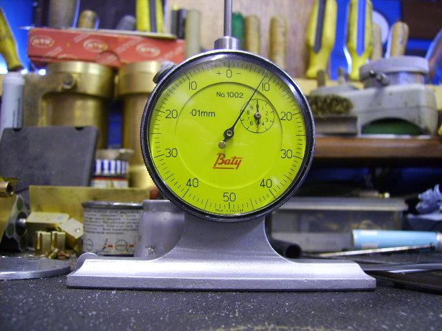

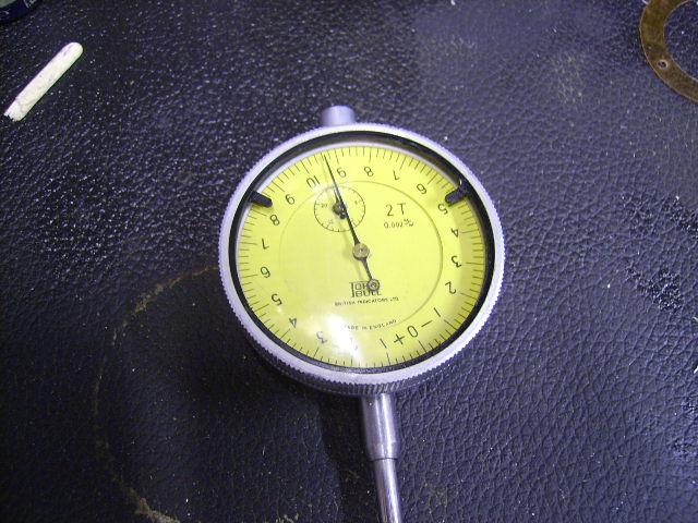

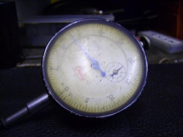

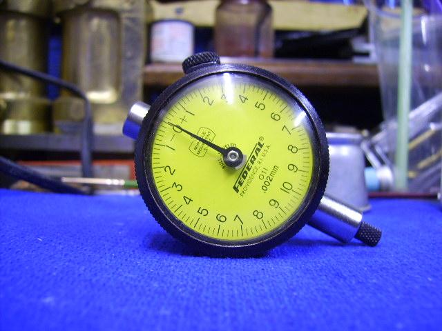

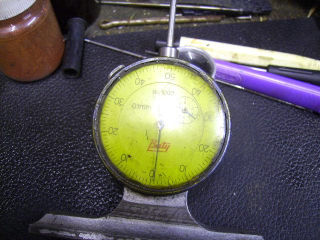

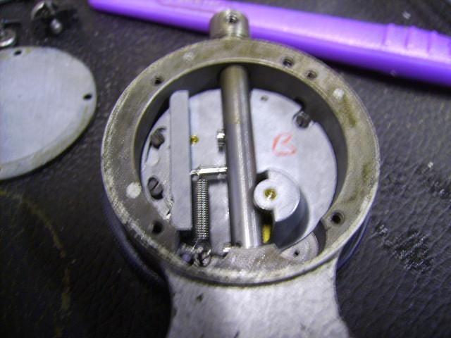

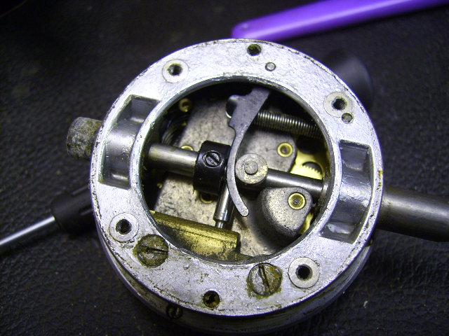

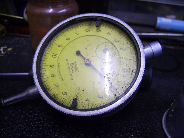

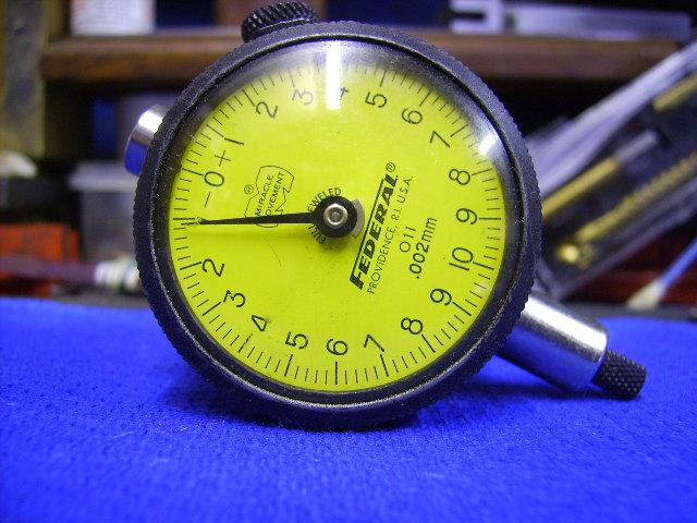

hi all as bin right biz lately but I got a lode of D.T.I's that needed my loving touch so I tuck sum pics of them before and after enjoy

« Reply #1 on: June 27, 2015, 05:29:55 PM »
Nice job Bob  :bow:
I can see I'll have to clear out a few drawers and cupboards, and send you a van load to sort  :clap:

Re: more D.T.I repares
« Reply #3 on: June 27, 2015, 08:54:07 PM »
Bob, after knowing how hard I struggled to get my cheap caliper back together (even using your lens fix steps) I've got nothing but admiration for you and the dozens of orphan DTI's you've restored to workshops throughout the UK!! :bow: :bow: :bow: :bow: :bow: :bow: :bow: :clap: :clap: :clap: :clap: :beer:

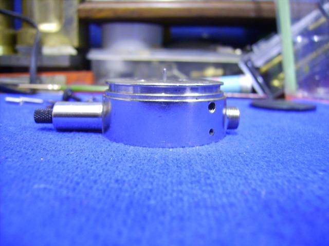

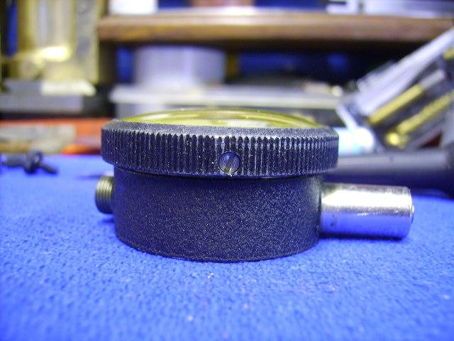

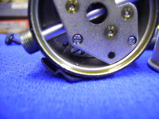

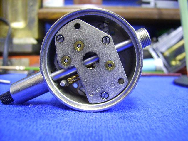

hi I got sent this D.T.I from john I.E Bigbadbugga for me to fix for him in all the D.T.I is in good order but for sum resen its bin a part and over oiled with the wrong oil so I just gave it my loving tutch but then disaster the pant on the mane body came off in cleaning tank  :palm: the problem being the body of the D.T.I has bin chromed so no key for the pant to stick to too be honest  it looks beter  with out the pant but that's up to john if he wants me to re pant it right pics

« Reply #5 on: August 08, 2015, 07:24:30 PM »
Wow, didn't realise it was that filthy.
I actually prefer the look of it now without the paint.
Thanks for the hard work. If there's ever anything I can do for you just ask.

hi I got sent this D.T.I from john I.E Bigbadbugga for me to fix for him in all the D.T.I is in good order but for sum resen its bin a part and over oiled with the wrong oil so I just gave it my loving tutch but then disaster......
How does this lot go back together.......cooked if I know..... :lol:
I best get him a new one.....

« Reply #10 on: August 13, 2015, 02:38:59 PM »
well a hammer is useful sometimes just love fixing them  as long as you are happy with it john and I hope you put it to good use
  • Posts: 2540
« Reply #11 on: August 13, 2015, 02:42:10 PM »
Like when you need to put the pointer back...... :lol: :lol:

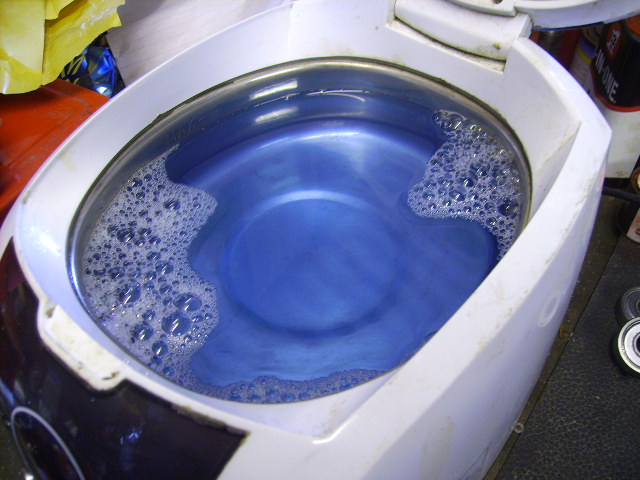

as long as the hammer is a mash hammer your ok I use starrett  instrument oil there will be other brands I don't recommend oil for clocks ie the ones that tell the time and don't use wd40

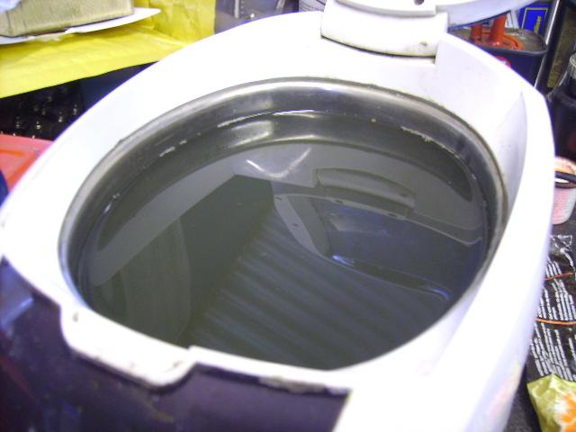

Bob
If you didn't have an ultrasonic cleaner, what solvent would you recommend?

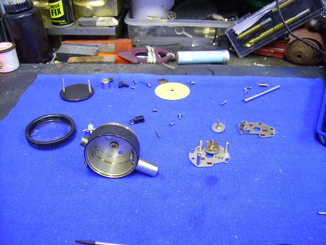

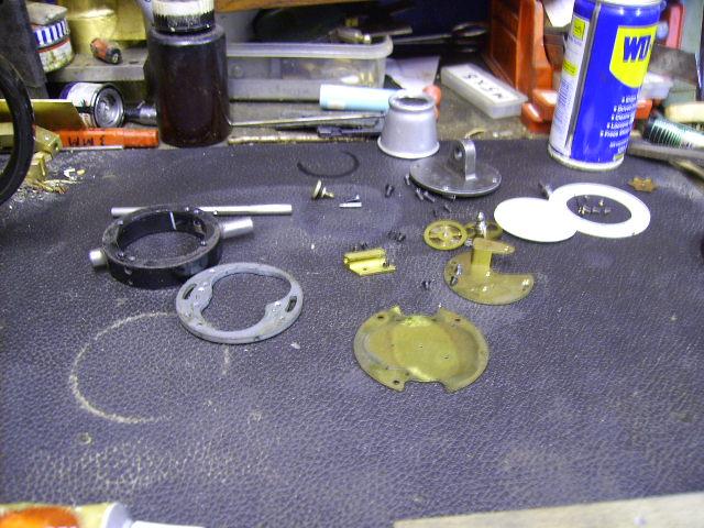

« Reply #20 on: September 14, 2015, 05:52:43 PM »

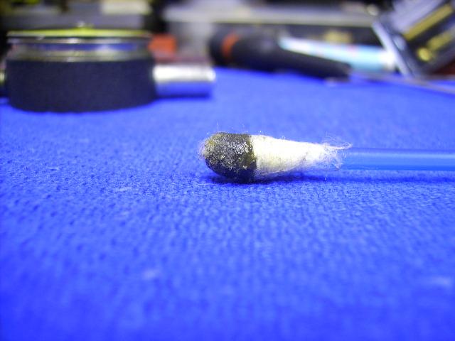

right the first question I strip the clocks dawn and clean them with brasso   on a button brush I will take a pic of the one I have then once all the parts have bin given a good buff   its all then wash off with hot water and wash up liquid ie the stuff you do the dishes with but cover the plug hole with sum fine mesh so if you drop a smale part it doesn't go dawn the plug hole then blow dry I youse a old her dryer clean out all the pivot holes with a clean peace of wood sharpened to fit the hole and always use a clean peace for every hole as for oil clock oil is designed for clocks your dti's are  not time pieces they are instruments designed for   mishearing things I have had no problems with the ones that I have dun with instrument oil but had problems with ones that I used clock oil I got from the net seemed to go sticky but im not a expert I just love restoring old d.t.i 's so whatever works for you go for it
