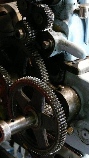

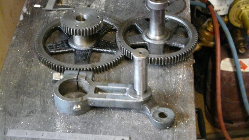

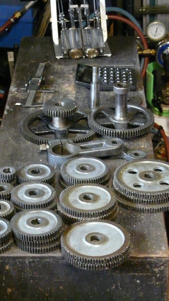

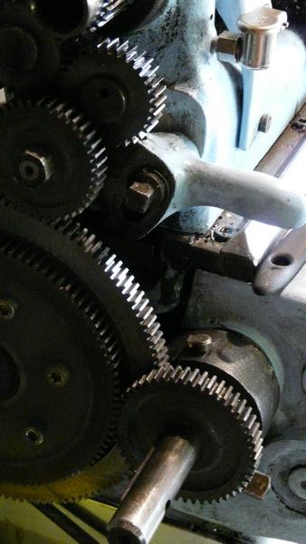

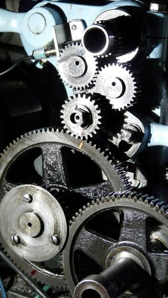

I have a 9" South Bend the with a modified Clausing gear box fitted , I would like to cut metric theads the fly in the ointment it the banjo has a fixed spindle for the idler gear , 24 teeth on the tumbler 96 teeth on the idler and 24 teeth on the 8 tpi lead screw , the banjo pivots to the tumbler I can change the idler gear but nothing works , I can cut new gears  but they have to add up to 120 at 18 DP , help please .

« Reply #1 on: June 22, 2015, 10:25:32 AM »
took the gears off to mesure properly its 16dp not 18 as I first said , if I use 20dp gears I can fit a 127/100 with a 40 tooth gear on the lead screw , just have to make a spindle and buy a 127 gear , still don't know what gear on the tumbler gears to fit or the formular to work it out .

« Reply #2 on: June 23, 2015, 02:51:28 AM »
Cracked it the internet provided the answer , 32 gear on tumbler 127/100 and 40 on the lead screw gives 12.7 tpi , that gives me 2 mm pitch lead screw , from the set of Myford gears I am missing 32 and 127 so this mod will cost less that 50 quid .

« Reply #3 on: June 23, 2015, 04:07:15 AM »
Just orded 127 and 32 change gears from RDG special offer both gears came to a total of £20  :jaw:.

Ade - although the input (from motor) and output to leadscrew are fixed in space, the other pivot(s) aren't permanently fixed - typically there's a swinging, slotted arm (which can be known as the 'change gear bracket' or 'banjo') which allows you to position intermediate gear(s) to mesh with varying size drive- and driven- gears. Tumbler reverse is just inserting another pinion in between two existing gears so as reverse the drive direction.

Ade the tumbler revese is the three gears in a triangle that pivot around the bottom gear , moving the second gear into contact with the lathe spindle reveses the drive to the lead screw , and leaving the left hand gear free , adjusting gears is just a thicnes of cartridge paper or untill they are quiet .

My problem is the banjo spindle is fixed no groove to adjust for the gears .

Hi Chipenter,
It may be worthwhile fabricating a new slotted "banjo to accomodate the different gears needed?

That was my first thought to , I alredy have 100 and 40 gears and the 32 127 should be delivered tomorow , all I have to do is bore them to fit and bolt the 100/127 together , and should be a simple change over involving two bolts .

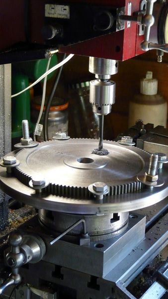

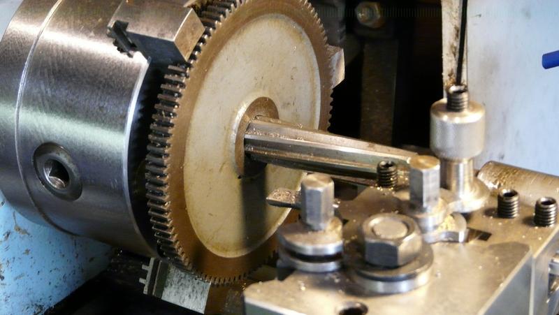

« Reply #13 on: June 25, 2015, 03:25:43 PM »
Gears arived today got them bored out and bolted together , the fixed shaft is 3/4" x 2 1/4" and I will make  spacers one 1 1/2 x 3/4 bore and one 3/8 x 11/16 bore for the lead screw end .

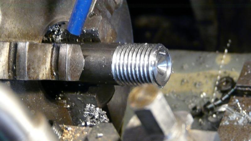

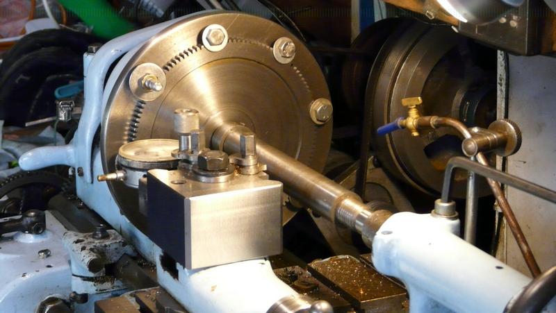

« Reply #14 on: June 26, 2015, 02:54:36 PM »
Got it finished the gears are nice and quiet and cut a 2mm pitch thread , using the instructions from Matt Tinkers Eggwick thread on screw cutting up to a shoulder , I have learnt something today thanks to Madmodder .
