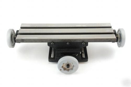

I made a big steel disk single insert fly cutter to do the Ford 850 tractor head, which allowed me to just catch the ends with one side of the cutter on my round column mill drill. Not suggesting the same if you can afford a bigger mill -- that would be much better.
But it just got me thinking -- I have a pretty big compound slide mill/drill table that I've never used -- purchased long ago when I had considered making my own mill. I was just wondering, now though, if I put that on top of my present mill table, could I do longer work? Well probably, assuming one had enough head adjustment height.
It's not much different than mounting a rotary table on the mill..Again, not sayin it's preferable to a larger machine of any sort. But seems like I might be able to extend capacity on occasion that way. Possibly for width as well.
