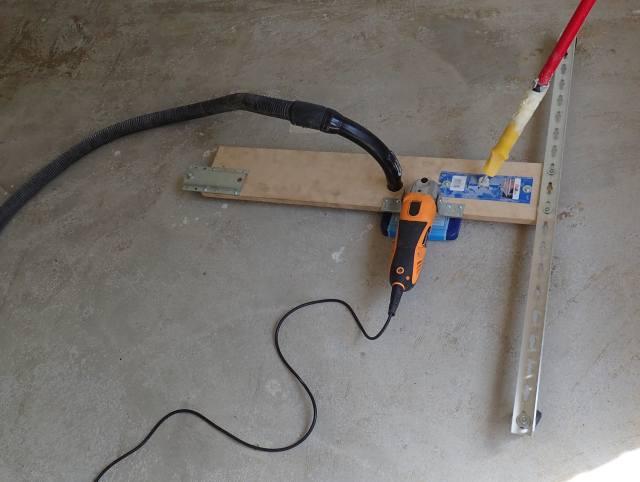

Something I slapped together used it all day and feel sorry.

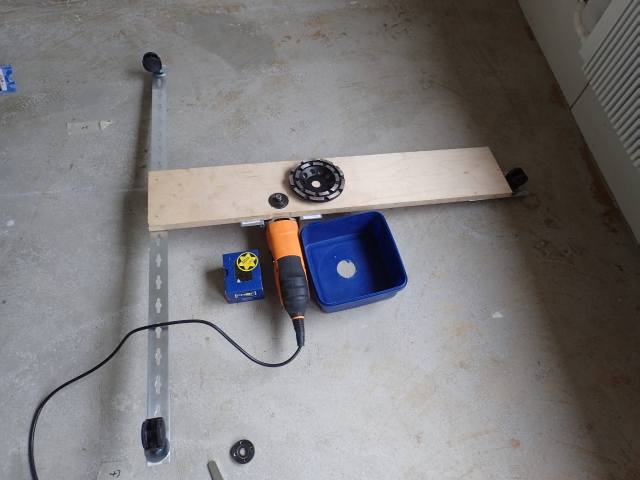

The living room floor was pretty level, but was filled with 3-5 mm "hills" about 1 metre diameter.
It actually worked pretty well. Adjusted a little off the complete level. I had stick on one hand and vacumcleaner hose and extension an another. Really easy on back and I didn't even break the sweat. I had good respirator and gogles, no problem there.
But dust removal did not work. Disk propelled debris out warp speed tangenttially, shop vac clogs and needs shaking all the time. Concrete dust vacs are a bit special, I thought that I could get away with flece bag and pleated paper filter.
Diamond disc chucks out concrete that fast and it's pretty fine. Perfect for clogging vacum filtter and for impaired vision. I almost got lost on my little livingroom.

Living room is sort of a nook, two openings in one corner. I covered them plastic masking plastic on both sides and then the whole corner. Taped to the wall. I also had a duct (channel ??) fan mounted on a small window to create under pressure in the livingroom to keep the dust in there. I really don't like the concrete dust around the house.
My idea was to fit three wheels on extremes and mount the grinder in the middle, idea was that the wheels will hit the valleys and grinder will flaten the top of the hills. Worked pretty well. Build it pretty symmetrical to avoid gouging. Interesting thing was that moved the front arm mostly to one side on grind close to wall and it did work. I was afraid "outrigger" would tilt it excessively.
The dust extraction worked remarkably poorly. Maybe a brush on the perimeter or a floating ring would have produced better results. If I was going to use it more it would have need more though and experimentation but I set to finish grinding it yesterday.
Another thing was that even though I had a big shopvac the bag was clogging all the time. Better automatically shaking and filtration would be nice but those are expensive for sporadic use. My shopvack has a manually activated shake or you could block the inlet momentarily to kick it, but it is not that great. Maybe a Thien dust separator would be a good idea.

No chance for silicosis, I was wearing a mask all the time and pretty good one. I also made room a little underpressure to prevent dust from spreading all over the house. There was quite a bit of cleaning left, but on completely empty and clean room it was just some work and no drama.
The problem was that the hood did not contain the high velocity particles, the diamond disc is rotating close to 12000 rpm and it is about 125 mm diameter. It ate trough the plastic shroud no time. It also needs quite a bit of flow.
Lucily it is all done now

Thank you, I tried that today. I also misted the floor. With better shroud it made all the difference. I ground 5 mm high and 1,5 by 3 metre "hill" away with minimum amount of dust. Marked and ground. Swep. and repeated about five times. It is pretty level now.
