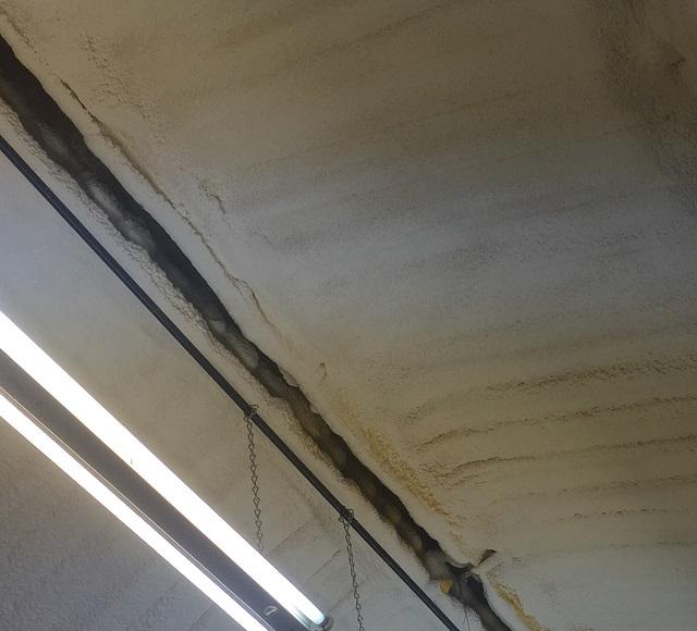

My workshop is a converted barn with corrugated fibre cement sheeting roof. It's been sprayed with expanding foam and when they did it they assured me that they'd sealed the apex where there is a 'top hat' shape.
Well they obviously didn't - I recently had an enormous bonfire ( 1/2 mile of Leydandii hedge top  :bugeye:) - and there is a line of 'fall out' ash down the length of the workshop. So if the ash blew in then my heat MUST be able to go out  :bang:
No chance of getting them back, as access is now very difficult with all the machines in place, and I don't want them covered in foam anyway !
SO - my thought was some form of insulating sausage that I can poke up there with a long stick - if there was such a thing as a 6" diameter cylindrical shape I reckon it would stay in place by friction.
 :scratch: :scratch: :scratch: BUT YOU MAY HAVE OTHER SUGGESTIONS PERHAPS  :scratch: :scratch: :scratch:

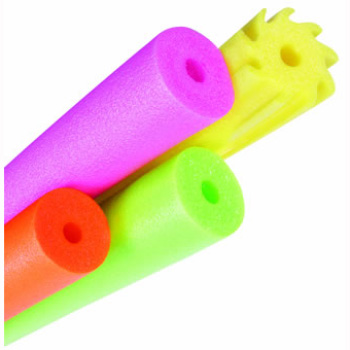

What about pipe insulation? Or the colorful equivalent "pool noodles" ?

How about 3or more of the pool noodles duct taped together?? Wont be the best looking, but might do the job??

Bertie, I've been thinking of slit pipe insulation with one bit entering the slit of the other to form a sort of figure of eight - the installation issue though I think is the real issue. If it is just a sausage in (say) 1 metre lengths I can temporarily pin it to a long pole and poke one end in place, then work along shoving the rest into the gap (there are light fittings and things to work round stopping me using one long length. It needs to be a good 'shove fit'  (engineering term !) so it doesn't all fall out in a high wind :)
If I could find some 6" thick durable foam (polyethylene maybe?) sheet and cut 6 x 6 bars that would probably do

Using polythene sheet, roll up some glass fibre loft insulation into sausages and stuff it into place.  Then foam fill the gaps.
You can make the sausages any diameter you want.

How about placing a strip of foil backed bubble wrap insulation over the gap and pinning it to the foam with barbed plastic nails or sticking it with double sided tape? It should be easy enough to do with poles if you divide the length into small segments.

Why not just use a longer piece of tube to squirt expanding foam? You could use aquarium air line, use some copper pipe which is rigid to thread the tube up. If you can get to both ends then you can secure the tube then pull the copper out. Squirt foam withdrawing the tube as you squirt...simples

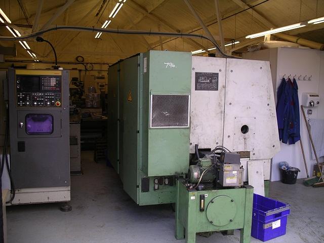

Hmmm, sounds like the access is the main problem here. You mention that your machines are in the way for more easy access to the roof and that the height is about 15 feet (~5m). So how to get above the machines ....
Would it be possible to re-arrange some of the floor space occupants so that you can use a smallish skylift??? That way you can get close enough to stuff a suitable material into the apex opening and move along with the work. The type of skylift I am thinking about is this:

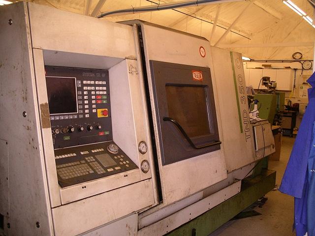

Trouble is some twit put 4.5 tonnes of Traub lathe slap bang in the way of EVERYTHING  :clap:
