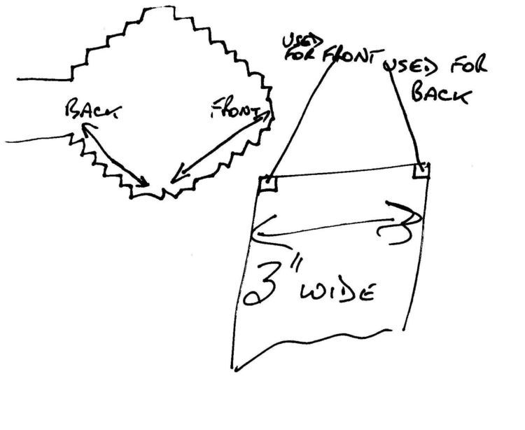

If I might muddy the waters a little.  When using the incremental method as Bernd and Bogs have said you start from the equator and work to the poles.  What may not have been said is that when working the tailstock side of the ball the left hand corner of the tool traces out the ball as you work to the right.  For working the other half of the ball Lautard's description (p77) then tells you to rezero the right hand corner of the tool to the equator.  You then will be using the right hand corner of the tool to trace out the ball as you work to the left.  When you rezero you take the tool width into account.  I would use a wide tool for this method for rigidity.  I hope this helps.

Chris,
I tried to do a post last night to explain exactly as Dave has done. But the site wouldn't let me post it.
But I did do a C-o-C to explain that the width of the cutter has no bearing on the job, as when you go 'over the top' as Dave states, you take into account the width of the cutter.
So here is the sketch.

Right, yes I am understanding this a little more now! The side of the cutting tool is actually over the top of the work cut so the width doesn`t have a bearing! thanks for the writing  David and Bogs for the drawing, together they have helped me understand!  :smart:
