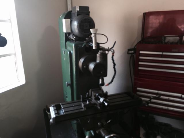

My Tom Senior has a "Knuckle Head" vertical attachment and i use this for most milling tasks. My problem with it though is that the head severely limits headspace and the worst problem is my two helical drivegears for the spindle in the head are almost non existant. I think the machine had a very productive previous live as they are worn very sharp! Getting new gears made will cost more than i would pay for a chinese mill! I really dont want to part with the Senior as its a superb, very rigid and still accurate machine.
What i have been contemplating is to build a new "M head" type spindle that bolts to the top of the machine and remove the knuckle head completely. What bearings could i cost effectively use. I did some enquiries regarding "super precision" angular contact bearings and the pricing on those are prohibitive. Any other suggestions?

Thanks for the welcome vtsteam, krv and Abraham. The mill has a 90 degree knuckle for vertical milling, no quill, just a knee for Vertical movement. The helical gears are still a bit above my experience level. Another reason to make another spindle is to increase headspace, fairly limiting factor on my mill. Another limiting factor is spindle speed, max speed on the current spindle is around 1000rpm, a bit slow for my small 3 mm mills i use for engines. Will try and get to a larger town in South Africa tomorrow to look for some bearings

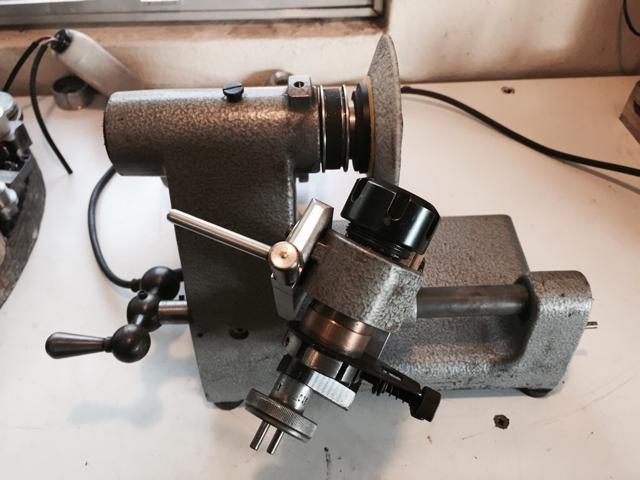

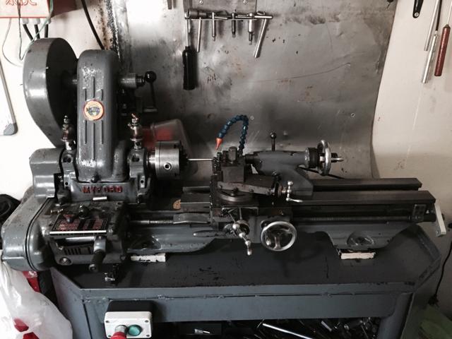

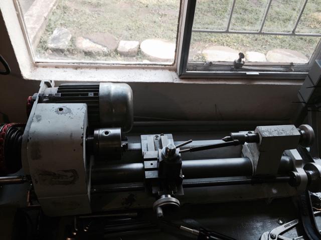

Hi Guys, i promised some pics of my machines , so here goes. The last photo is of my Gravograph single lip grinder i modified to grind end mill ends. Have another Black & Decker valve grinder that im still working on. So many projects, such short weekends!
