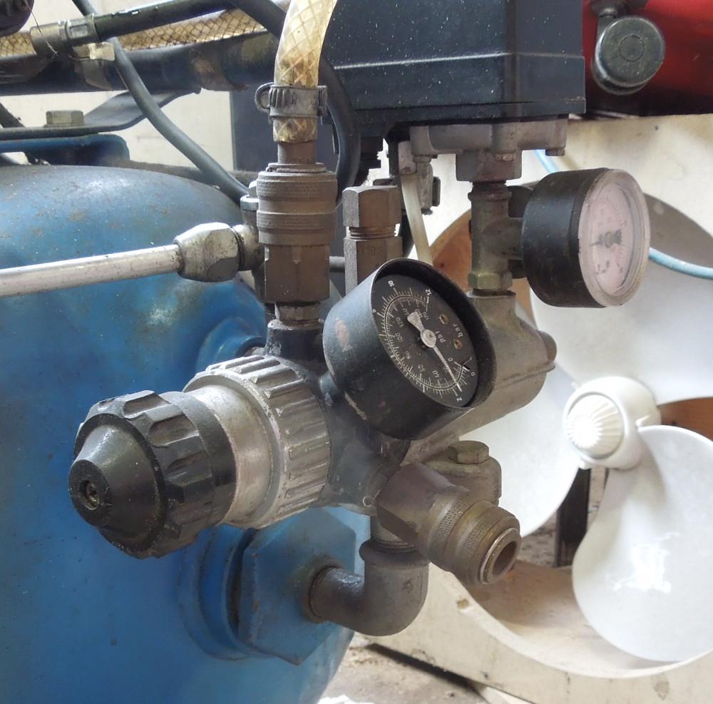

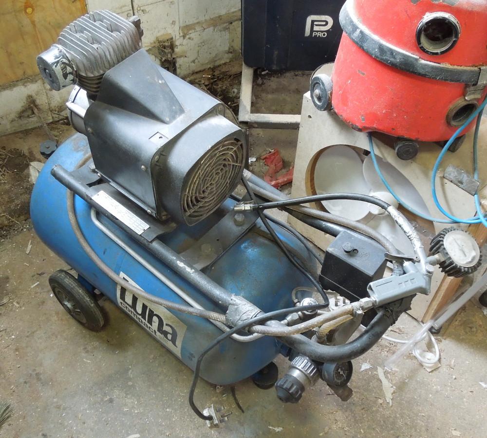

A neighbor across the road who restores old cars gave me a spare compressor he had in his shed. I'm pretty excited about it!
But being fairly old (about 30 years), and having sat in a shed for a while, i'm nervous about it possibly being dangerous. It runs fine and I got it up to 40psi before deciding that was far enough. There's a large plug on the back with a valve for getting the water out that I could possibly remove to inspect the inside of the tank, but I thought i'd probably best not remove it until asking if it was necessary.
The guy also said that the output regulator is shot and leaks air, although it isn't currently it probably will start doing it again if I try fiddle with it. I can't find any information on this compressor online and i'd have no idea how to go about potentially repairing it.
Anyways any advise is appreciated.

That is a quite good compressor, sold by LUNA, a Swedish company... I doubt it's as old as your neighbour says, I'd say maybe 20 years.... LUNA is still in business, do a google, and you'll find them. I think they might stock whatever parts you need, and there might even be a spare parts list and sketch on their website...
It was touted as better than the Chicom stuff other were selling at the time it was new, I think they were made (partly) in Italy... Don't quote me on that!

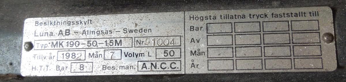

Also there's a few plates on the tank that say that it was made in 1982. In Swedish and Italian. It's Italian made it seems.

Just had another look at your pictures, I think the vessel is better quality than suspected, the wall thickness of the inspection plug boss is of a good section and I would say the hole large enough to inspect through, after all that is what it is there for rather than a small pipe connection.
Any rust is likely to be at the lowest point a dentists type mirror would allow you to see, even if condensate has rested in the bottom it still needs oxygen for rusting to occur.

In an industrial setting PSSR would apply - which requires a scheme of examination to be in place.  Such schemes would be pretty similar for most compressors around this size - manufacturers often supply one with the machine (so may be worth asking).
Test pressure should be marked somewhere.  For smaller vessels, the original plan could have been no routine test, but with a 'use by' date - though the label shown looks like it has space to record routine tests.

Does it say anything more than Luna compact on the side of the tank? There should also be a sign somewhere...
If it does, i may be able to help with schematics and/or parts lists and maybe even a user manual.

Stick to the test pressure on the label - (I don't read Swedish, but it looks like 8 bar test with 7 bar working ?).   Certainly don't try 2x working - you may cause damage.

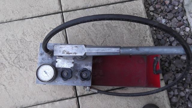

Simon,
I have a pressure test pump like the one in the picture below and would willingly test your tank were distances and geography not such a challenge. Though I must confess I've never hydro statically tested my compressor tank just regularly drained condensation and given it a visual check over (it's in an otherwise unoccupied steel Portakabin - if the worst happened it would be contained)
