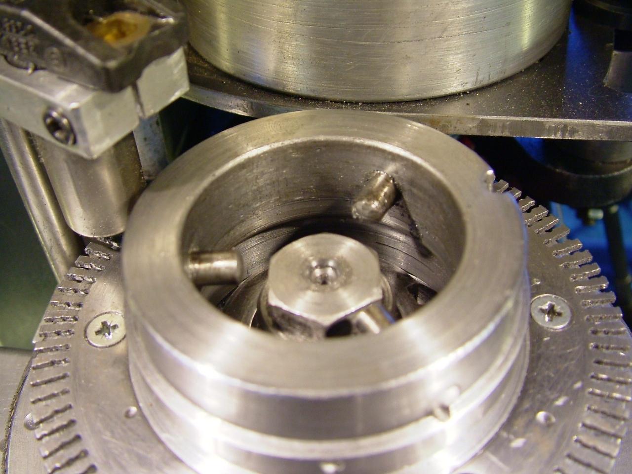

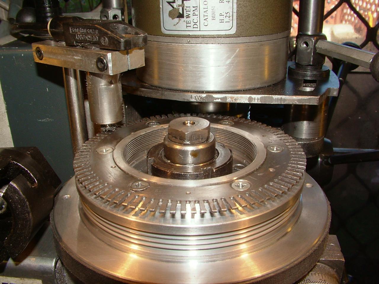

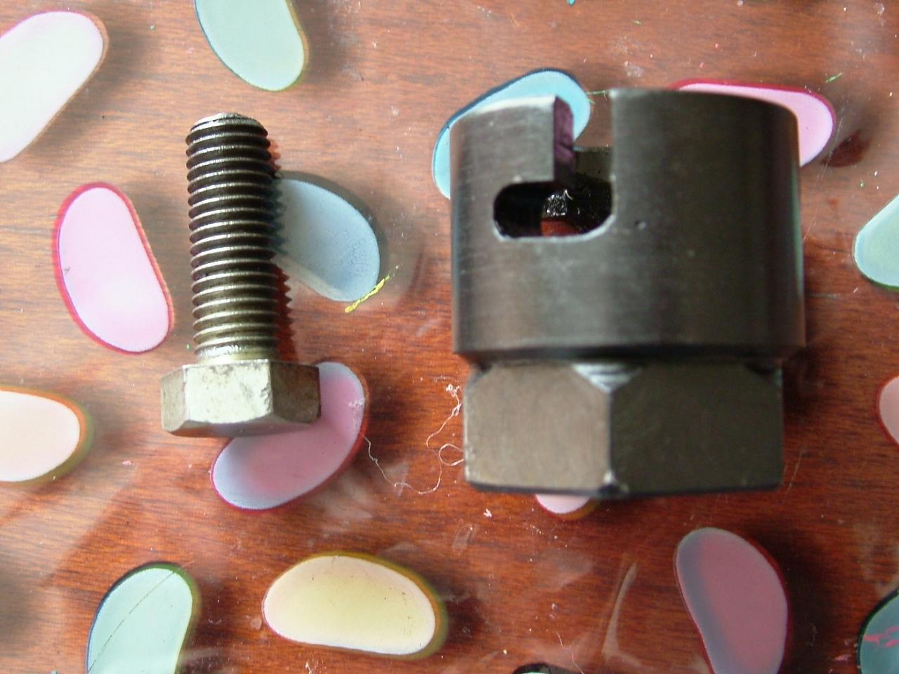

 Not being happy with jarring loose the assortment of lock bolts on the morse taper tooling on my mill.
 A better system was required so got down to making a puller to force them free and abandon the hammer in favour of a gentler and kinder on man and machine system.
 Hope the photo's explain better.
