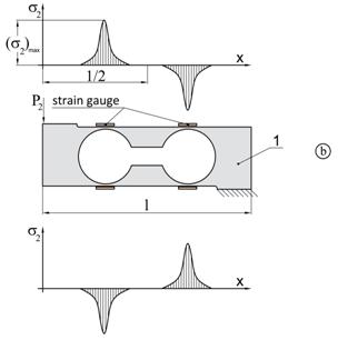

I'm familiar only commercial four wire / full bridge type (and some inductive ones that strain changes permeability of the iron) but there seems ton be "rosettes" I.E. multiple strain gages on one strip. I'm having difficulties visualising shape of the cavities and beam to measure this.
This type I'm familiar with:
http://www.weighing-systems.com/TechnologyCentre/BalancesZVZ/rekstroo.gif
or
http://www.mensor.pl/indukcyjnosciowa_metoda_pomiaru_masy/new_inductive_method_for_measure_of_mass_clip_image030.jpg
I even know that torque of a shaft is easy to measure using straingages in diagonal...but static force measurement I know allways have to have "spring" stiff in one direction to minimise unwanted signal and flexible enough on measurement direction.
I really can't figure out any other "universal" direction measurement than displacement, pressure sensor could have a straingages and "fluid" could be more like teflon plug or high viscose liquid more like dried out silicon....but then don't know the use of these mysterious "pads" other than protecting the surface of the transducer.
