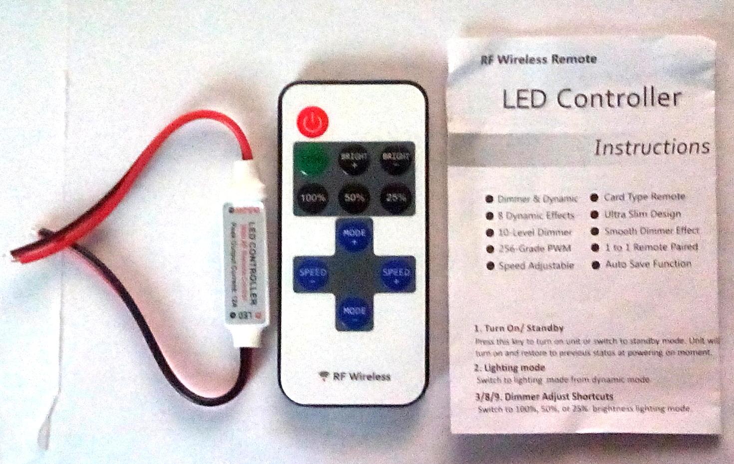

The first and most frivolous part of the lighting parts has arrived - A wireless on/off remote dimmer - for the princely sum of £1.69 delivered. Its rated at 12A so I can control two strips together. Will likely buy more remotes and control them with just one controller. Operates at 433.92 MHz.
Best Regards

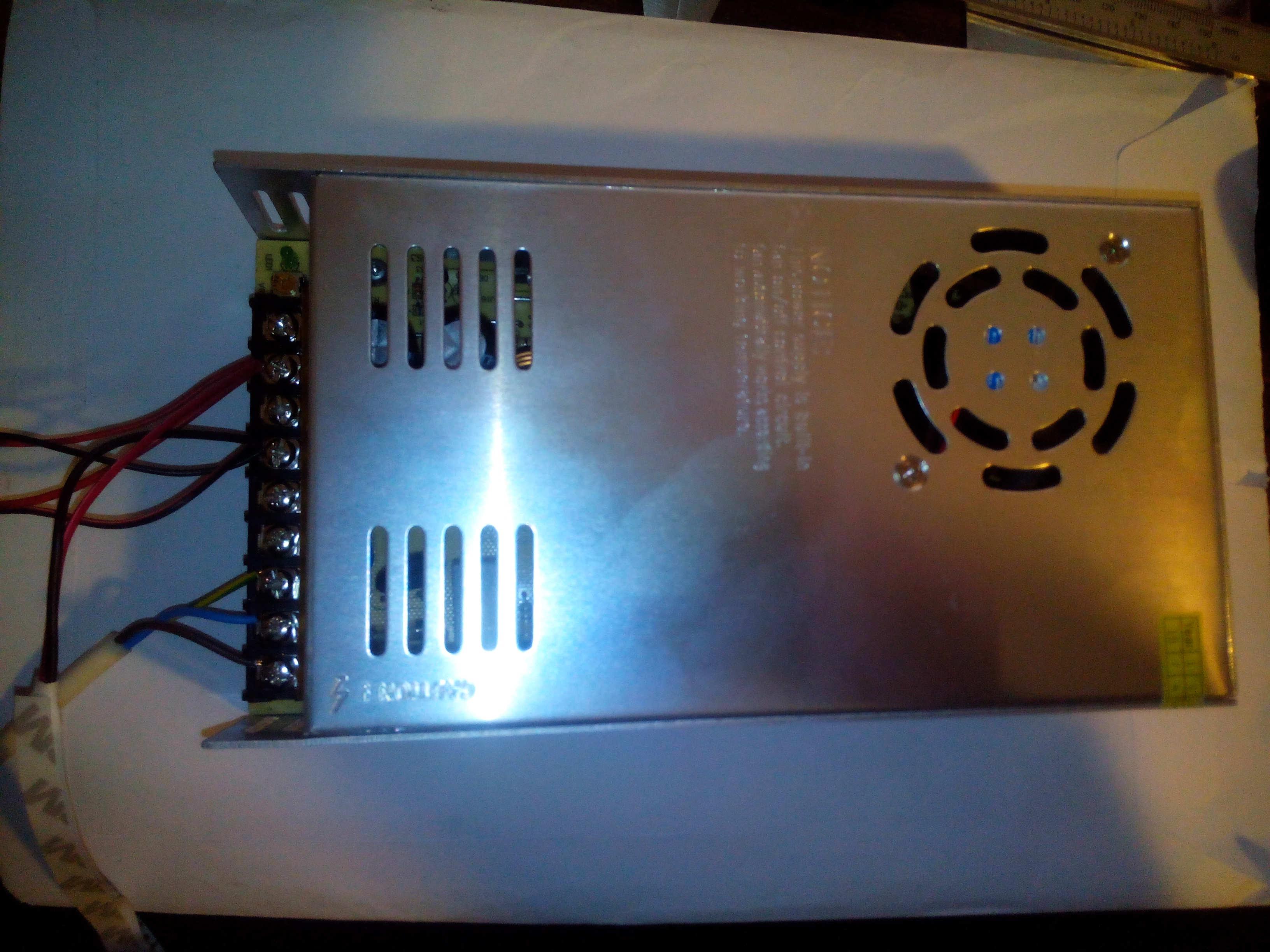

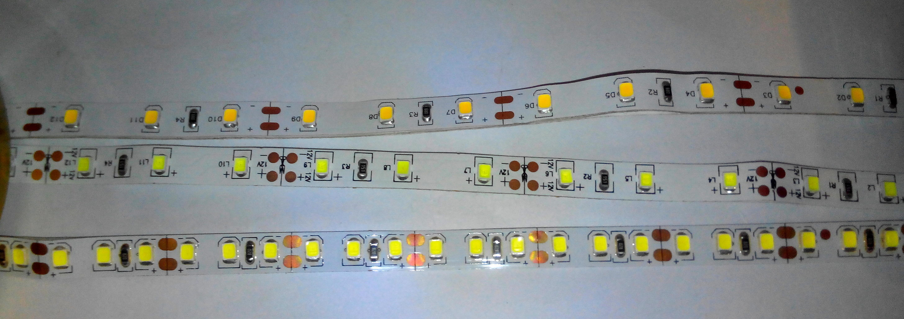

Power supply (12V 30A @£17-50) and three 5M LED strips, 300 led warm white (£3-80), 300 led cool white (£3-80) and 600 led cool white (£6-50). The strips can easily be shortened or joined with moderate soldering skills. Each segment consists of three leds in series with a current limiting resister. The warm white ones are quite unsuitable, taking almost as much current as the 600 led strip.  The 600 led cool white strip takes 2A at 12 V and seems very usable. It almost puts out the same light for a given length as an 80W fluorescent tube. The 300 cool white strip is 1A and half the light output.  I will try to get a better comparison after we have moved on the 20th May.

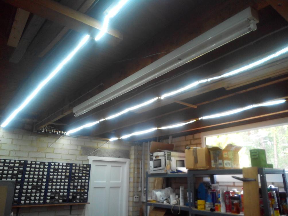

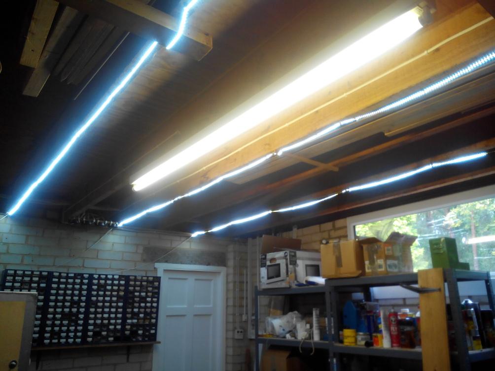

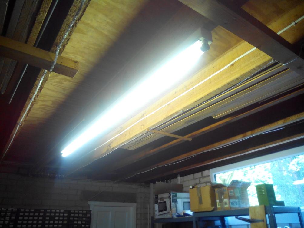

I have just started to put up the LED strips with difficult results. I was hoping to give a direct comparison or equivalent to a fluorescent tube but the colour temperature  and light distribution of the two light types makes it almost impossible. The tube light is reddish in comparison to the Cool white Leds's. The LED lights are far better distributed giving more even lighting over a wider area. Both lights enable you to see quite well but I can't help feeling that the best light would be a mixture of the two. In total I will have 6  x 5M LED strips, which uses a measured ~7A at 12V. Will post pictures but I don't think they will be very illuminating  :lol:
Would I recommend them ?  Thats a tough call. For some things its a massive improvement, especially the more even lighting. It also makes it seem like day even though its evening. However, I get the feeling that its not quite right. Differentiation of colours at the low end of the spectrum is poorer, though reading instruments and gauges is much easier. Likewise seeing imperfections in surface finishes.  Time will tell I suppose .. .
