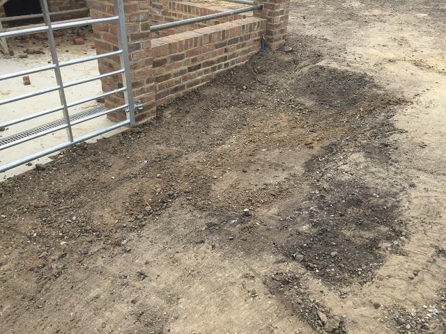

Due to the rising ground I had to scoop out an undesirably large amount to allow the gate to fully open. In the long run I need to re-sculpt the trackway as at the moment it has lumps and bumps in a rather uneven fashion. I should (when the bigger digger arrives) be able to take it all down 10" and put 6" of planing back as a surface - currently the underlying clay is poking through in places  :bugeye:

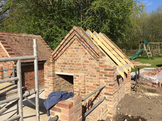

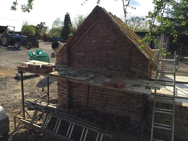

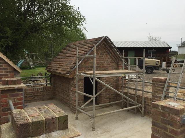

So Brian turned up bright and early this morning and by 5 pm had FINISHED the gable ends  :clap:
During the day I mended the track expanding / contracting lever on the little Kubota - just a bit of welding - it had broken off maybe 5 years ago and had been sitting at the back of my bench all that time - as I never needed to squeeze it though narrow door ways I never had got round to mending it  :bang:
Slight complications during the day -  at long last after a 10 day pause, one of the three Ewes that hadn't produced but that are expecting went  into labour at 14:30. It was important that we were on the ball with this birth (she was expecting twins) as one of the previously born lambs had been 'stealing' milk off her. Now the first milk out is 'colostrum' which it's vital the new born gets as the first feed to line it's stomach and give it all sorts of protection that it would otherwise lack. First twin was born at 17:15 and the second at 18:30, so a fair amount of hanging about ready to pounce with a bottle of commercial colostrum.

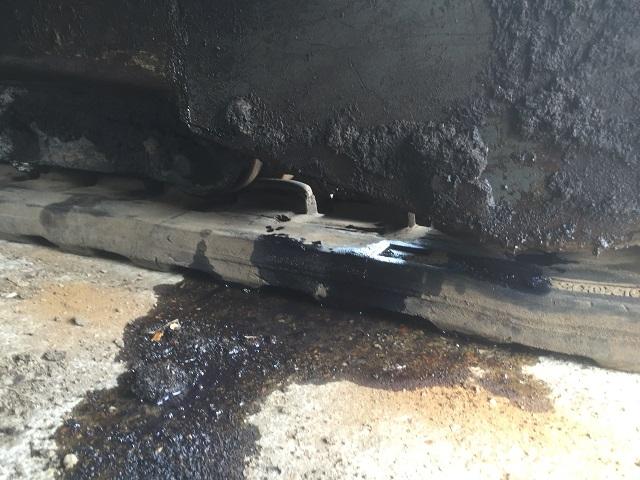

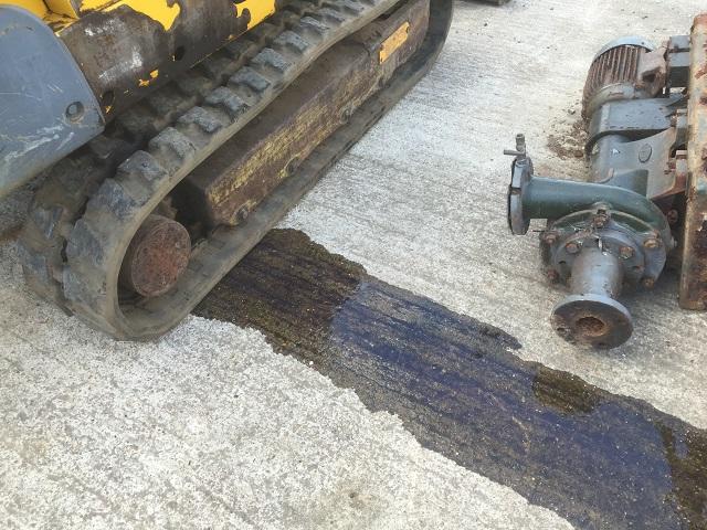

With all the hanging about I thought I'd move the new digger up onto the concrete slab outside my workshop so I could attend to a few minor issues - no problem up the ramp she goes, and I park her up. Then I get called to attend to other things. When I come back there is a massive oil slick spreading from the machine and apparently emanating from the right hand track motor or it's pipework  :bugeye:
Quick call to the seller, who was not dismissive, but not entirely committed to taking responsibility. Then it occurred to me - I'd paid a 50%  deposit, balance due on delivery, and I made an online payment to him for this - but the bank delayed the payment until Friday for 'security checks' so the money hadn't yet left my account.
OK not something I like to do, but a quick call to the bank stopped the payment going out, and I'm sure our next conversation will entail far more co-operation on his behalf  :ddb:
He wants me to start stripping out the undercarriage round the track motor to inspect - normally not an issue, but currently I have a roof to batten and tile by Saturday, and also be able to drop  things in a hurry when any more sheep issue arise. I'll not welch on the deal long term, but he will pick up the ticket for this repair  :clap:

Bad luck with the digger andrew, hope you get it fixed ok, Last time I saw one doing that it was a newish JCB 3C with an oil slick running all down a driveway. I asked the guy if he had burst a hose, "no such luck" he replied, some thieving toe rags had been on the site over the weekend and stripped off and nicked the Hydraulic pump!
Good Luck with it.

I'm sure you'll have it figured out and fixed Andrew,and glad you stopped payment until you're sure of the problem.

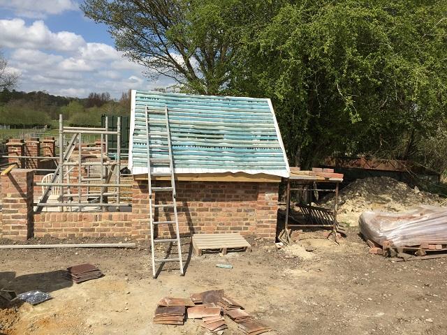

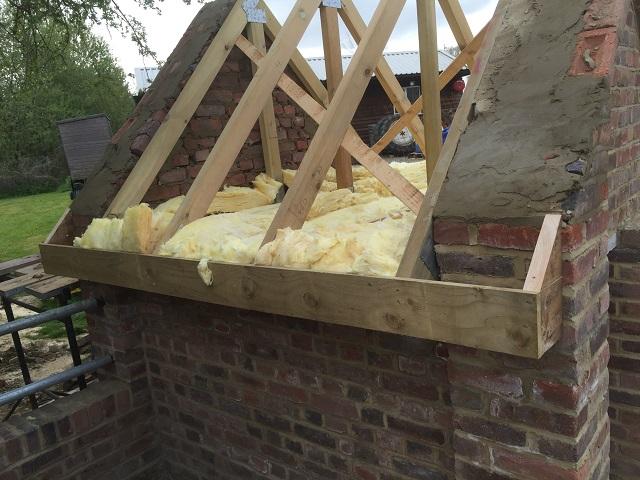

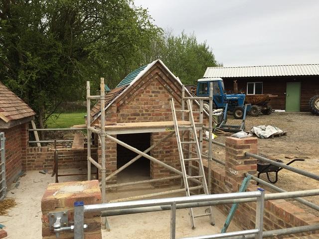

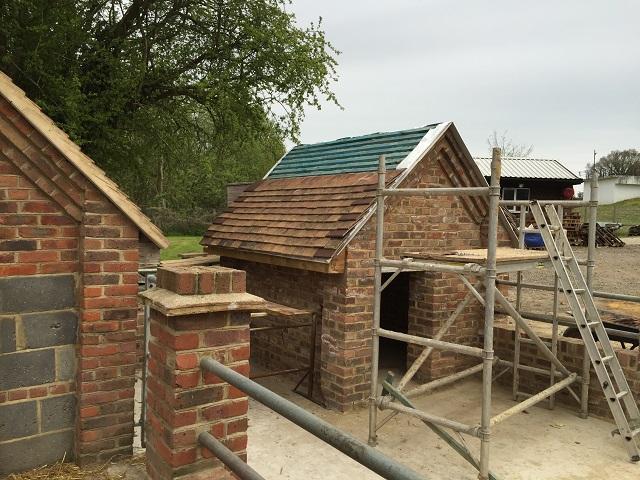

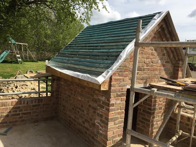

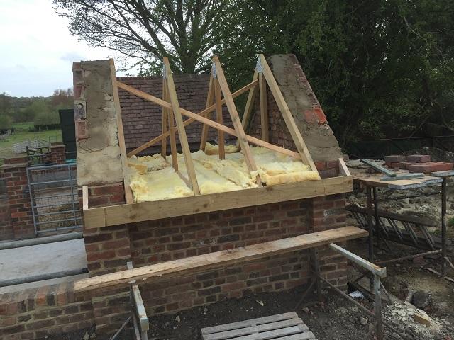

Well today with the gables finished I could crack on with the roof. First put in the rockwool insulation, then experienced the joy of fitting the breathable membrane single handed in a light breeze  :bugeye: then battened both faces and started tiling.
That's about half the tiles fitted, and I've crawled home to swallow the whole Ibuprofen packet so hopefully my body can bend again  :bugeye:

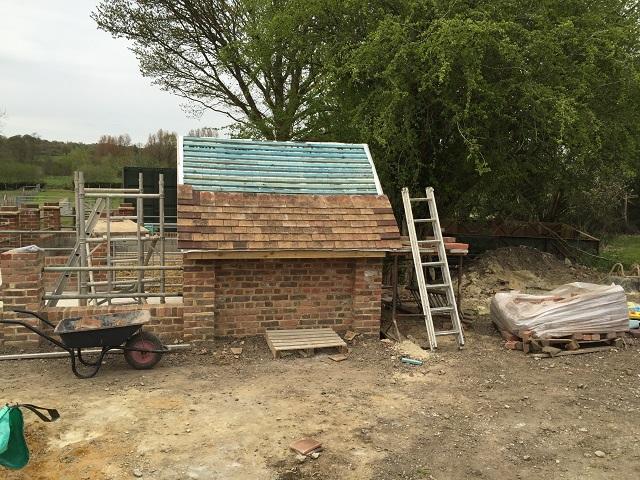

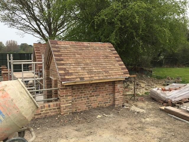

Well Pete 'where is Brian?' is actually a very good question - he was supposed to be here at lunchtime to do the pillar tops and roof ridge and verges, but there's no sign of him  :bang:
I made an early start to finish off the tiling ready for him, and as I got to the last few rows realised I was going to be one "tile & a half" short - I have literally hundreds of the plain tiles but must have miscounted those. Fortunately my local supplier was open on a Saturday morning, so I made a quick dash off site to collect. These are the slightly darker coloured alternate tiles at the verges, and are obviously made to metric standards, as the recycled plain tiles hang 1/4" lower on the battens.
So assuming Brian eventually re-surfaces and finishes his part of the job, all I have to do apart from a major tidy up is plumb in the water trough and an outside bibcock.
